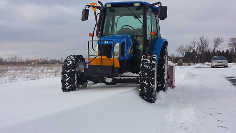

What kind of speed are you seeing? 20" of snow is not going let a 37 hp tractor (pto) go very fast, fast being a relative term. I run a NH TL100A Deluxe, with 93 pto hp, with a Normand 92-280 Inverted blower. Max speed i am seeing, in 4" is a bit over 7mph, with out spilling any snow. 20" and I'm down to about 3mph. But I'm throwing so much snow, with such velocity, that i need to be careful where I'm throwing it. I usually see between 475 and 570 rpm on the pto.
