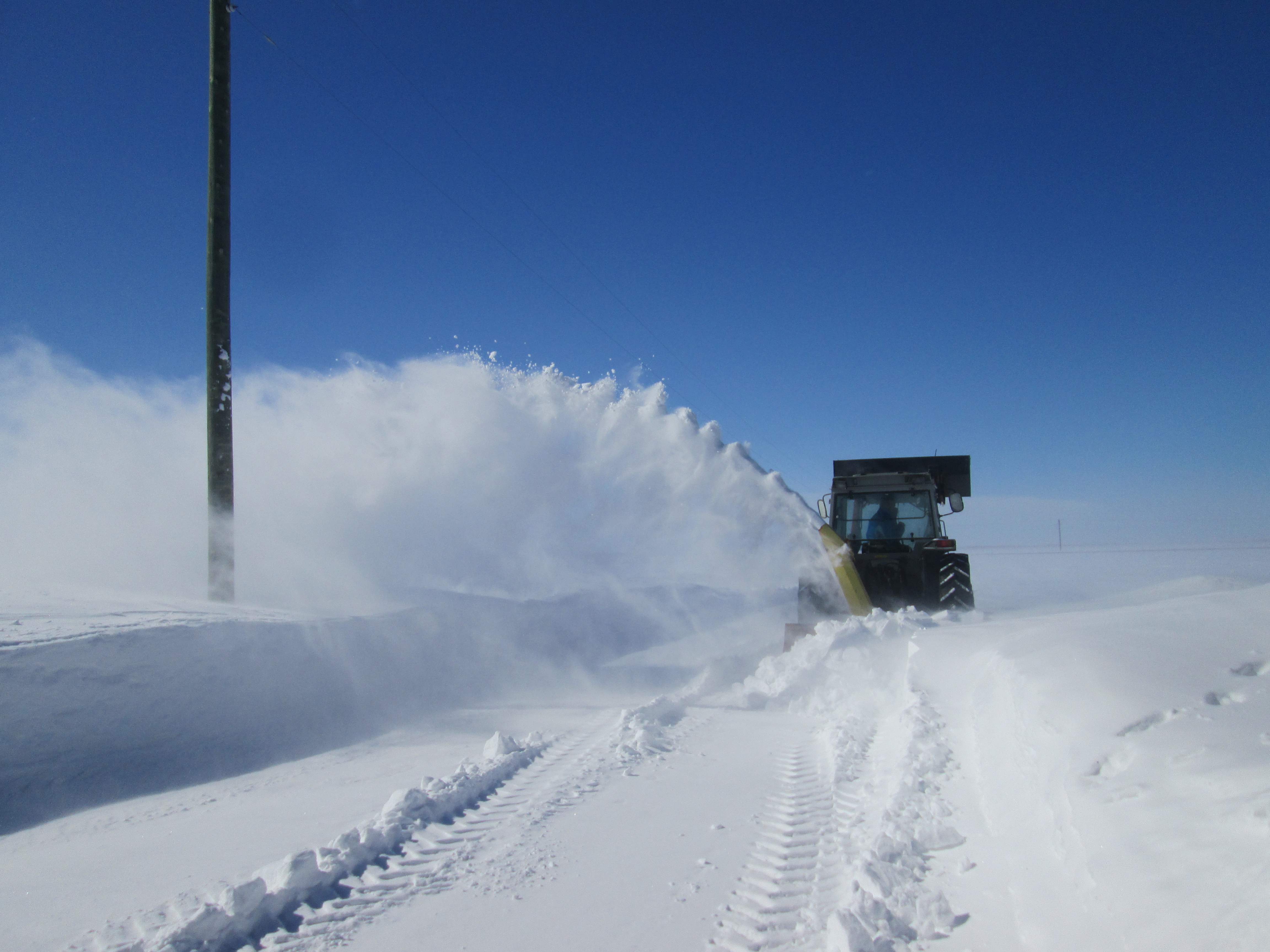

85hp on 84inch really wouldn't want any less

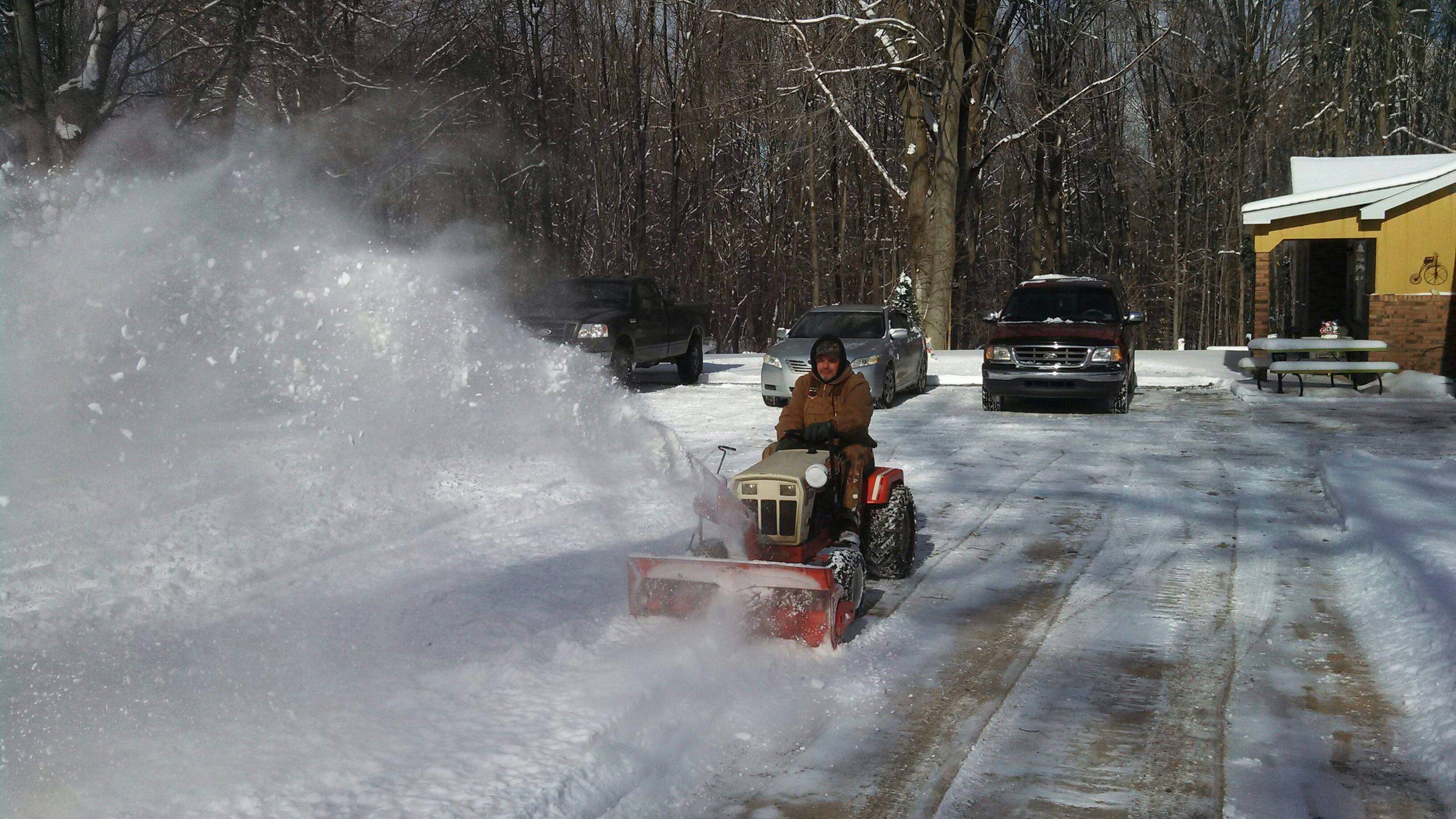

I am not saying they do not work. Just the snowblowers I have used always seemed underpowered. Maybe they are too much for garden tractors.
The old garden tractors worked well with 48" blowers . Here's my old 16hp simplicity hydro last year
   / Snowblowers vs PTO HP #33
Koja, the hydro and 16hp would help. My old Simplicitys are only 10hp and gear driven.
