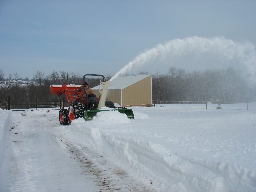

Now is the perfect time to shop for a snowblower. If you wait until near when you will need it, none will be available. There is little doubt that a snowblower is the preferred way to handle a lot of snow that stays a long time - the type we get on the south shore of Lake Superior. If you get a lot of snow you will also want a front facing blower to avoid the pain and visibilty issues associated with a rear facing blower. A heated cab is a must for me since I may have to snowblow 20 to 30 times a year.
You weren't too specific as to where you lived, but the less snow the less serious equipment that is needed. If your snow comes and goes several times a year, I would consider a plow - fast but problematic where the snow just keeps piling up. A rear blower would be OK if you only had to do it a few times a year.
Here is my rig below and a link to a popular video of I made of mine in action tackling more than a foot of snow:
YouTube - Kubota B3030 snowblower
