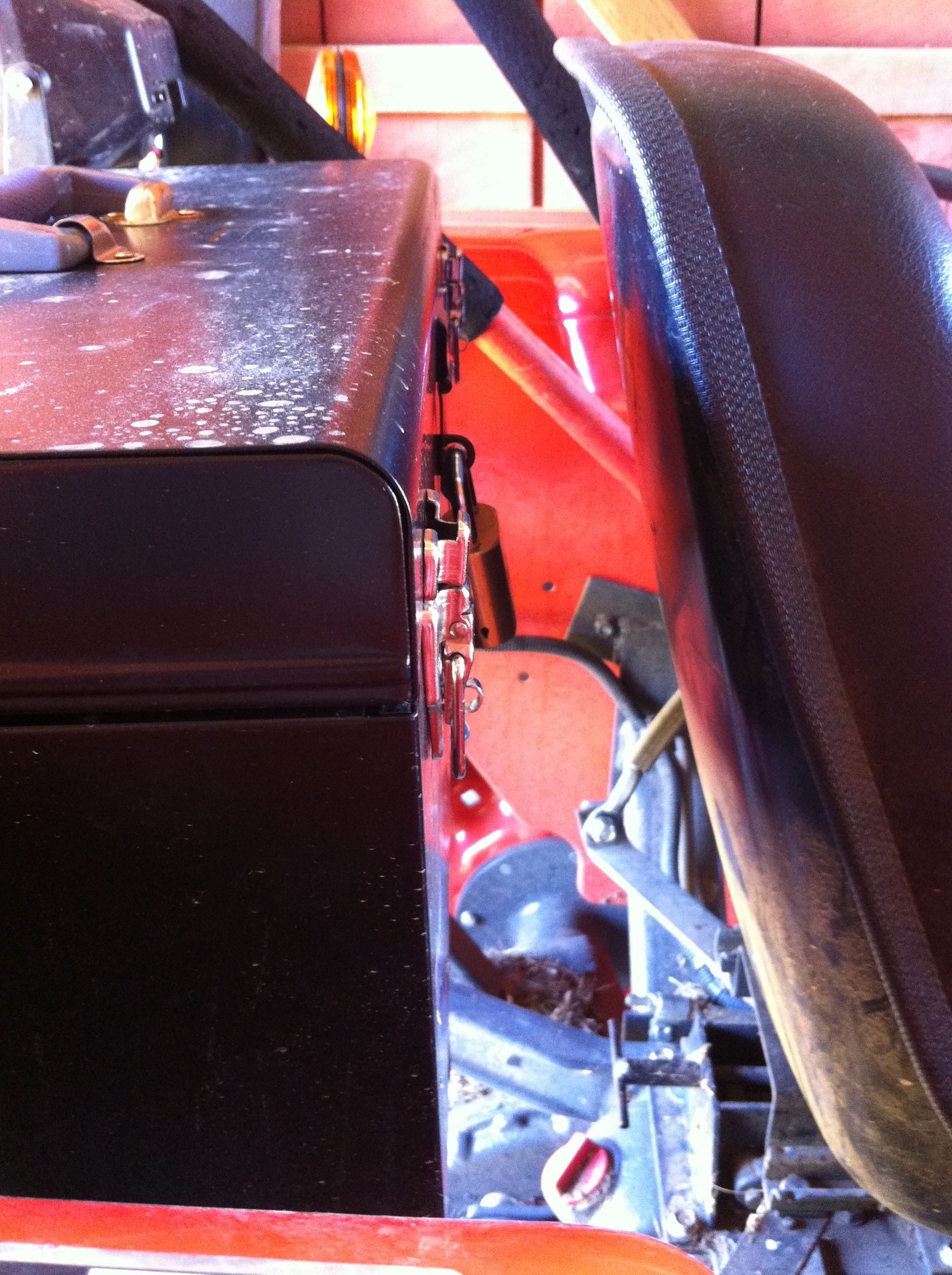

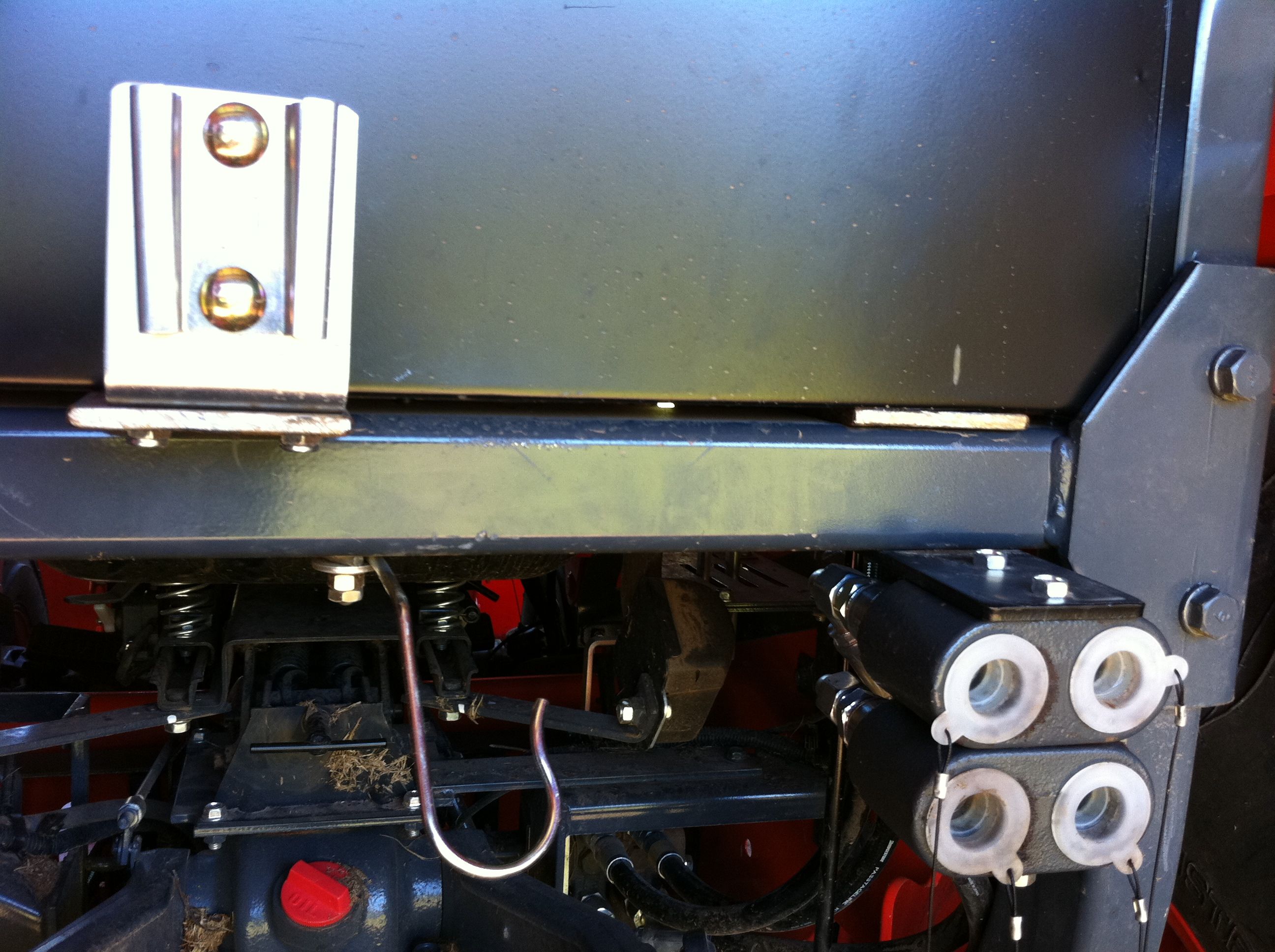

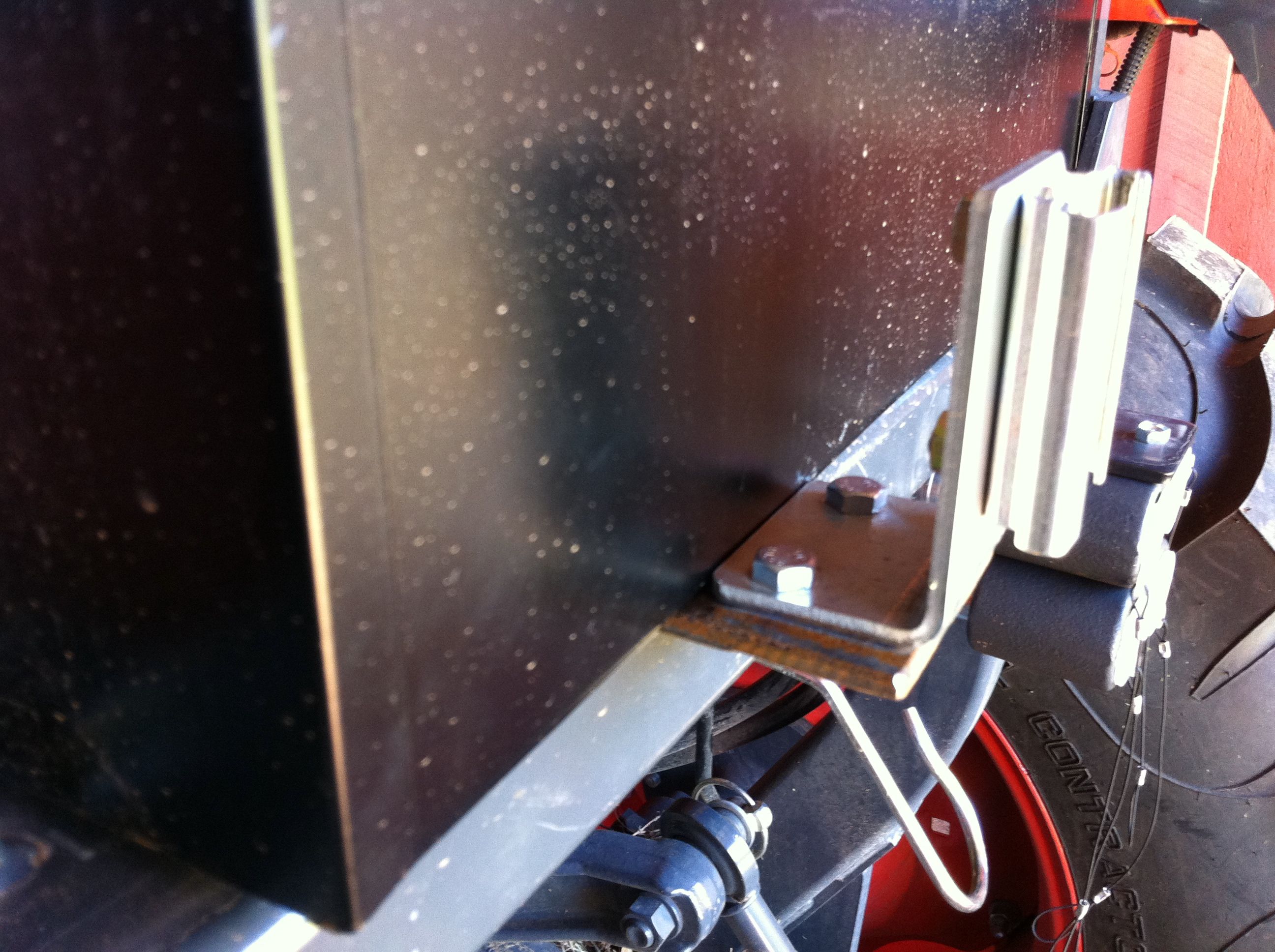

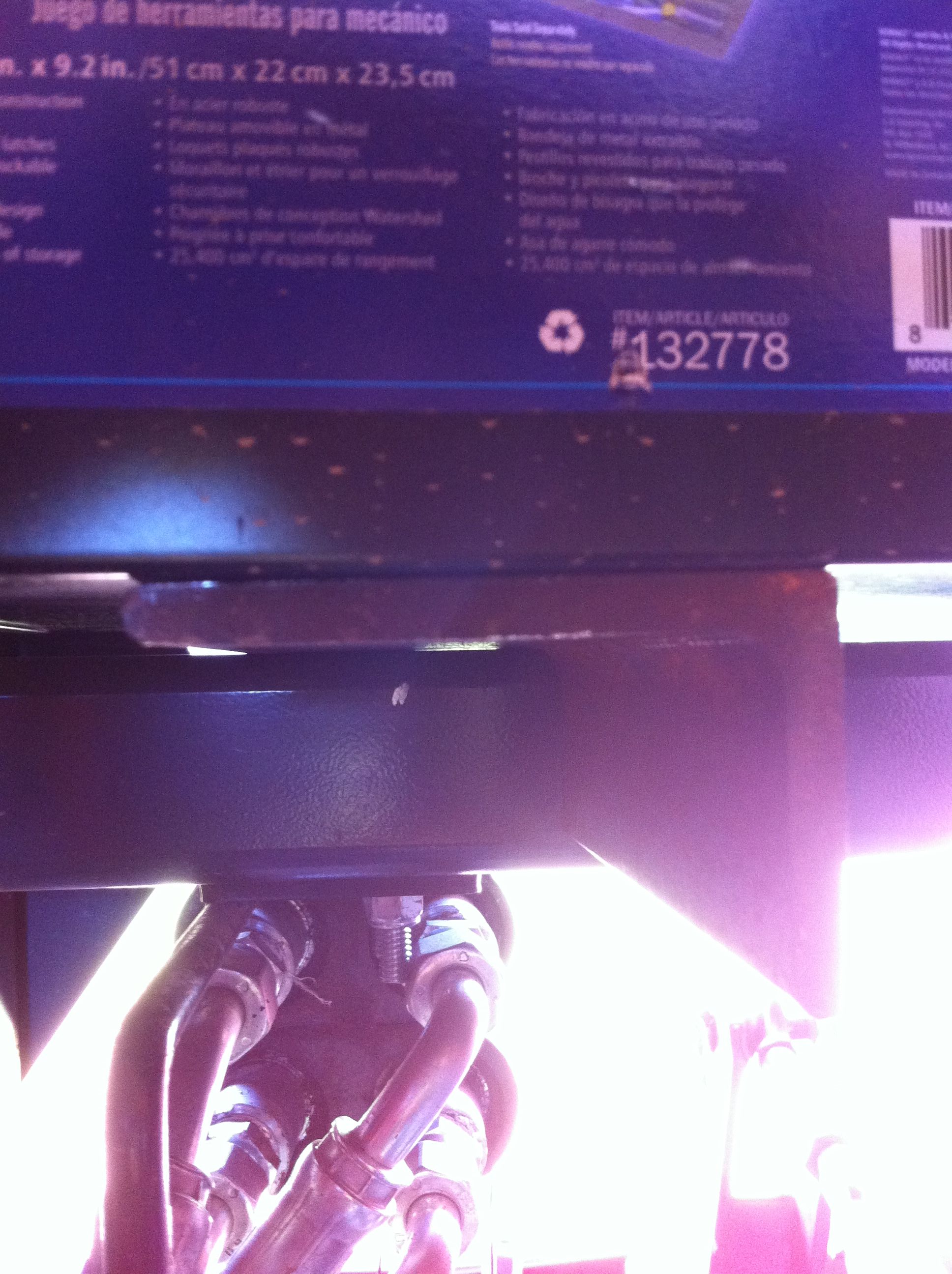

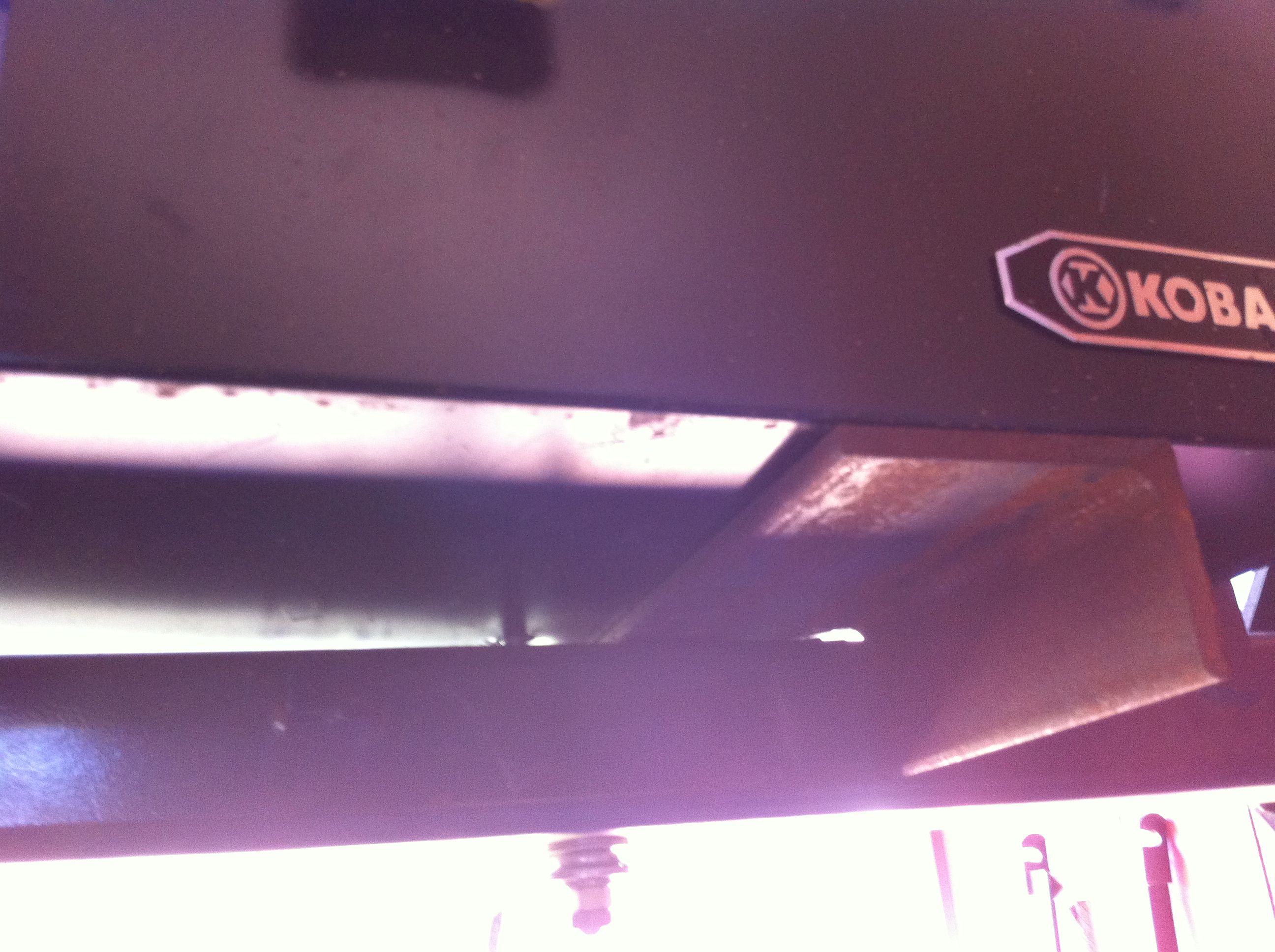

Here is what I did with a Lowe's tool box on my MX5100 HST. I removed one of the existing mounts for the old tool box. Moved the worklight over on its mount by drilling a new hole in it's existing bracket. Then I made two brackets out of angle iron for the new tool box. I mounted one bracket using the existing attachment for the rear hydraulic ports after getting longer screws. I got longer screws for the SMV sign mounting bracket and used those screws to mount the other bracket. All screws go through a plate in bottom of tool box, then through the tool box, then through the bracket and into the cross bar. So no new holes in cross bar were required. The bracket that is attached where the SMV mount was is longer and extends back beyond the tool box to provide a place to remount the SMV bracket. It is just long enough that it allows the tool box lid to open without hitting the sign but not so long as to block the access of using the top link storage hook. Only compromise I had to make was to slant the tool box slightly so the PTO lever would operate. I could not slide the whole tool box over because of the rear work light bracket but I didn't need much and it only extends on the far side about 1/2" past the cross bar. So now I have room for toilet paper and something to read :) and lots of tools. I also discovered two holes on the left fender behind the cruise control that will allow me to mount the old tool box there and the lid will still work because of the way it is made. Haven't mounted that yet but I plan to. That will make pins and clips more readily accessible from the ground and won't have to plow through big tool box looking for small stuff I could keep in original tool box. With this big of a tool box the seat will touch the box if it is way back but I don't use the seat that far back so it works for me.
