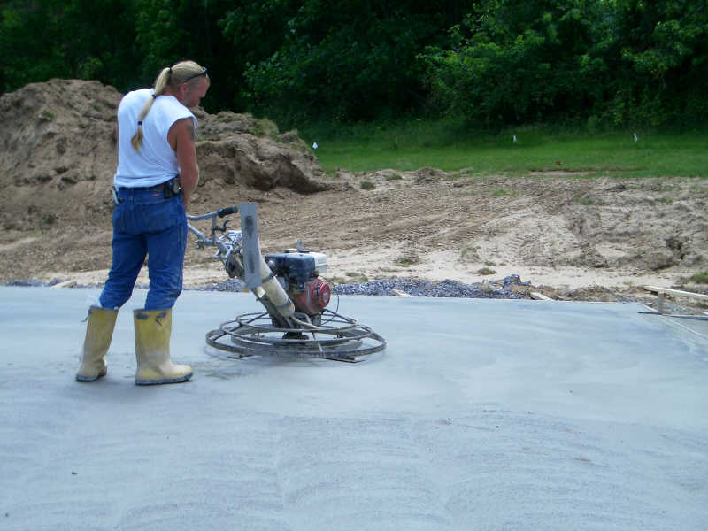

#111

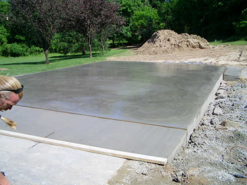

After going over the entire slab about 4 times with the first power float, they changed out to the power finishing float. You can see the difference in finishes as he works the drying concrete with the power finishing float.

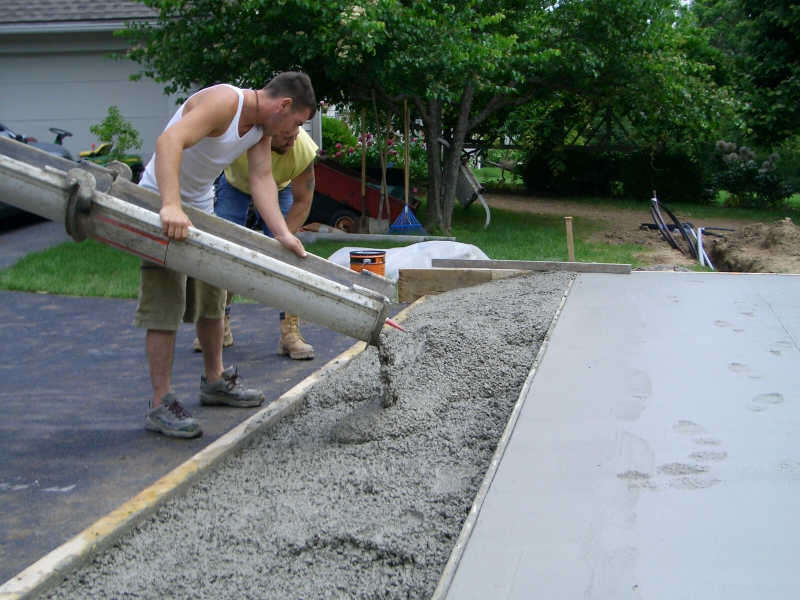

#112

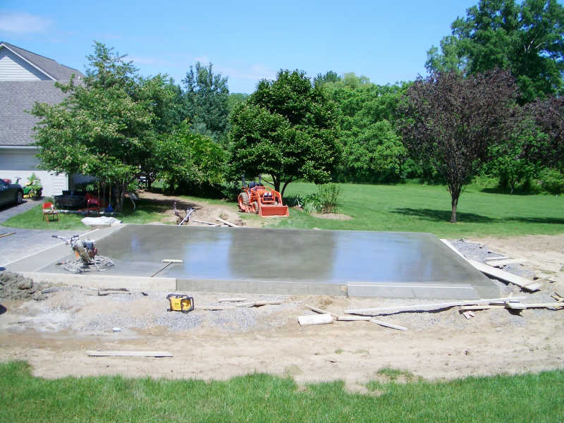

Finally, the truck shows and the front apron gets poured. Thankfully it wasn't too hot and sunny, and since we kept it moist, the concrete laid earlier hadn't set up much. Phew! And, I don't even want to know how much that screw up cost somebody, I had a fixed price!

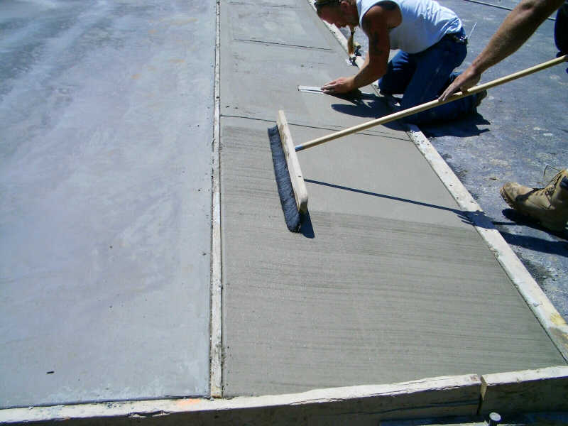

#113

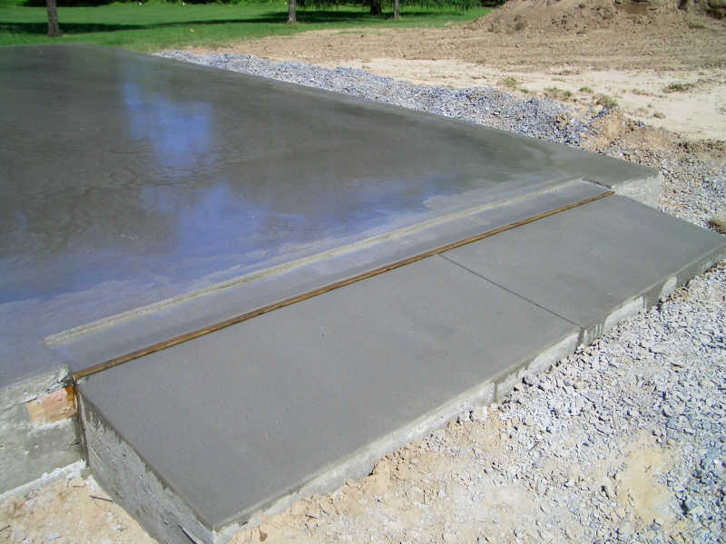

Some folks opt not to do this, but all my aprons got the 'brushed' treatment. Hitting the concrete deck hurts a lot more the older you get, so it sure seemed to make sense to me.

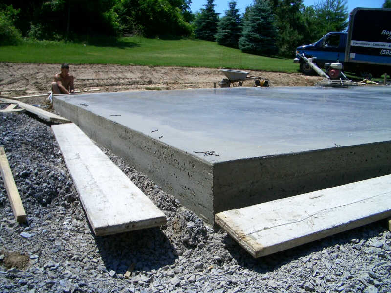

#114
After a few hours, the concrete was set up enough to begin removing the pour forms. That is one thick slab!

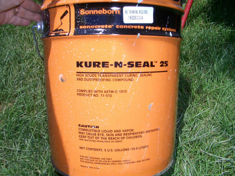

After finishing smooth, the slab was sealed with Kure-n-Seal 25 while still green. This allows the sealer to penetrate and bond with the floor.

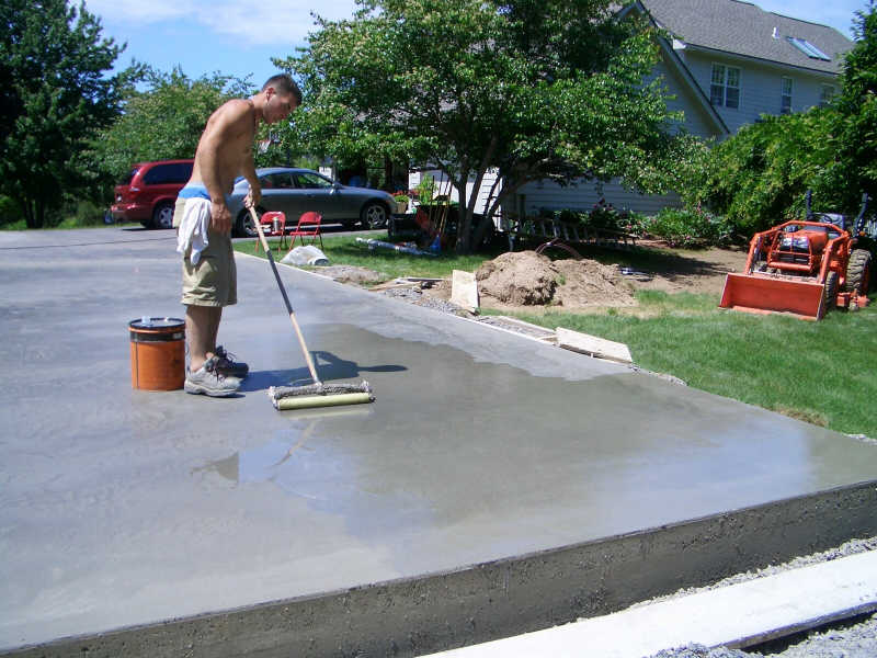

#116
The sealer is applied with a short nap lambswool roller. Boy, does it stink. I can't imagine using this product in an enclosed basement pour for example. Talk about a buzz...

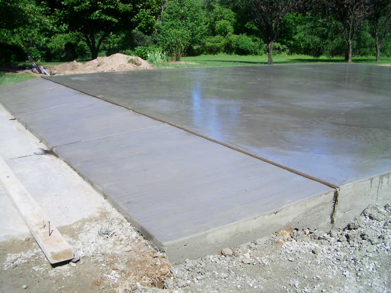

#117
How's that for a nice floor, eh? These guys really knew what they were doing and I would have absolutely no hesitation giving them referrals. I am very pleased with the results.
