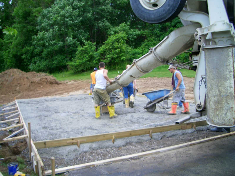

#101
Here's what one 7 yard load looks like on the ground. They could have brought in more per truck, but kept it to only 7 yards per load to prevent possible damage to the 600' driveway.

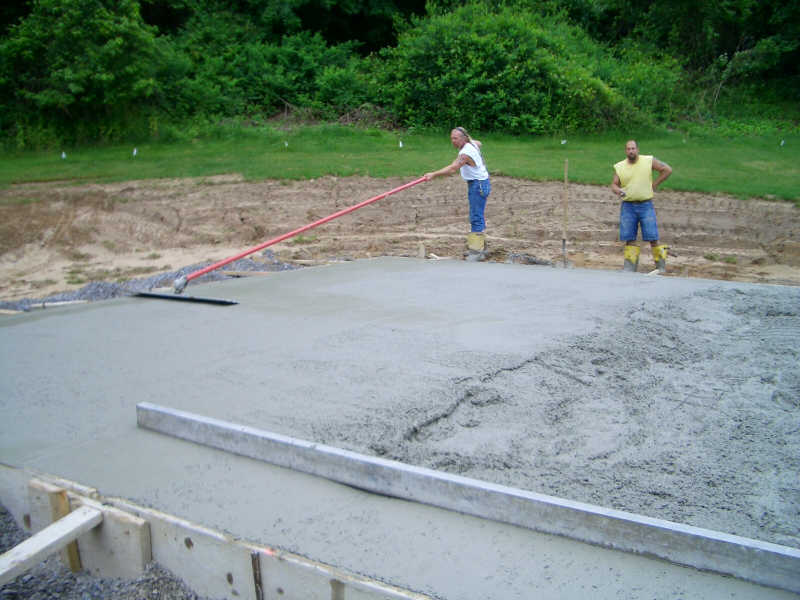

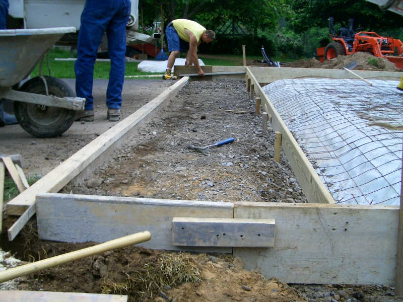

#102
When the second truck pulled away they started the screed process using a long piece of aluminum box channel.

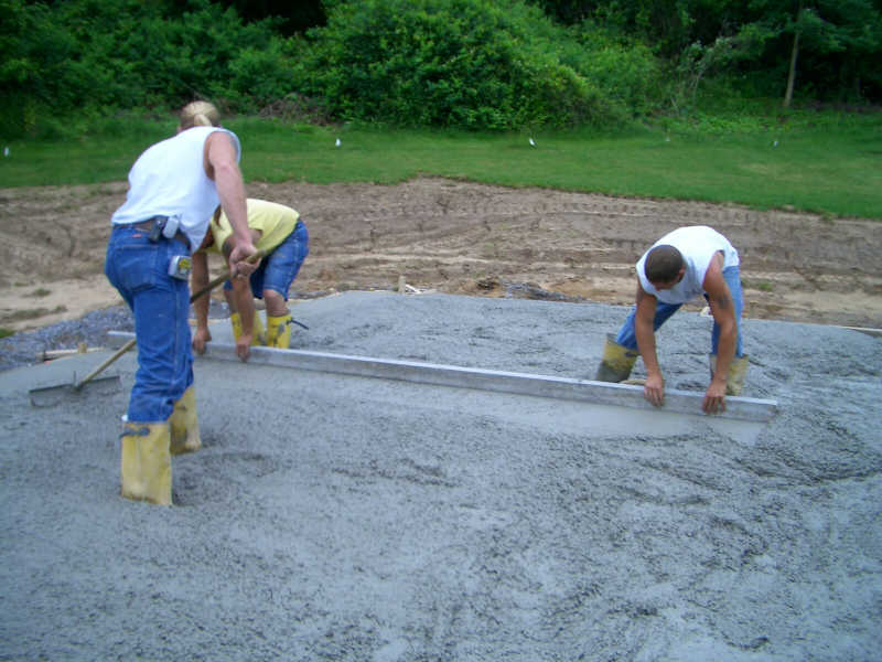

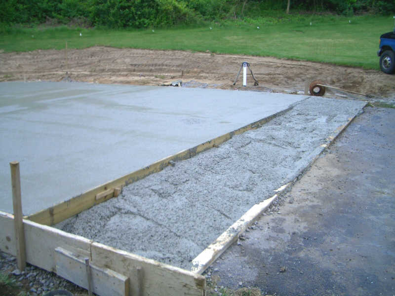

#103
They worked very well as a team and moved along a lot faster than I expected. They were careful to check for the rebar height reference mentioned earlier. Total pitch from back to front of slab is 1-1/2".

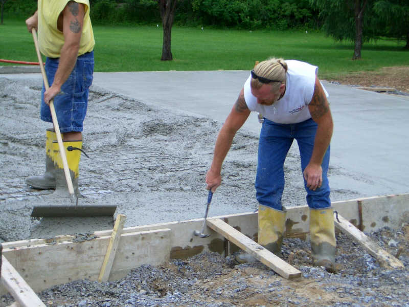

#105
Working around the thickened footer edge they constantly banged the forms with hammers, etc., to settle the concrete and get a nice smooth side on the slab with minimal air voids.

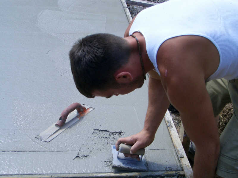

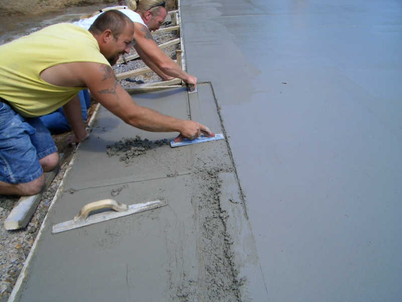

#106
Adam was the 'edge guy'. He went around and really worked the edges, putting a nice smooth ease on them.

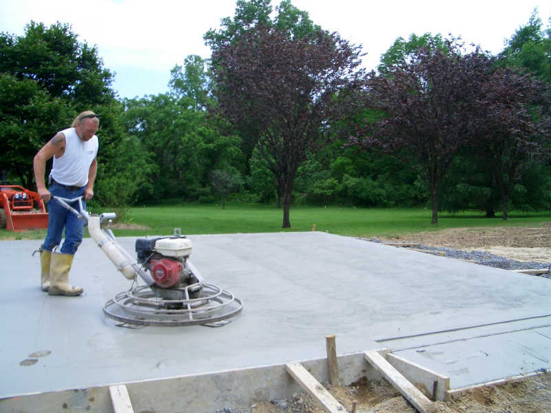

#110
While waiting for the fourth truck, they started working the power float.
