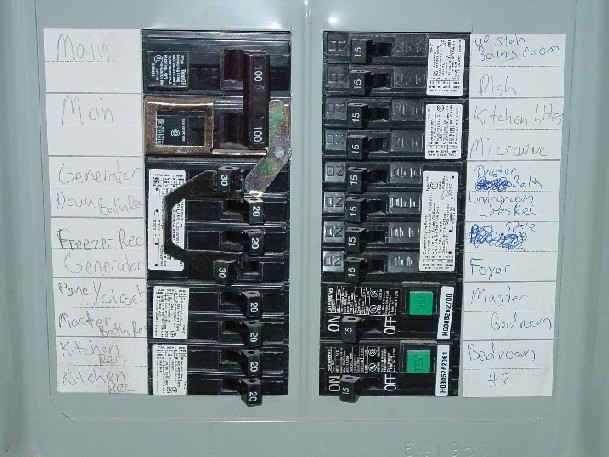

Just another follow up to the "circuit" design. I had a sub-panel put in our new house that is fed by a generator - we are in "hurricane alley" and after living without Power for a few days after hurricane Fran and a week following an ice storm I thought this was a necessity. The electrician said I had three options to prevent backfeed: $200 for a totally automated switch - very slick and hi-tech, $75 for a manual switch - looks cool and is robust or $2 for a little bracket that slides of the breaker creating an either/or for the adjacent breaker. I opted for the $2 bracket.
Picture attached. You can see it on the second breaker with the arm preventing the adjacent breaker, 3 (and subsequently 5), from being in the same position. Works very well and I saved some $$$.

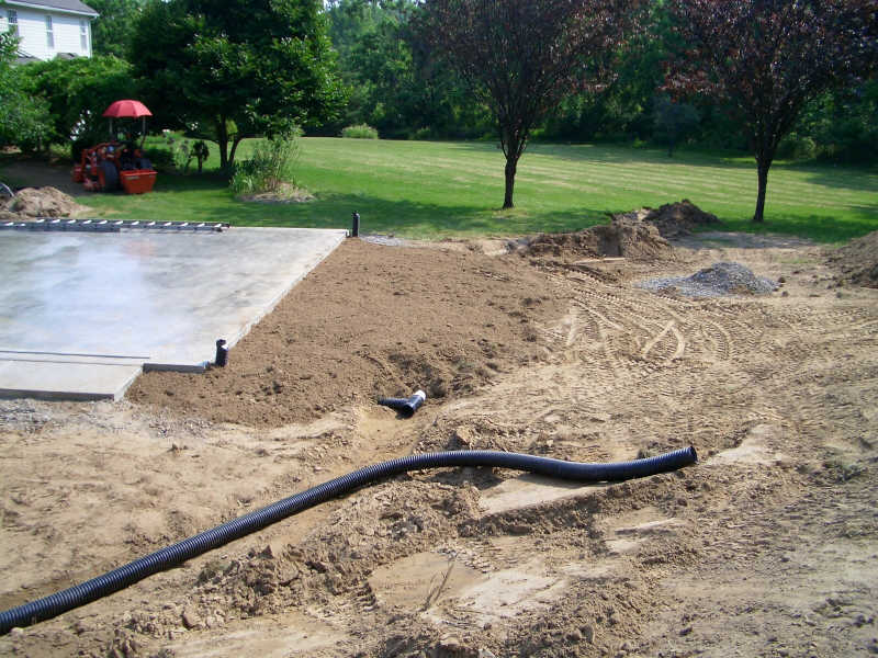

Have been making slow progress - record heat and humidity for the past week again. Now I know why you guys love your canopys. Pic: Decided to cut back the hillside a bit more before laying the drainage tile.

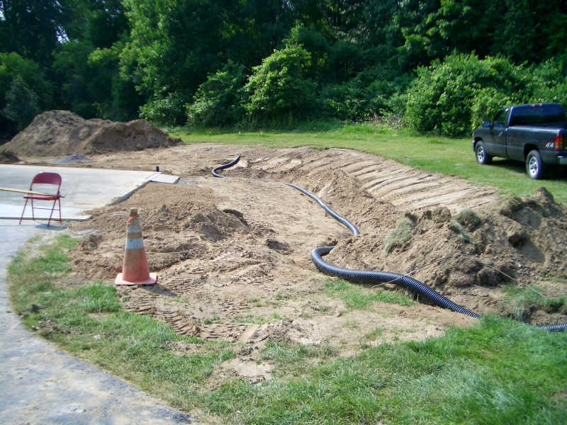

Last pic didn't show the fabric sleeve on the perforated drain pipe. That is a real PITA to slip onto a 100' length of pipe, but keeps the dirt from filling up the pipe and eliminates the need for surronding the pipe with pea gravel. Pic: the perforated drain pipe follows the hill contour behind the garage out to daylight past the plum trees. The solid gutter drain pipes '"T" right into it behind the garage.

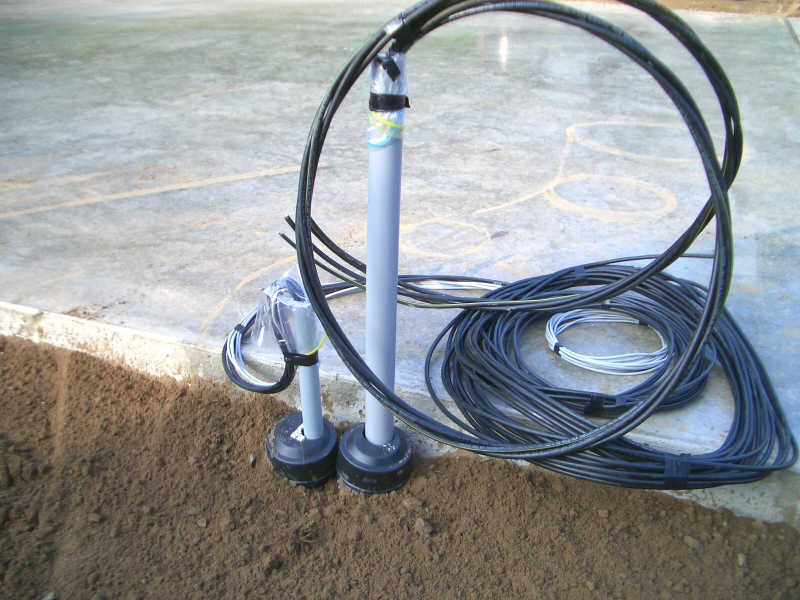

I was concerned that if the slab ever did get to moving a bit, the electric service and data conduits might pull away from the garage wall or break, or stress the wire inside. So I decided to run the last 15' of the conduits in their own 4" corrugated drain pipe. The conduit elbows fit right inside the drain line elbows and this gave about 1-1/2' of up and down movement to the conduits inside the plastic drain lines. Problem solved I hope.
