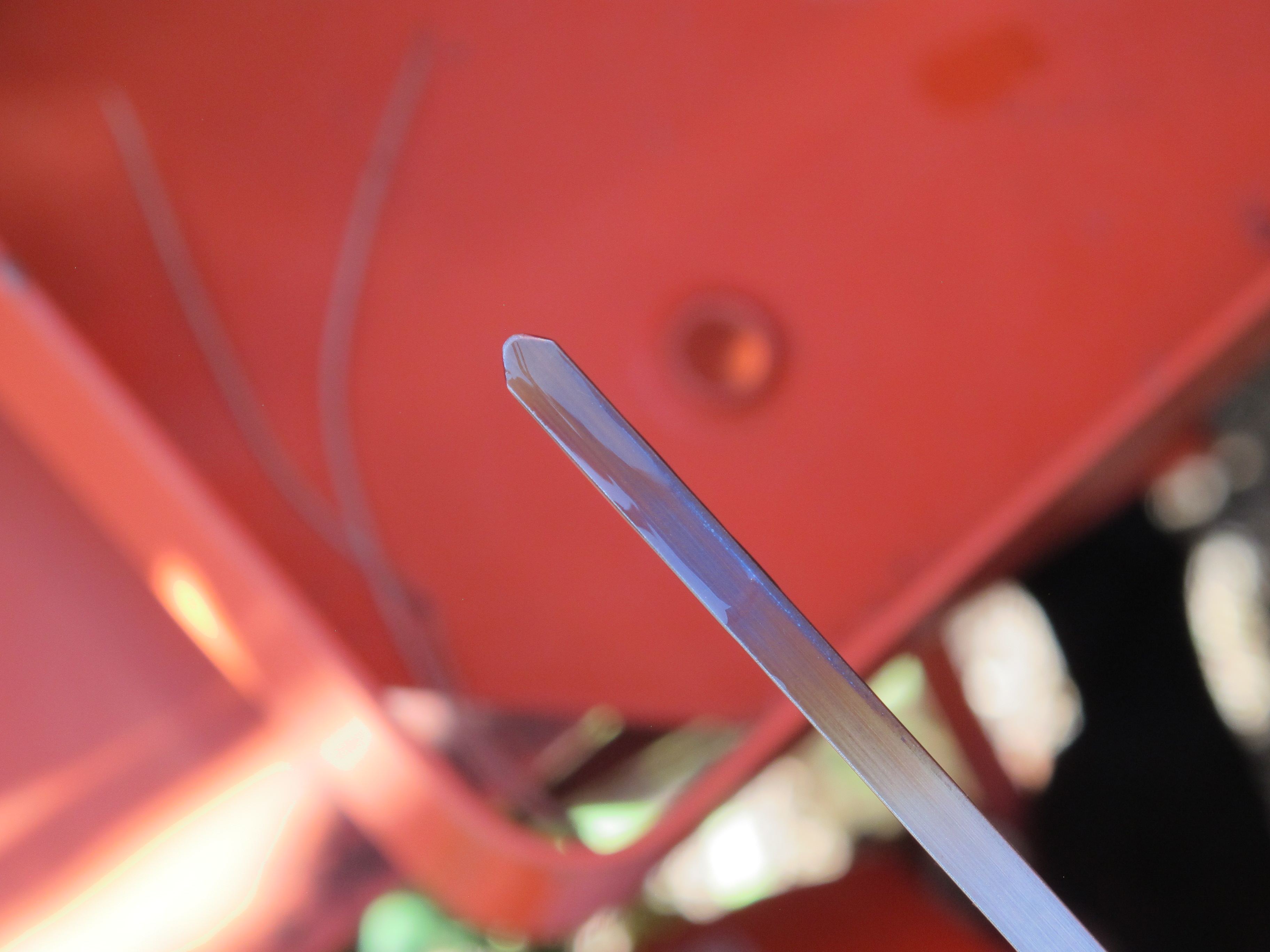

Instead of changing the brand or quality of the oil, I changed the color of the dipstick itself. Now the oil level is easier to see.

I'd like to see that? How about a picture.....

Here you go. It takes about 30 seconds, costs nothing, and has no effect on the oil.
I'm surprised that the trick isn't more popular, but I've never seen anyone else do it.

Me too. My transmission funds are almost so dang clear I wonder if white would even be enough contrast.

Clever!
