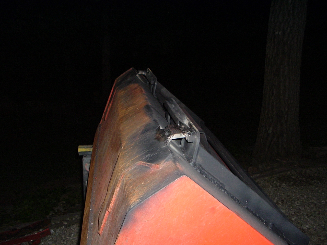

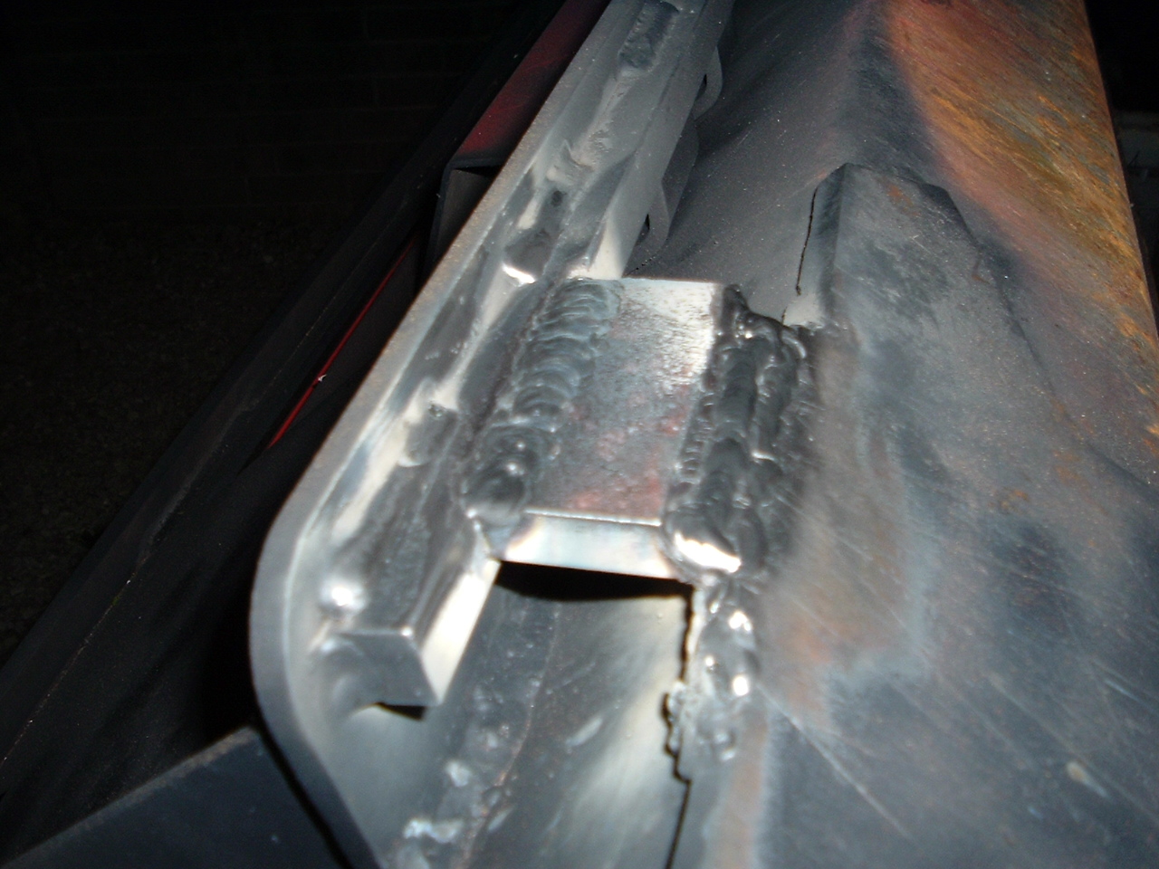

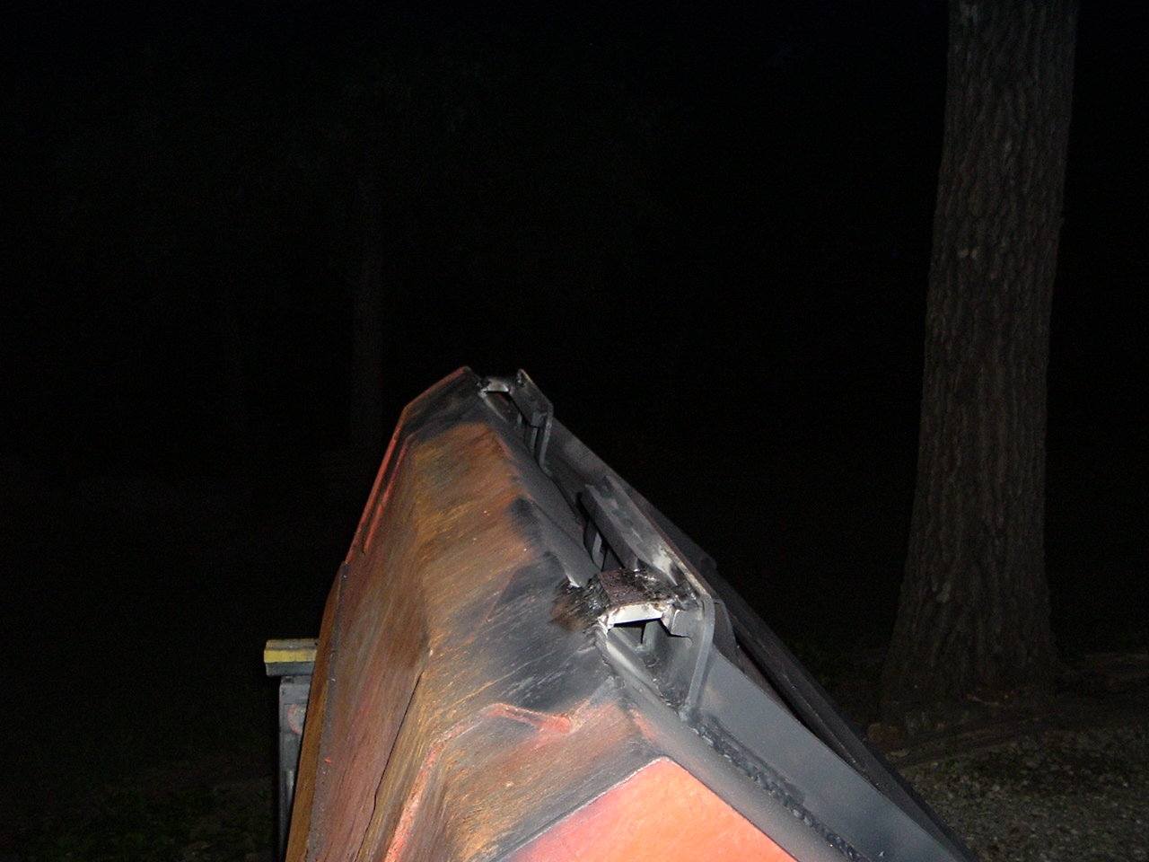

Got a late start today on reinforcing the bottom of the QA adaptor, by the time I got bevels
cut on the little 3 inch pieces of 3/8 steel it was getting dark out. And by the time
I got them welded on, I could not see the welds very well by the back yard light. No excuse
for my crappy welding technique, but I think they will hold OK.
The mosquito's were chewing on me, and one went by my ear that sounded like a Pratt & Whitney
Whirlwind or something. We have had a lot rain for months, and the Mosquito's are fat and sassy!
Anyway, All that is left is the top 4 ft. by 3 inch 3/8 piece of steel and the hooks on top of
that and some orange paint and the thing will be finished! Thanks for looking.
James K0UA
James K0UA
Excuses Excuses,,,,,,,,,,,,,,If'n ya run out I have a list I can e-mail ya:laughing:
Just messin with ya...........Good job.
   / So you think converting a Pin-On to QA is Easy! #14
James:
Welding is generally fun; but grinding welds absolutely sucks.

I know what you went through! Those buckets are very well made; apparently Kubota doesn't believe in stitch welds:mad:
Dad and I did his with 5 inch grinders and cut off wheels (1/16). I think it took two of us about an hour to get the bucket cleaned off:laughing:
http://www.tractorbynet.com/forums/build-yourself/149952-tractor-side-shuttle-shift-quick.html
PITA wasn't it? it looks like you might have done a little better job cutting, and made less gouges in the bucket base metal.:thumbsup:
James K0UA
