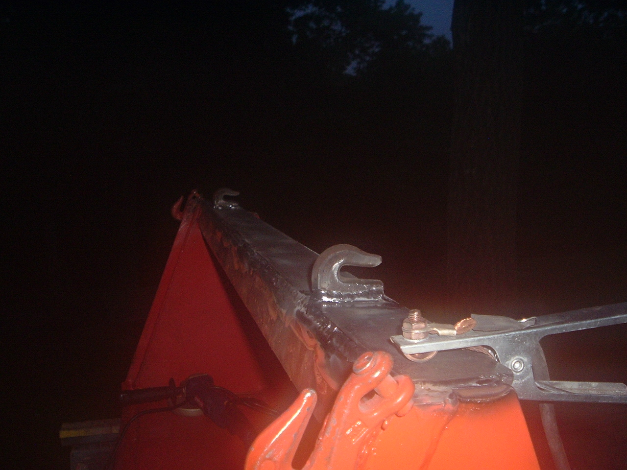

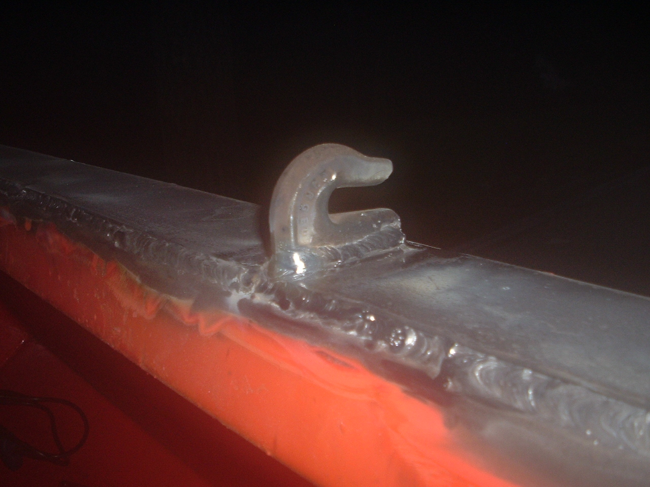

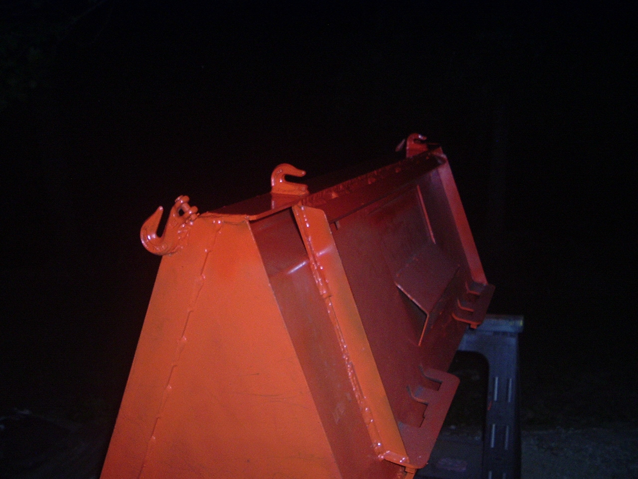

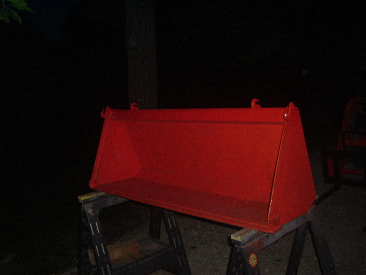

Well its finished, decided to go ahead and weld the front all the way across.
I did not like the way the front looked with the gaps in the welds.
I welded on the hooks. and painted it up. This welding in the dark is for the birds.!
Thanks everyone for all the comments. This project has been a learning experience, and fun too. The only way to get better at something is to do it!
James K0UA

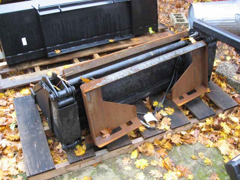

My Brother recently bought a L3240 without QA bucket. He said he didn't need that function. Well a couple weeks ago he came to me and asked if I could convert it. :)
He bought the bracket that pins to the Kubota loader. I converted the bucket building my own QA plate.
This thread supports my theory about metal working projects. The proper equipment is paramount to efficient production. I have a large Victor torch, a Miller 625 Plasma Cutter and a Miller MIG. I converted my Brother's bucket in a short afternoon building everything from flat metal. I consider myself only mediocre in my metal working skills and productivity.
I commend the poster for tackling this project with the limited equipment at his disposal. He should be proud of his skills and diligence!!! He created a QA bucket that is many times stronger than what he would have purchased. :thumbsup:
I can't agree with someone who mentioned simply welding the QA plate to the existing brackets. The last thing you need is your bucket projecting a few inches farther forward and/or messing up the dump angle and rollback feature. It's best to strip the bucket bare like the poster did and start over.
My Brother is very excited about his new QA bucket and has now started purchasing other attachments for his tractor.
