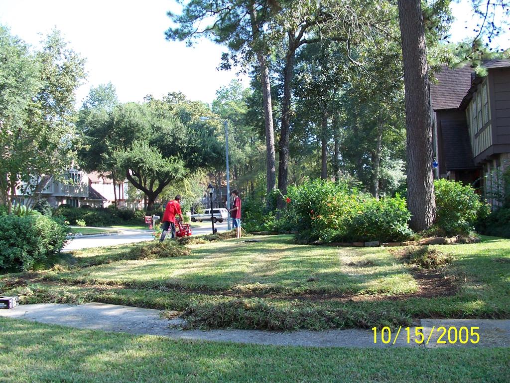

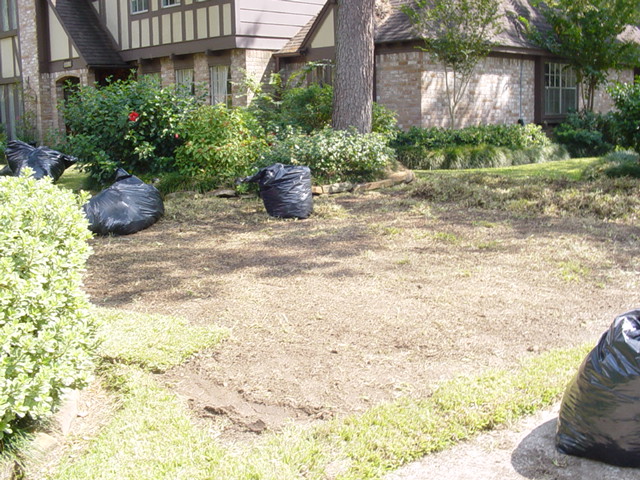

/ Sod Lifting #5
A sod cutter is one of those things that works just like it's suppose to. I rented this one at HF for $55 for 4 hours. I actually used it maybe 1 hour. It cuts about 18" wide and you can set the depth. I was replacing the grass so I wanteh to just scrape off the top. I could have set it down an inch or to and save the grass.
If created a LOT of waste in a hurry. But it is sweet. Water the grass a bit the night before, I think it helps keep the dirt on the roots.
Good Luck,
Rob
