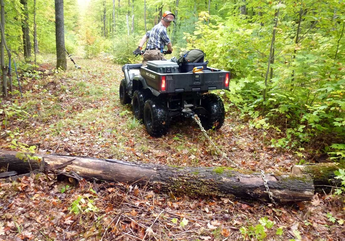

Me personally, I use poly ropes for everything. Only exception is choking and dragging logs.
