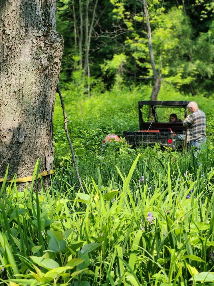

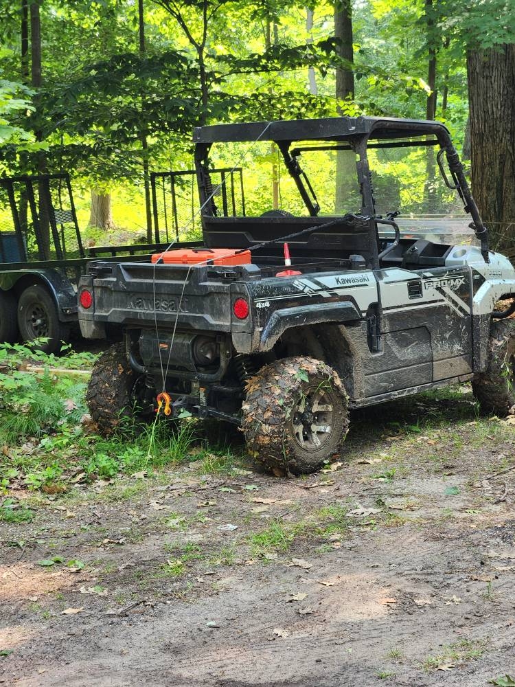

Anytime you do a recovery you have to think it through on the best way with what you got available.
When we buried our sxs, I had to pull backwards with the winch on the front. Gotta get creative even if it's not optimal.
Ran it through the clevis hitch to "lift" the rear to help on resistance. Not perfect but it got out on 1 pull.
