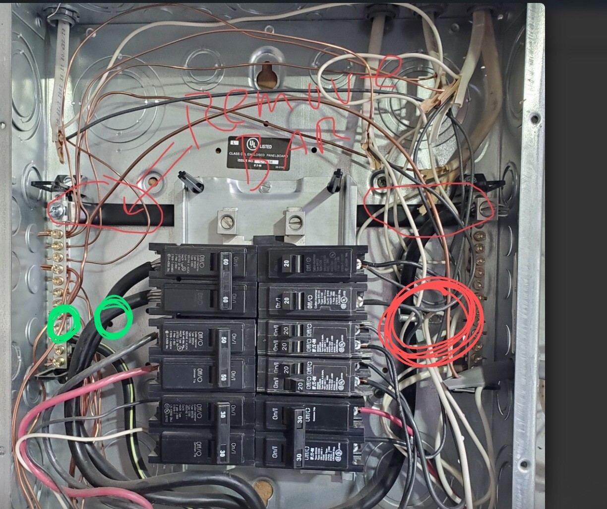

Is this acceptable?
/ Electrical question. #44
Similar to were you removed the jumper on the right (circled in previous post) there should be a screw hole next the left ground bar to use and the end can be inserted were you put the bare wire.
#45
The large silver screw on the left held the jumper. It did not look like it would screw down enough to hold the 10 gauge wire I used, so I routed it farther down the bar. That is why.

I was referring to the two areas marked in green.
Can you show us the inside of the main house panel. Maybe someone will see something for you (or your electrician friend) to check on.

So are you saying those circled in green are wrong? I feel so defeated.
/ Electrical question. #51
No sir. That is were the jumper from the right side that you moved to the upper left and extended should go.

#52
It appears no matter where I put it, it will still have to be jumped to the ground bar. I see no holes that would allow me to insert it directly into the ground bar.

Will it fit like this on the bar with the bare wires?
