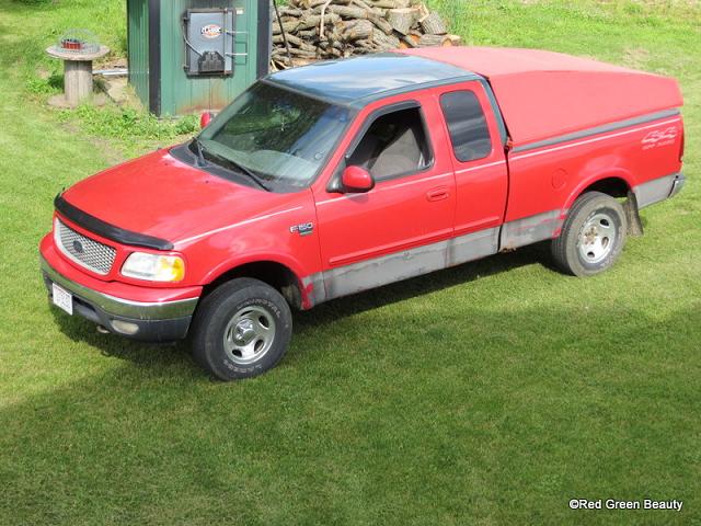

Off topic, but are you getting better gas mileage with synthetic oil, driving habits, or aero dynamics?
I built the ugly topper below and got a 2.5mpg increase. Driving like grandma helps a lot also.
Off topic
It started with the breakin. Oil changes at 750 miles, 1300 miles, and 2100 miles. Highway, city but not jamming on the accelerator during the 1st 2100 miles. Tough to do on a high performance (but stock) engine. I added an Air Hog air filter instead of stock. I added a quad fold cover to the bed. I used non-ethanol gas. And then I worked to find the torque points for highway driving speeds.
The engine is an lq9 (same as an escalade in 2004). I bought a truck with the desred rear end ratio. And I started with 19 mpg highway and kept improving ascany well broken in vehicle will do.
Still stock computer settings and no engine compartment mods. Its a rwd chevy ss 2004 less than 1000 made in 2004.
