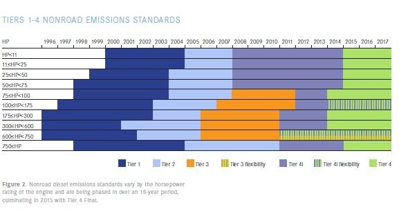

1. The biggest producer of scuts is Kubota . . yet to my knowledge as of this Spring they were still Tier 3 product. If its easy to simply detune to reach Tier 4 . . then what would Kubota's logic be for staying Tier 3 ? Let's remember that Kubota built is reputation and quantity lead by being a leader of innovation . . not a follower.
2. Yanmar and Massey are both Tier 4 rated . . As is Mahindra scuts.
3. John Deere scuts . . I don't know.
My point is . . unlike the cut and larger sizes . . who all must meet extensive Tier 4; the very popular and profitable scut market offers much easier Tier 4 options. But that scut market has become intensely competitive especially with the big names since 2013. Tier 4 class for cut and larger was a disincentive for many buyers imo and they gobbled up old inventory. But the scut market didn't have the same issues and I believe Tier 4 approval by numerous brands was an incentive to cleaner exhausts and still simple maintenance. I sense going to Tier 4 was an advantage in selling . . but required more than just detuning . . or Kubota would have done it long ago.
Opinions and input are welcome to my viewpoint . . but just saying Kubota didn't care . . Would be illogical imo. Kubota always cares about being an innovator not a follower.
Is Scut Tier 4 really easy to do by just detuning and so most of the best engine builders (Izeki and Yanmar) "chose to detune" their designs ? It just doesn't seem logical to be superior designer/builders and then detune them imo.

As far as I am aware all of Kubota's BX engines are Tier 4 F... same as Iseki (MF) and Yanmar (JD)
All the E3B and E4B Kubota engines are Tier 4... So you are correct in the fact that Kubota did not chose to lag behind and are currently Tier 4 compliant as mandated by big brother....
BX25D - Engine D902 = Kubota Engine America - D902-E4B (3200rpm)
BX2670 - Engine D1005 = Kubota Engine America - D1005-E4B (3600rpm)
BX2370 - Engine D902 = Kubota Engine America - D902-E4B (3200rpm)
BX1870 - Engine D722 = Kubota Engine America - D722-E4B
Here are the EPA requirements for ~25HP
There was never a Tier 3 for these smaller engines either Tier 4I or Tier 4F going from Tier 2.
