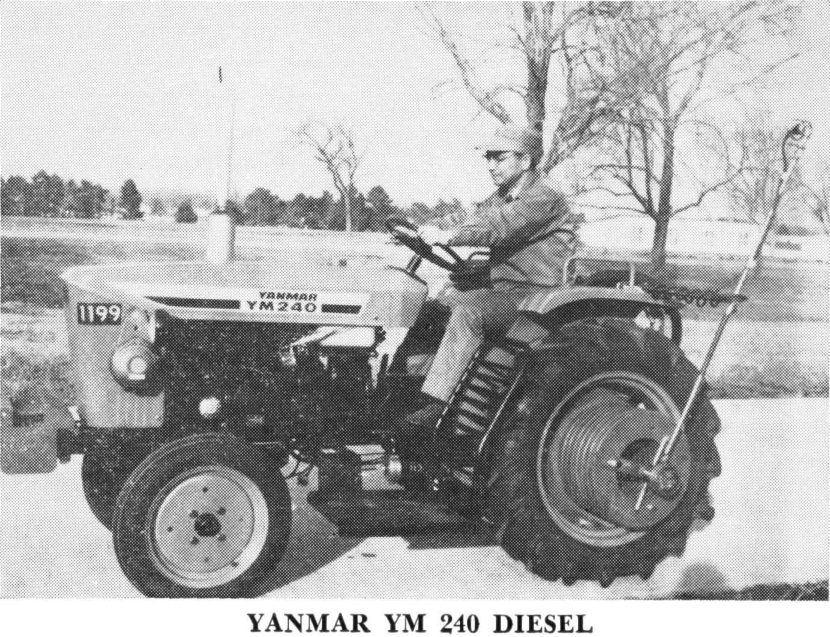

Forgot I had this photo already posted here.
Here's how much ballast was needed to make this 24 hp Yanmar match the drawbar pull of the Ford 9N described above. Same rated hp, but this was designed to put 20 hp out the PTO continuously to the tiller that was almost always sold along with the tractor.
Quality was excellent so a lot of these (YM2000, the Japan-market twin) got repainted and imported over here where they are still durable and reliable as they approach 50 years old.
ym240-nebraska-test-ballast-jpg.722712
