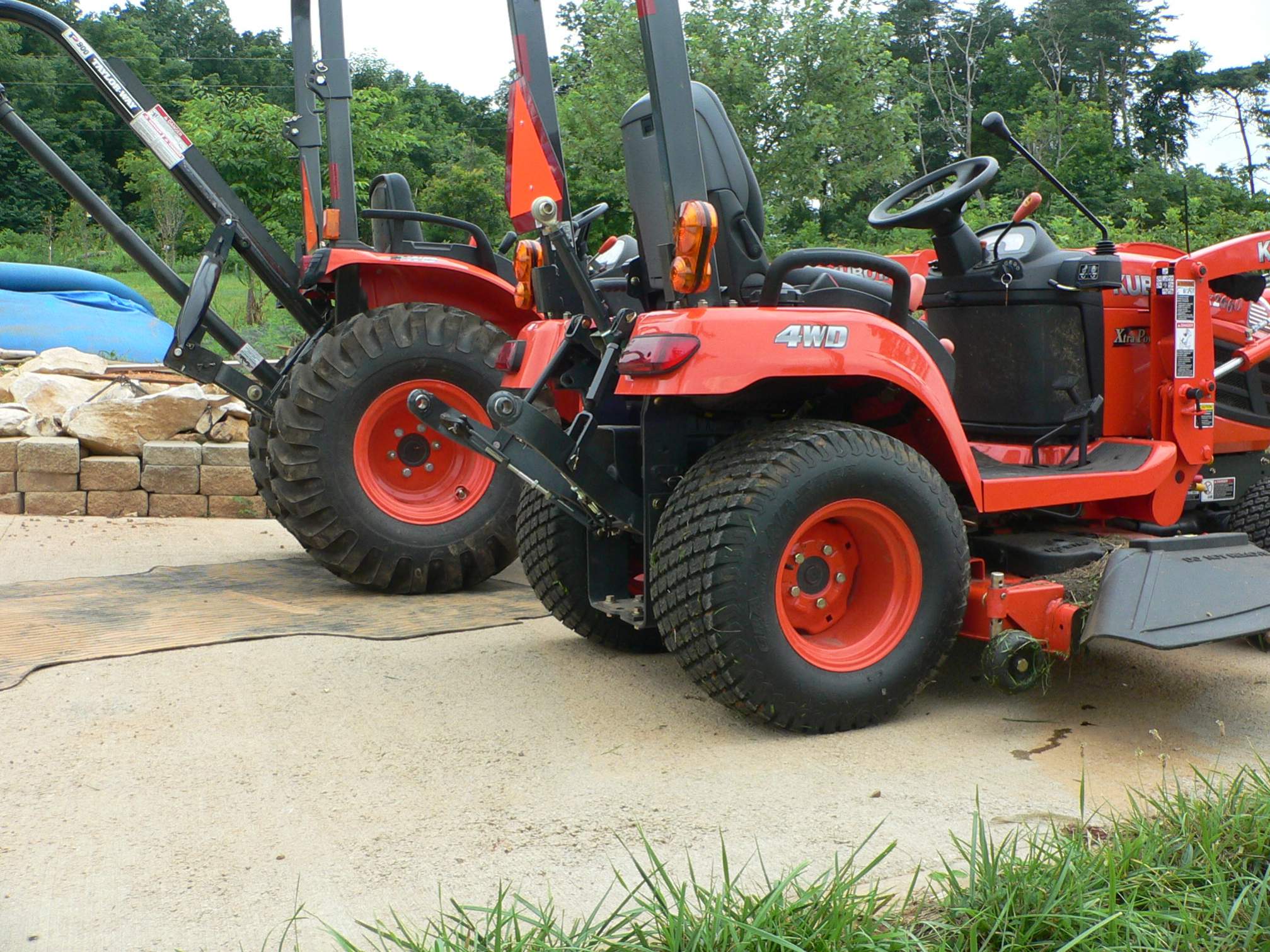

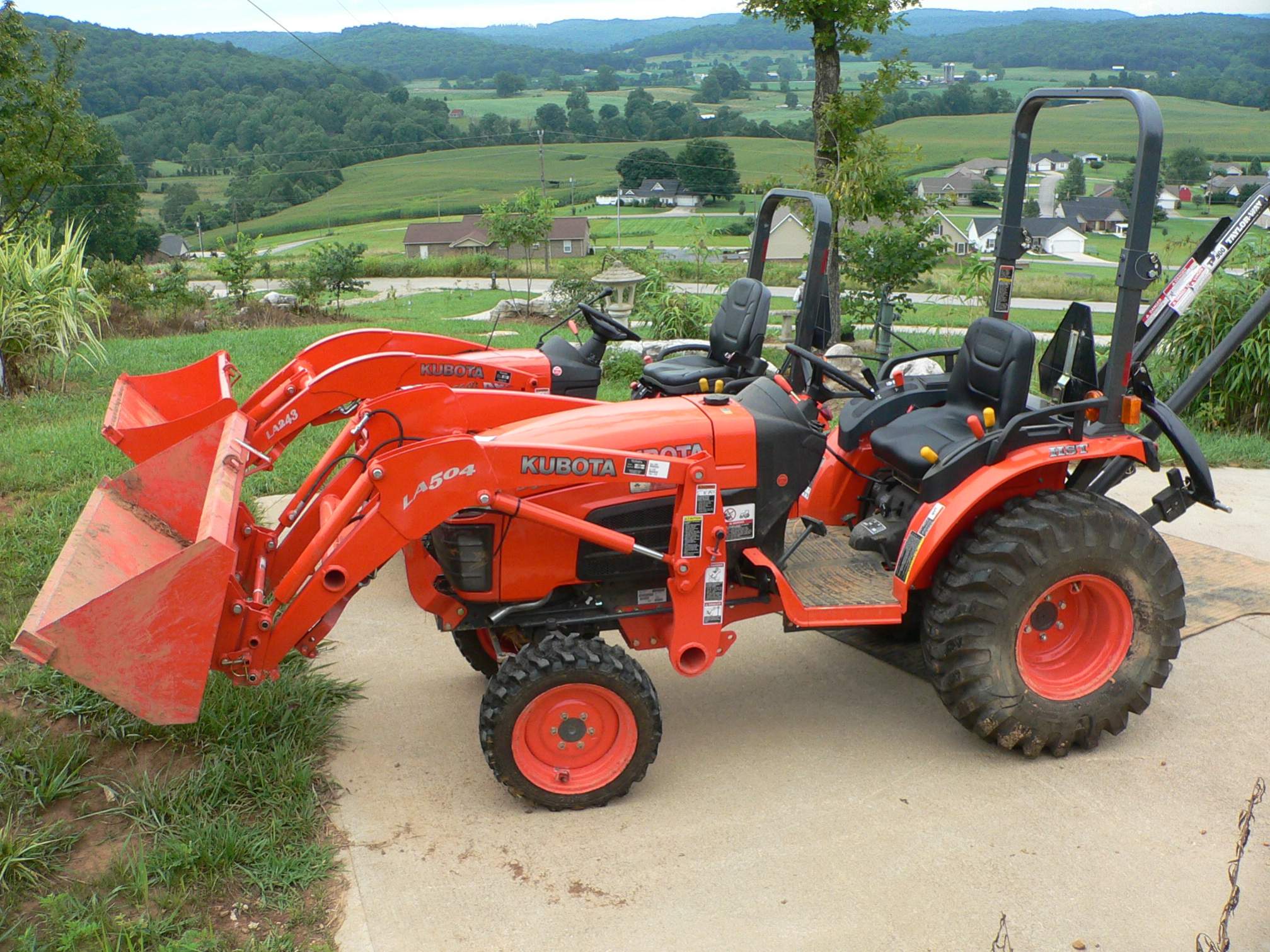

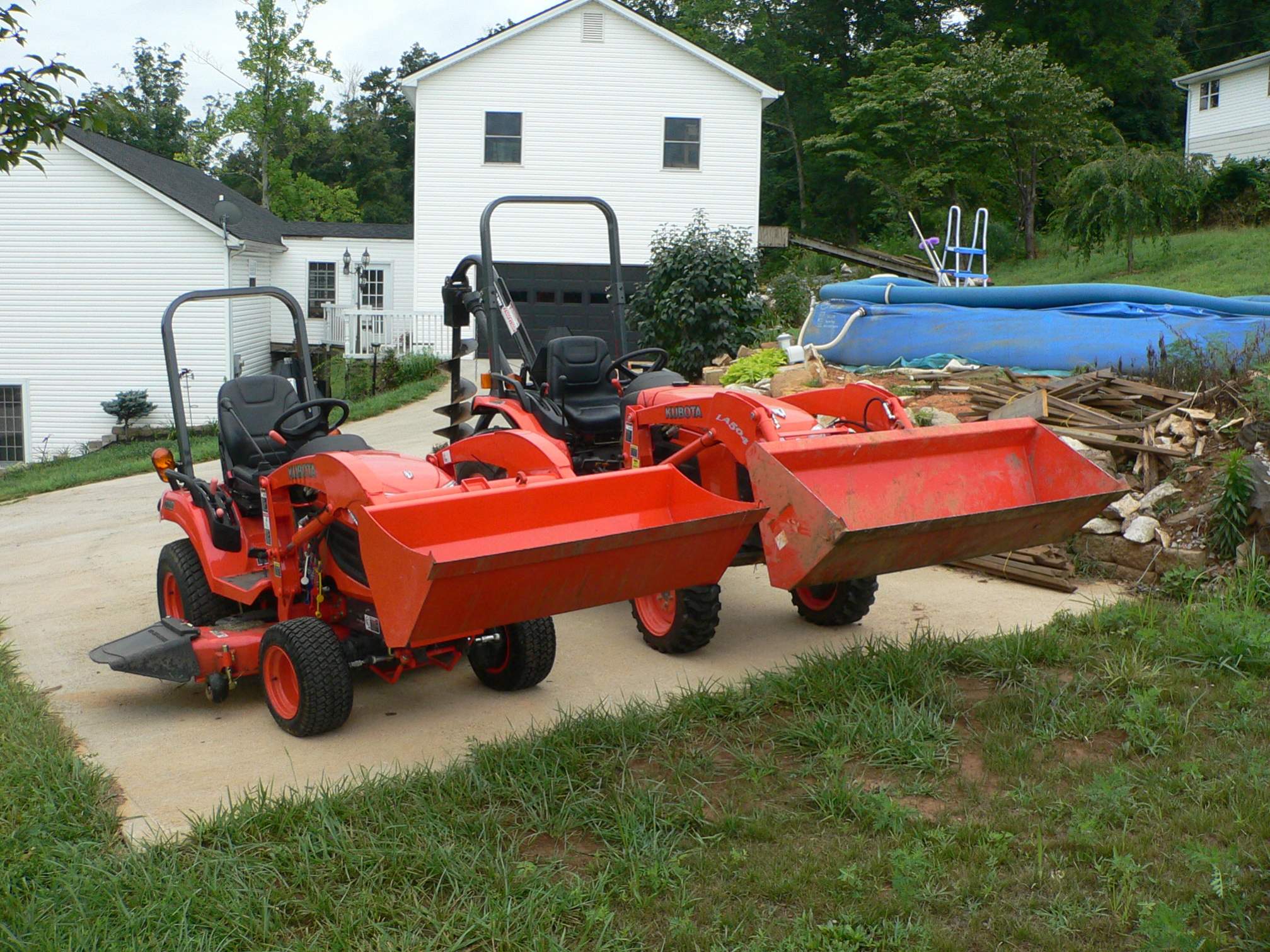

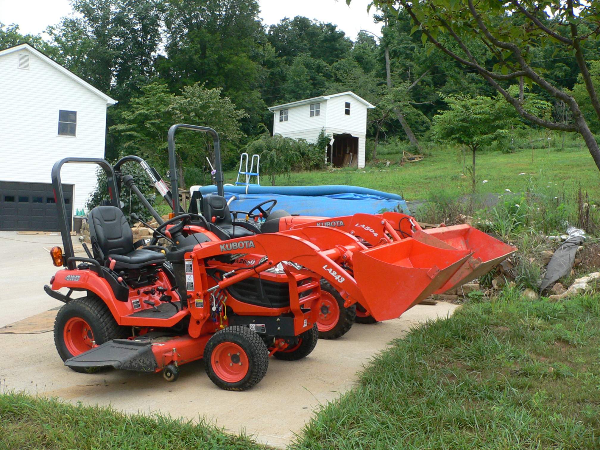

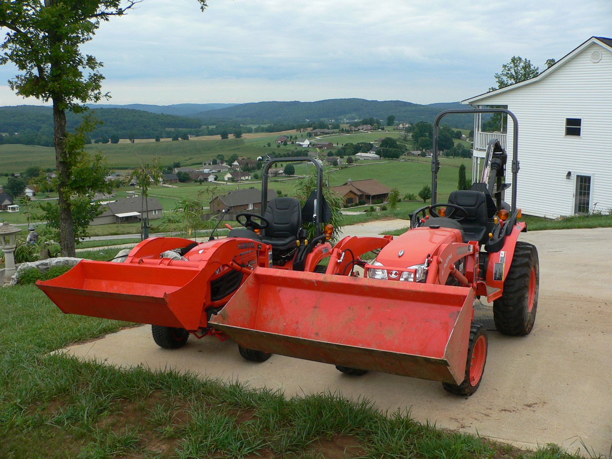

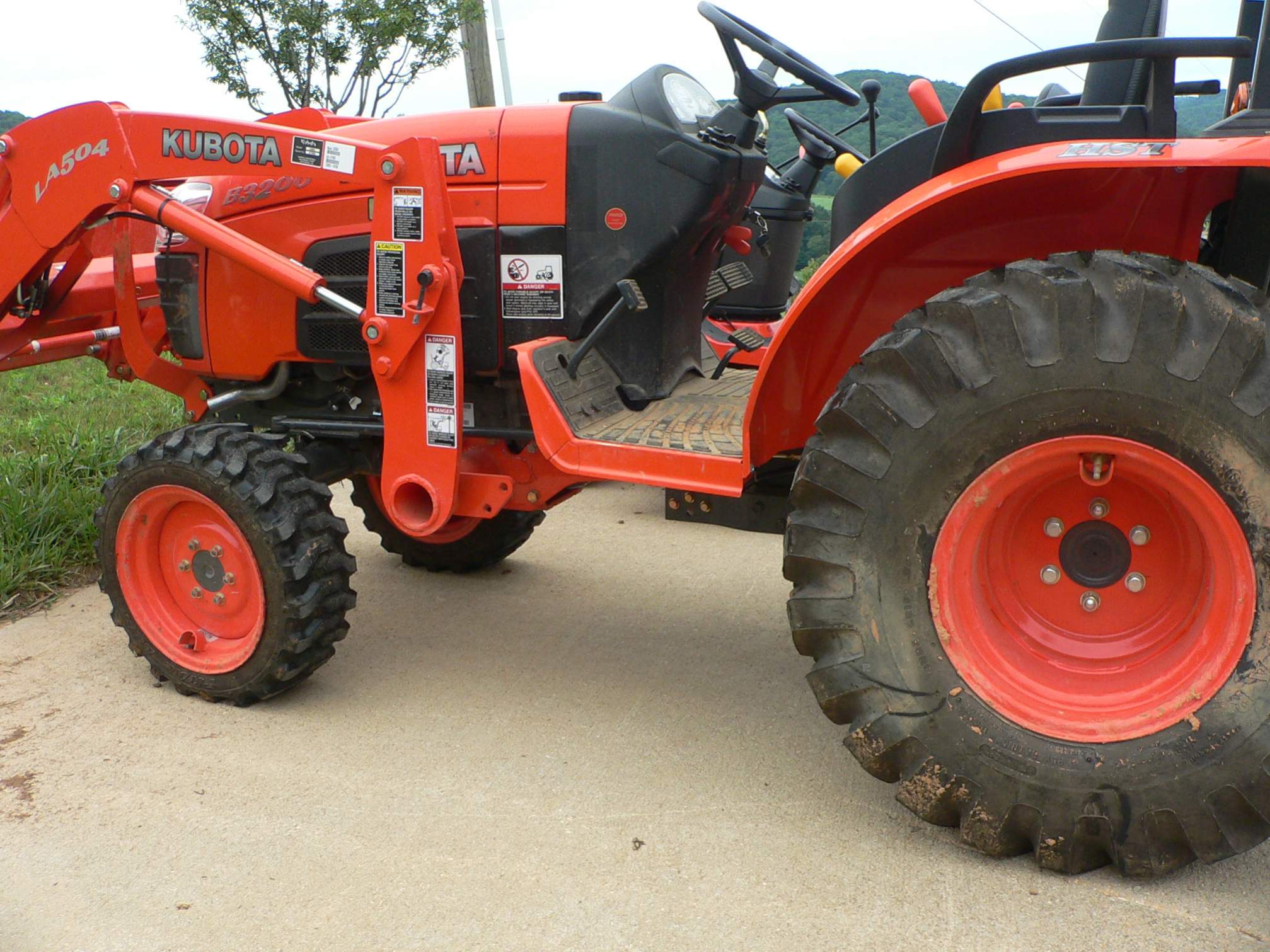

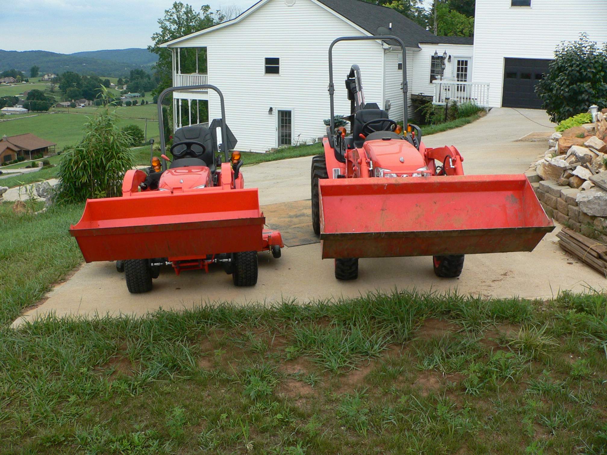

Very good advice. Attached pictures of BX2660 and B3200. The BX seems more stable going side ways on hillsides but the B does not scare me and does not feel unstable. I just won't drive it across hills, don't have to. As you can see a trailer that would haul one will haul the other one. The weight is not significant between either one. Have traded several times in 6 years so trading difference between a BX or B are slight to no difference when you figure what you pay for a BX and what you pay for a B the trade in value will be about the same amount of cost for time used. The 0% interest for new is the killer for newer trade ins but it's the same for either model. As you can see my choices for tires on each tractor. I don't do ags and never have, leave them for LB but when you study pictures he has some non ags I believe. Jobs determine tires. Ask around your area and talk to tractor owners concerning their issues but always remember to factor in their bias to justify their purchase as has been mentioned here. Also, what are tractor dealers of any brand in your area telling you concerning equipment and tire needs/recommendations.
