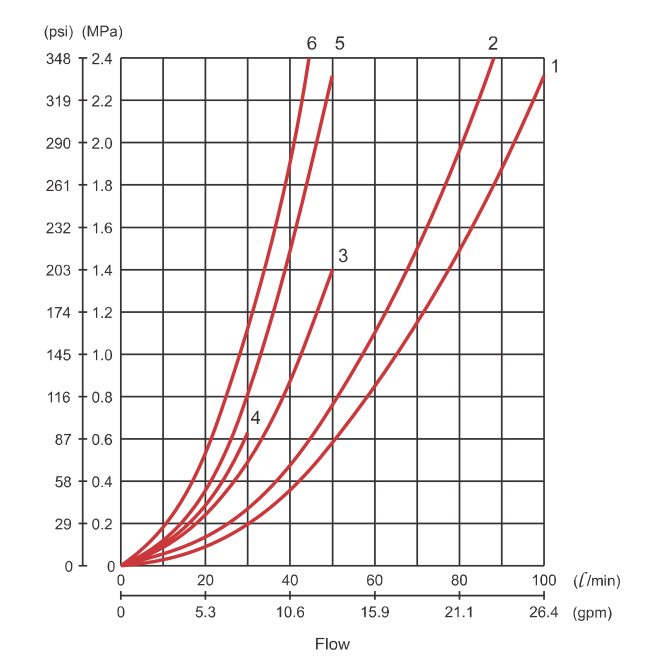

What is the flow rating of your tractor? Reason for asking is that typically the tandem center spool has the highest pressure of all the spool options. Also does manifold manufacturer publish pressure drop vs flow data for series manifolds? D03 is typically around 1/4 hole and possibly less if angle drilled for series circuit.
As point of reference I looked at Rexroth and Eaton D03 10 GPM is around 70 PSI per valve 5 GPM approx 20 PSI

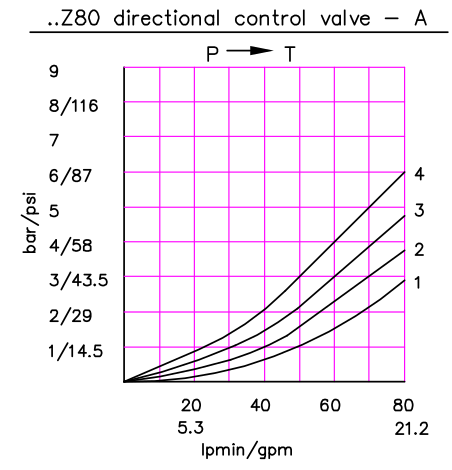

Yes, I'm concerned about this; cartridge valves while smaller would be even worse. My tractor is only 6-7gpm for the implements, so on the lower end there, but as you say that's PER VALVE. As opposed to a monoblock design which (according to Summit & how I read this chart - i believe the curve ID's are the number of valves in the unit) - only about 20psi total for 5gpm flow
summit monoblock (Badestnost brand) P->T pressure drops (z80 / "21gpm" model), but number of spools. Note technically this is the manual version, not the solenoid version).
Hyvair D03 valves (#2c [tandem flow] P->T is curve 3

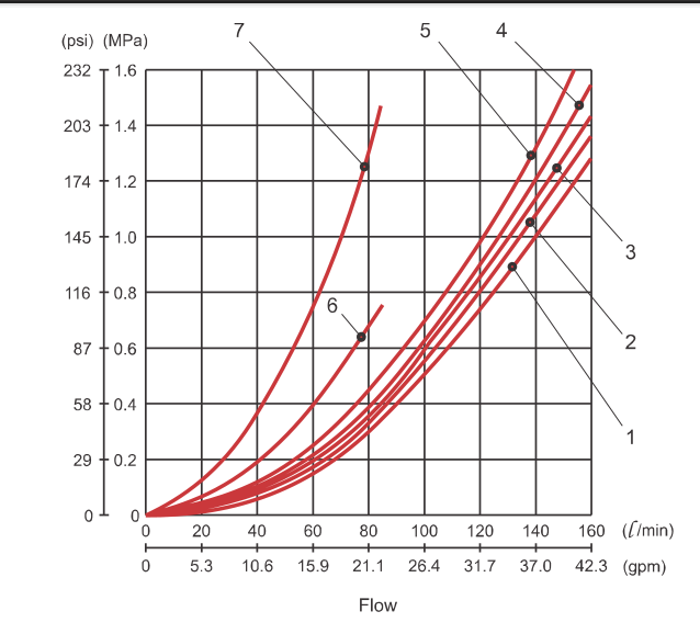

Another option i am considering would be to use one D05 valve, routed to two (stacked) diverters. The diverters are bad for pressure drop, too BUT:
  • my three circuits here are Top&Tilt + Grapple - none of the cylinders are needed simultaneously
  • they're all relatively small, so having the D05 would minimize typical losses (no grapple or TnT use), and only incur those penalties momentarily while actually using those circuits.
D05 has ~10psi drop @ ~5ppm and ~30psi drop @ ~10gpm, dramatically lower than D03 (D04 flow #2c (tandem) P->T is curve 6 here)
