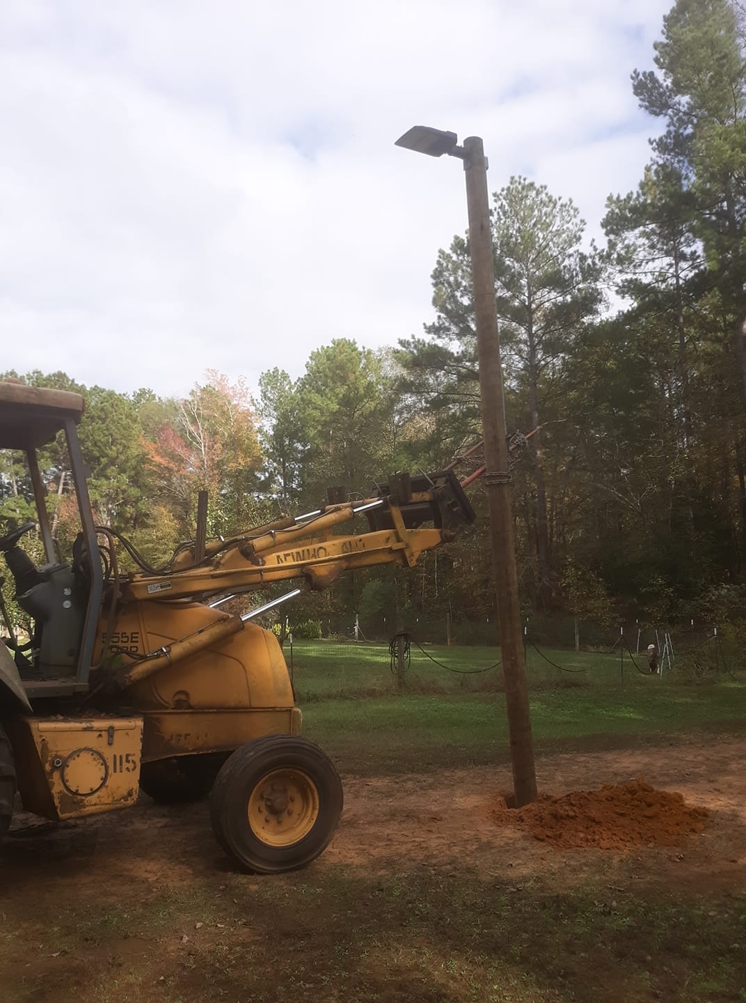

I have three Ledmo LED Parking lot lights that where great while they worked, but they only last a few years before dying. I've replaced the sensor on top without any improvement. They sort of die like a fluorescent light does. The amount of light they put out drops dramatically, then it's just a faint glow for a few days until it's totally dead.
This is what I've bought.
I've been looking on Amazon, but not seeing anything that I want to buy. I'm not wasting my money on any more of the same thing.
Is there another website that you have used that provided a good quality parking lot light?

Thank you to everyone that offered suggestions on where to buy the lights. After looking at all the lights available, and not really seeing anything that I liked, I decided to go with Lithonia Area Lights that they sell at Lowes. It's a name brand that I've had good luck with, and I just felt more comfortable with them over everything that I saw online.
One of the things that made me nervous about the Ledmo lights was the plug in light sensor on the top. In the three years that I had them, I replaced the light sensor twice. Before the LED Ledmo lights from Amazon, I had Metal Halide lights that also had the plug in light sensors on the top that needed to be replaced a few times in ten or so years.
I already had one of the Lithonia lights on the side of my house and it's performed perfectly for the last couple of years. It has the little built in dusk to dawn sensor that you cannot replace, but seems to work flawlessly.
I bought two of them for my driveway. They only have 6,000 lums, which is a lot less then what I had before, but I really can't tell the difference when looking at the light at night time. It's too early to know if I made the right decision, so for now, it's all good and we're happy with them.
This is the view from my window, looking towards the driveway with the light on. The light is probably 300 feet away from the house.
