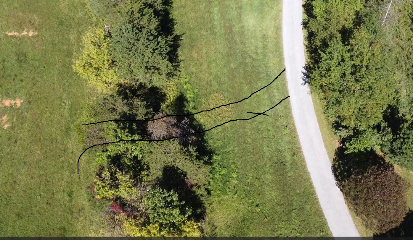

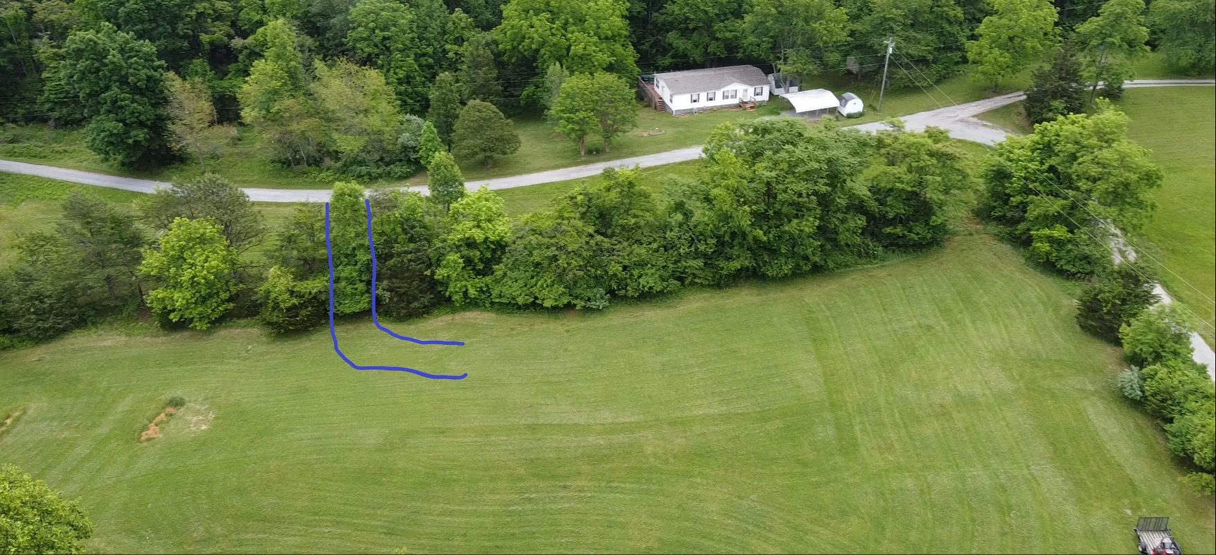

Only reason I’d hire out pole barn build is to get it done fast. I’ll probably go small that I can extend later. Something I can store building stuff in.
Only tree clearing is to bring drive in
I will be general and will pull permits as owner builder.
Very few pines, but considering planting some firs to block neighbor house view to the north.
Not sure how I can write off sales taxes. I built current house and paid tax on all.
