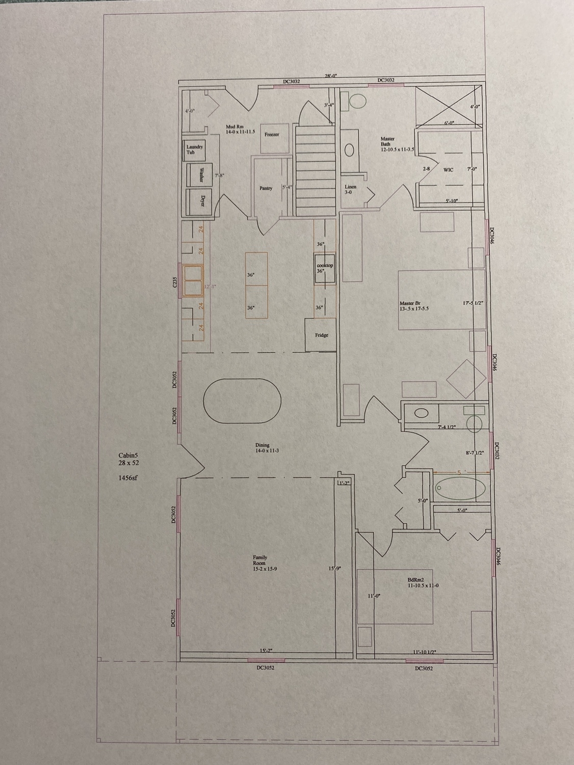

Not done, but here is what I drew up so far.
Need to do master bath area yet.
Not a cabin now, 52x28 with 7 ft porch on 3 sides. Did not put in stairs for attic room, but full basement.
By putting front door on long side, I will turn on the lot to have walkout on the long back side.

So, your utility room, I would want to add a space for a stand up deep freezer. Doesn't take much space, but thats something that is hard to find a place for, if you didn't plan for it.
   / Southern VA lot - What to do #106
Also, it looks like, if you shifted the master bed, 2nd bed, and hall bath, to share a common wall with the backside of the kitchen, and slid the master bath to the tee off that wall, it would make plumbing easier, including a hook up for an ice maker at your refrigerator. Although an interior wall, I would insulate the long center interior wall, just for sound purposes.
Good point, our freezer is now in basement, would like that upstairs.
Not sure I totally follow.
My current house i insulated all bathroom walls.
I might make center wall 6” behind fridge. I need 6” for bathroom stack.
   / Southern VA lot - What to do #109
Typically, interior walls aren't insulated, but its a pretty cheap 'quality of life' thing to add during planning/construction, but difficult/expensive after the home is built.
The thing with plumbing, it's just more cost effective is your design can have fixtures back to back (not 100% back to back, just on same wall, opposite sides, near each other) on a common wall; less slab penetrations, less pipe, less roof penetrations for vents, ect. Not the end of the world, and not always possible.

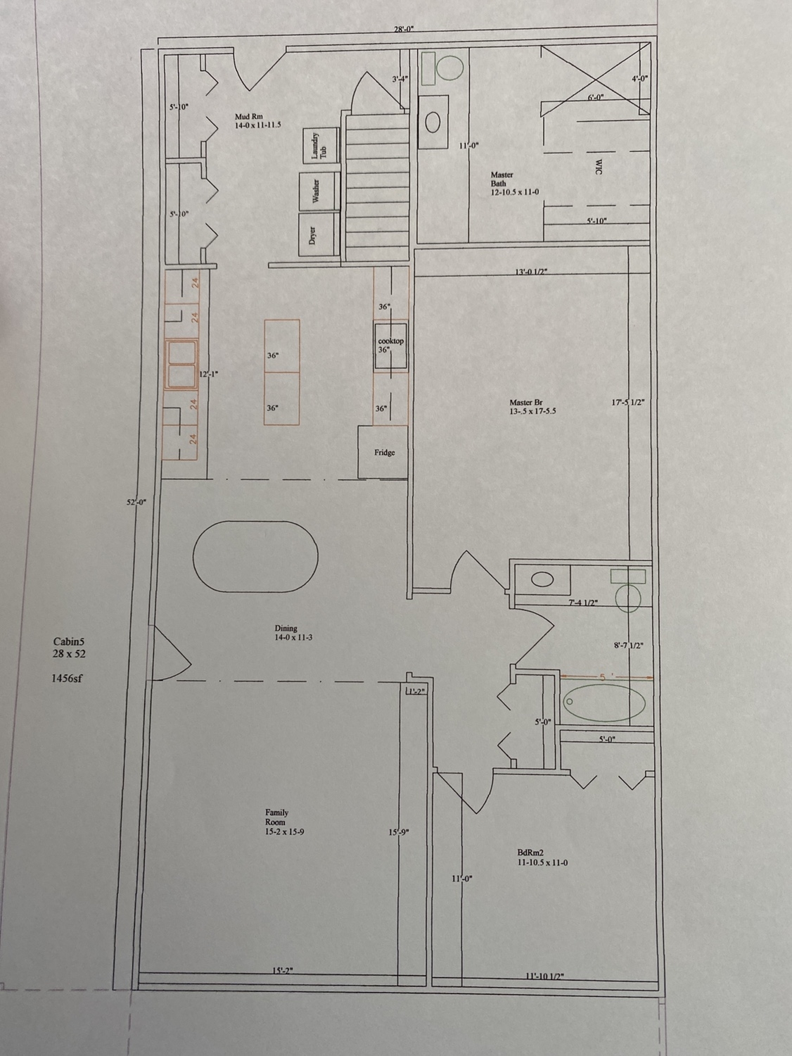

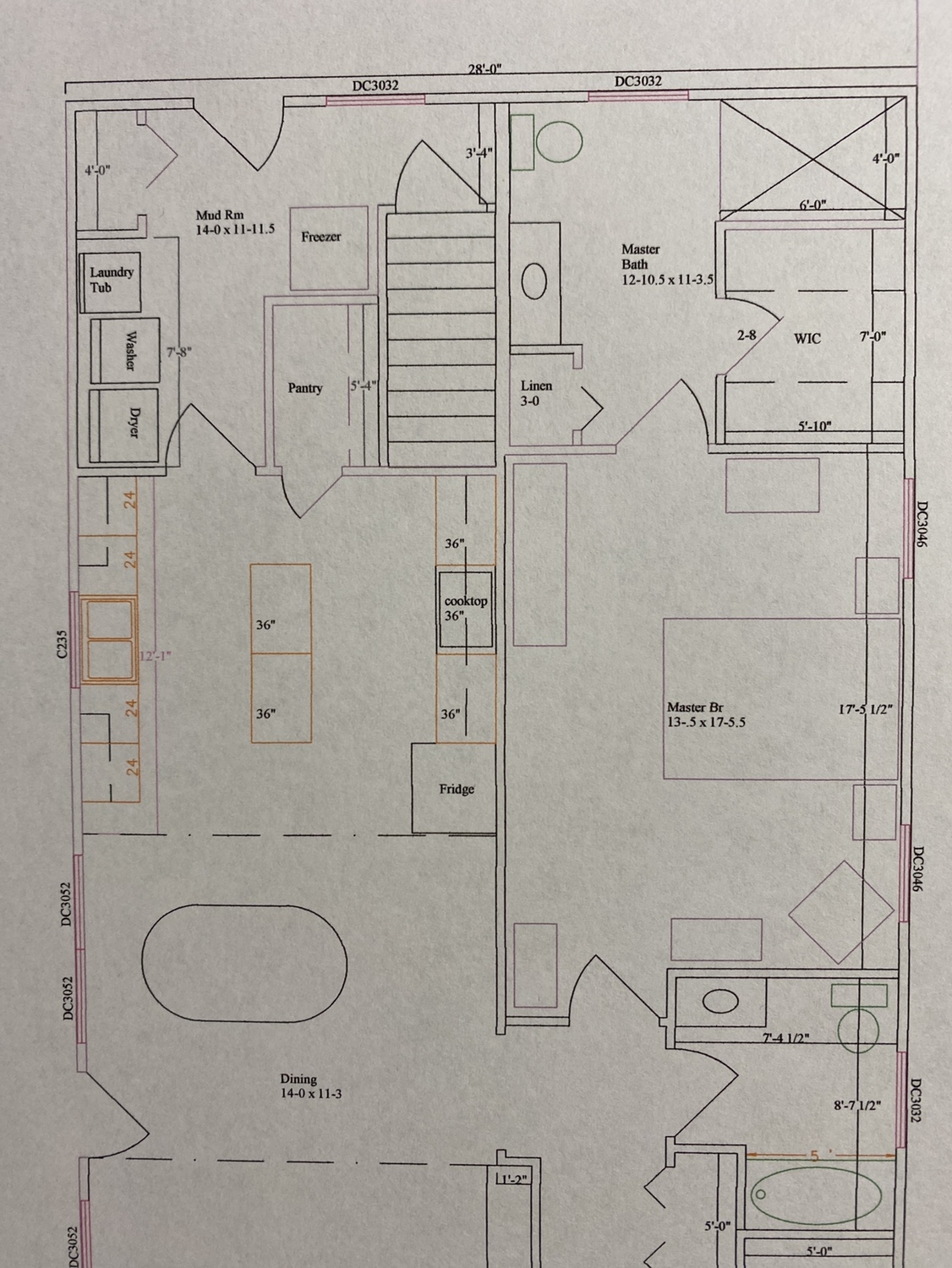

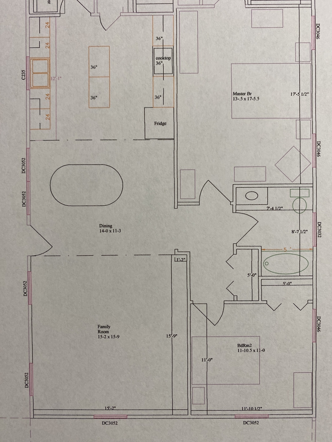

Latest version.
First one includes 7ft wrap porch, other 2 just a little closer to see better.
Porch will probably be a later addition, although I’d prefer to do all the roof work at same time. I’d really like standing seam.
Rearranged mud room to include freezer. That was a great comment.
Pantry opens to kitchen. Debating that one.
Finished master bath.
Added windows, but have not done final position.
Microwave cart will go to right of fridge.
