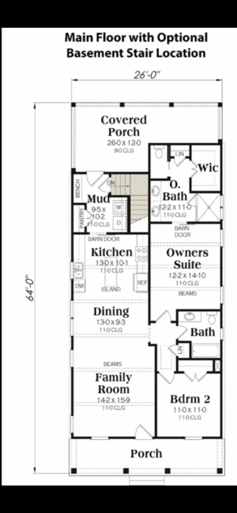

Found this floor plan that I find interesting. I would flip it for the lot. Thoughts..
I would wrap a 6 ft deep porch around this side.

Not bad. Is there a loft?
   / Southern VA lot - What to do
#85
Could make one. I’m thinking a basement though. With the roof pitch shown I would get trusses with a room inside, even if only for storage. Could put mini split up there.
If money was no object... Make the house 2' wider all along just for a bit more room. Add a window to the 2nd bedroom so that you can get cross flow breezes while sleeping. Extend the mudroom wall to the end of the bathroom. More room for people (and your work clothes) when they first come in and it lets you straighten out the basement stairs. Stairs with a landing are a pain to move larger furniture on. No outside lights close to or over a door. Then the summer bugs aren't right there when you open and close the door.
