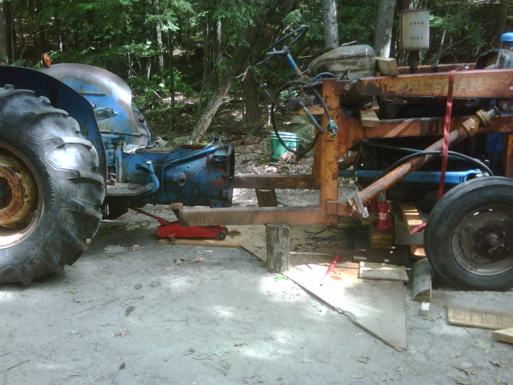

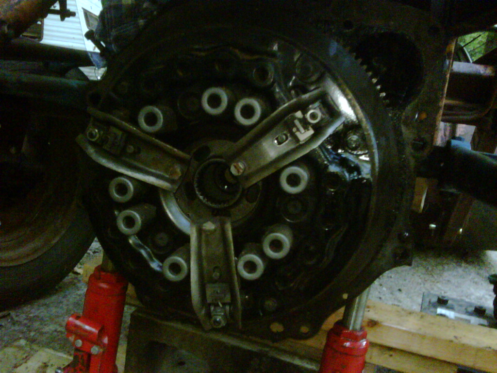

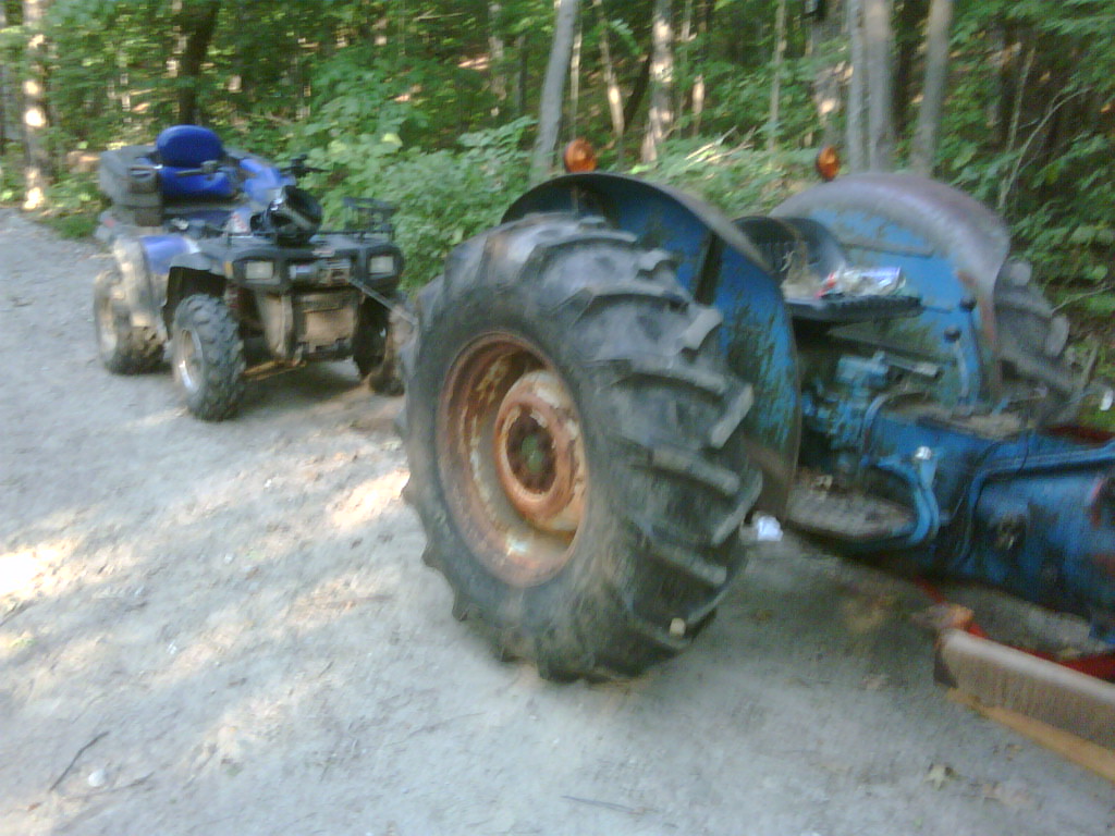

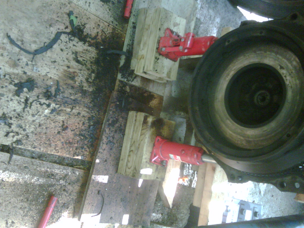

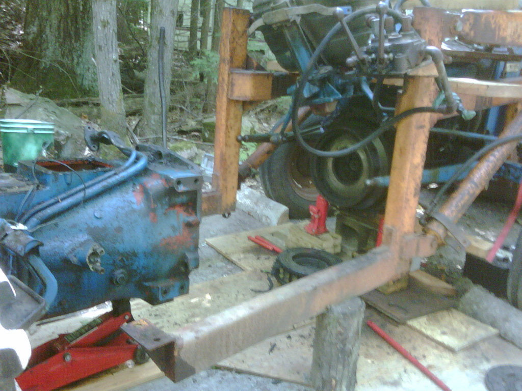

Well I finally took advantage of the nice weather and some time off work to get this thing split. I left the loader on which actually came in handy to support the steering box since I couldn't get the draglinks disconnected from the steering arms. The hardest part was getting the starter motor off. There was one bolt between it and the engine which was a totally awkward spot. I managed to get a socket on it and give it a turn to loosen it enough so I could turn it with my fingers. This took quite a while. The ATV winch came in handy to pull the transmission away from the engine. The wife operated the winch while I watched out for any snags with the steering box and hydraulic manifold. The clutch was totally shot. The pressure plate had disintegrated and the rivets that held the old pads on it had scored deep gouges in the friction plate. The fly wheel looks like it is still in good shape though and no teeth are worn or missing. I am going to order a new clutch package along with a throw out bearing and a pilot bearing. Now comes the hard part. Putting it back together. Tractor Serial Number.jpgTractor Split.jpgWorn Clutch.jpgWorn Clutch Disc.jpgATV Winch.jpgClutch.jpgDrive ShAFT.jpgFlywheel.jpgFlywheel Close.jpgPressure Plate.jpg

I have splittes some Ford but never the way you show on the pictures. I`v only took out the 3/4, 5/8, 7/16 bolts connecting engine to transmission. Also fuellines and electical. Steering gear assy. and dieseltank was never moved away. Rod assys was demounted at rear cap.

Problem was I couldnt get the darn rod assys apart. I suppose if I had more patients and got a tool to remove the ball joints I might have been able to remove them. Someone suggested removing the steering gear assembly instead. It was a little more work but, I finished the job. In fact the removal of the steering gear assembly allowed me to get a drift pin behind the throwout bearing so I could pound it off. It proved to be just as stubborn as the steering rods. Now that I have a clutch alignment tool I am just waiting for some time off work so I can put her back together before winter.
