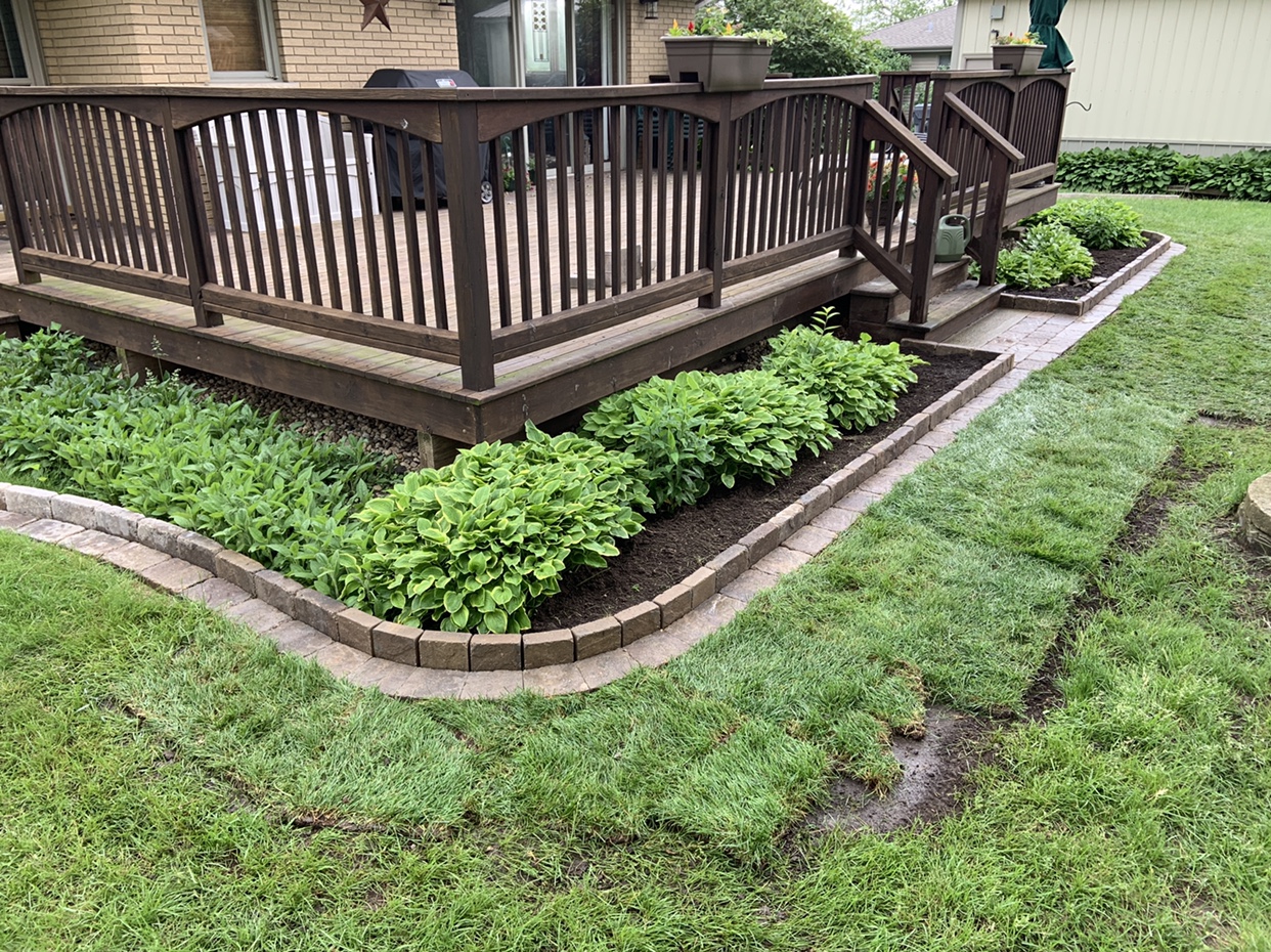

Has anyone used a landscape block splitter to split Belgian pavers with success? The concern is taking a 6 inch by 9 inch paver 2 and a quarter inches thick and splitting it on each end to make trapezoid shaped pieces to make them fit a radius. Basically, I’d be splitting a wedge off each end, about 2 inches wide to nothing, and the thickness of the block. I could rent a wet-saw, but if the splitter works, it’d take a quarter of the time.

You might use a 2 inch tracing chisel. About $90 at a masonry store but worth the money.
/ Splitting Belgian Pavers #3
I have scored both sides with an abrasive blade on a circular saw and split with a wide masonry chisel. Goes pretty fast.
/ Splitting Belgian Pavers #4
My son has true basaltic lava "blocks". They are 7" x 10" x 5" to 6" thick. I used an abrasive blade on my worm drive saw to score them. Then a splitting chisel to complete the job. End up with two pieces - 7" x 10" x ~ 3" thick.
Kind of a long, involved process but ended up with enough pieces to make a fairly large back yard patio area.
The "blocks" were originally used as road pavers. No need for that heavy a block to just make a back yard patio.
/ Splitting Belgian Pavers #5
Depending on how many you need, you might get by with some rough split pavers but they probably won't fit together well and will be noticeable when trying to repeat the same shape. If you have a larger area to do, you cant beat the precision and speed of a large wet miter saw with diamond blade. The one I used had a nice Honda engine, and although it was really beat up it performed beautifully. Perfect smooth cuts every time.
/ Splitting Belgian Pavers #7
Sounds like you should start with a circle kit to make a radius. However, I'm going to guess that you already have the pavers and want to make them work.
I have used a block splitter for years and it does a pretty good job. Sometimes you get a block that won't split straight and you end up with a piece that needs ground down with a masonry grinding cup.
/ Splitting Belgian Pavers #8
Put a diamond blade on a 7” grinder, not as nice as a wet saw but a lot less money. If you are brave/stupid like my uncle that is a master mason you use a 10” blade on a 7” grinder with no guard so you can cut thicker.

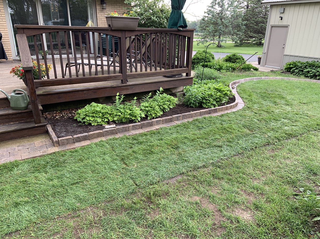

Thanks guys. Got it done. At least this portion. Now to finish the sod and seeding. 58111991032__F19F5444-99E7-4FA9-8185-EDA96C4CB658.jpg58111992540__CC7EA37A-2451-4772-B6B4-8B7A71354275.jpg
/ Splitting Belgian Pavers #10
Very nice. How did you do the cuts.
/ Splitting Belgian Pavers #12
It looks great! I like the pavers laid flat to you can mow and not have to trim.
