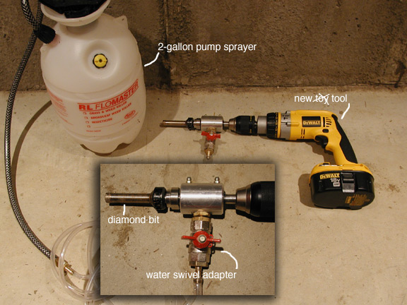

Quick questions. I assume your F&W are 1/2 inch since that is the stated size of your core bit. They look bigger in the photos
How deep and how long did it take to drill each hole with the 1/2 inch bit?
/ Splitting Rock #26
That's correct--1/2 inch F&W. The core bit will drill about 2.75" deep and takes approximately 2 minutes per hole. The core bit with the water coolant requires a steady pressure and moderate RPM. I could drill about 9-10 holes per battery (I have 3) with this drill--no problem. I use a masonary bit to start the end two holes and then dowel the template in place to start all the other holes with the core bit....
/ Splitting Rock #27
I have not used the diamond drill and have not seen any masons using one for this application. I use carbide tipped spline drive masonry bits. I like the Dewalt as they usually are a bit beefier and have 4 points on their big bits where others have 2. I don't use any water and have a portable generator for when I am away from available AC power. I generally keep my holes about 4" deep or so and usually work with 3/4" holes though I will use 1/2" in tight spots.

As for core bit V. masonry bit, I still am not sure which is better. From my reading, one point of view was that its easier (removes less material) to drill the rim of the hole, not the entire hole.
AndyR: how long does it take you to drill your 1/2 inch holes. I assume you are using a hammer drill as well?
/ Splitting Rock #34
The reason I went with the core bit (certainly not expense) is that I wanted to be totally unplugged. With 3 charged batteries, I can drill between 25 and 30 holes, which is plenty for the sessions I do. I do need to run down to the quarry after every two or three holes to refill my water, which slows me down a little. I don't mind the break in the drilling--besides, I can have a cookie and think of my good fortunes to be in such a beautiful place.
The core bit, I believe, is used a lot for drilling holes in countertops and leaves a very finished surface--not important to me--whereas the masonry bit, I would guess, would leave a more rugged surface. I've attached a picture of a piece of a core.
I've also read that it's real important to wear some respiratory protection--especially with the masonry bit as the dust can be quite harmful to breathe. The core bit just runs all the ground up rock out as slurry in the water coolant, but I wear a mask anyway...
