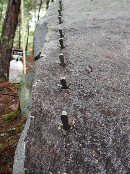

Things go pretty quickly with the 1/2" bit - I would say about 40 seconds for a 4" deep hole. Maybe less. I usually experience breakup of the carbide tips before the the bits become too dull to cut. My weapon of choice is a Makita 1 1/2" spline drive hammer drill - I don't have the model number right here but is has handled drilling 1" holes in granite and concrete with ease. I usually have minimal problems with dust when drilling granite - concrete is much worse.
As far as splitting off your holes, it can be done using appropriate chisels and hammers but takes a bit of practice. Sometimes I get quarry rubble (i.e. cast-offs) and will work a machine cut face to get that modern look out of it. As someone else mentioned you can use heat to flake off the surface. Use eye protection and a MAPP gas torch (yellow bottle) and metal rod or wire brush to get off the flakes. You get pieces anywhere from 1/4" to an inch and some of them pop off at pretty good velocities but is softens up machine cut surfaces and gives you a pretty smooth yet textured surface. If you want to take down a high point use chisels and/or segmented edge diamond blades in a grinder (major dust alert) unless you have lots of money to burn on gas.

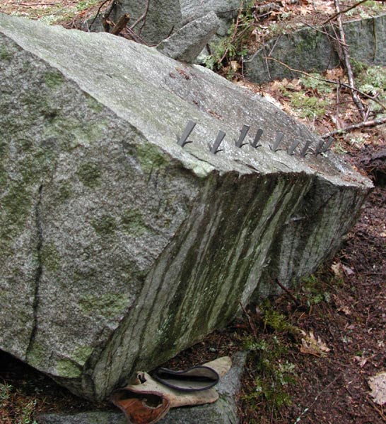

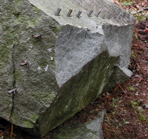

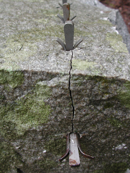

If you can hire the feather wedges as suggested,4 would be plenty,drill along the long side,place the wedges,and tap them in with the sledge hammer and you will be surprised how easily it will split.Follow the grain whichever way it goes if you can.
