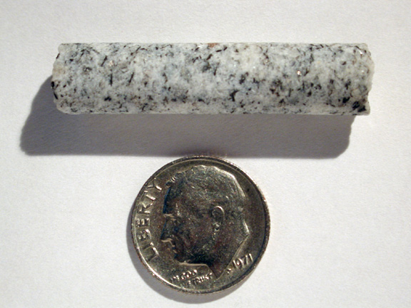

I've several (10 to 20) large granite boulders to split ranging in size from lawn tractor to Volkswagen size that need splitting. Based on this thread and You Tube videos am I correct in thinking that I can split them with an electric drill and feather/wedges? It appears that one poster, Gunnahafta, was doing it with 12v battery drill and a ス core bit. I have a Hilti 14v high torque hammer drill and a Milwaukee ス heavy duty right-angle drill. The Milwaukee is not a hammer drill.
1. Would either of these work with a diamond core bit?
2. Should I stick with my hammer drill and a regular stone/masonry bit?
3. What size feather/wedges are recommended?
I realize that if this will work it will be a LOT of Work. That part doesn稚 faze me. A year or two ago I cut down nine eucalyptus trees (some over 80 tall) sectioned them into rounds (some close to 3 in diameter) and split all of it by hand with a Chopper1 Axe. My only concern is can I split the boulders with one of my drills and feather/wedges?
Thanks guys for all the info but is still need answers to the three questions if someone has tried what I'm thinking of doing. Again thanks for your time and effort!
1) yes with a diamond core bit in any modern cordless 14-18v drill will do fine.
2) i dont see why you wouldnt stick to reg masonry bit especially for deeper holes
3) when you by the feathers and wedges they can give you ideas of what sizes are used and how many are needed for what size stones. its my understanding that 3/4" holes are normal with 1" being used on larger stones

I have split a few Granite boulders using feather and wedges. Used a 5/8 in. rotary hammer drill, 1/2in. rock bit and 1/2 in. feather and wedges. The holes drilled were usually about 10 in. apart and 8 or so inches deep. Initially I used an angle grinder with a rock blade to cut a 2 in. deep line that the holes were drilled on.:D
Feathers and wedges were ordered from Miles Supplies in Vermont.
For your situation try and fully expose the rock and then pick a line for the holes. The line should be nearer the middle than the edges.
A rotary drill will be much faster. Wear breathing protection as the dust [silica] is not lung friendly. :)

Well it looks like I'll be using feathers/wedges. Spoke with the people at Trow & Holden and they recommended starting off with the 3/4" sets. Great people to talk to. Per the advice on this site I've been digging out around the biggest boulders (car sized) to ready them for splitting. The smaller ones up to a ton I've been moving by hand with block and tackle and skids since I don't have a tractor YET! One day........... Some of them are half way buried in the ground but still need to come out. I just use a ten foot section of 2" water pipe and rock the boulder back and forth and stack small rocks under it to get it to grade level then pull it off with the bock and tackle and a skid. You'd think at my age, 64, I'd find something better to do but there's something about putting in a good days work like that that makes you feel good. Guess I'm just old fashion.
