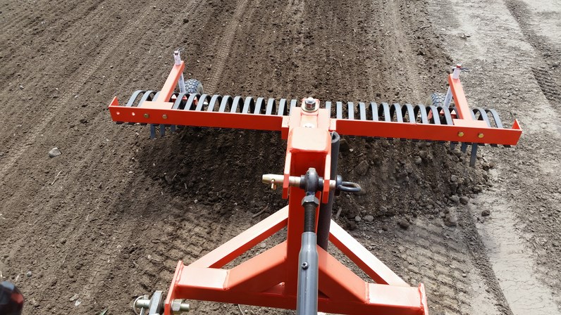

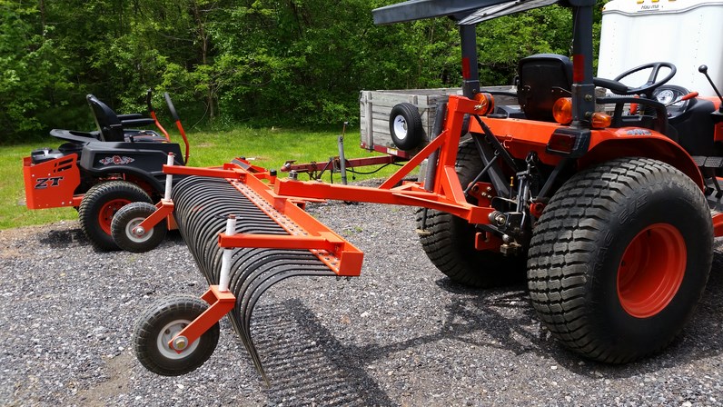

If you can afford a specialty implement for spreading three inches of sand I would go for a Landscape Rake, preferably with gauge wheels, which has a sieve effect, which will level the surface with much less operator experience than a Box Blade. Later, a Landscape Rake will sieve out horse apples if the sand is dry.

I would recommend a 5' landscape rake for your tractor. While a small land plane grader scraper might be ideal for the initial spreading the landscape rake will be more useful long term for clean up.

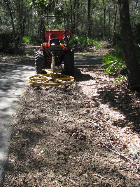

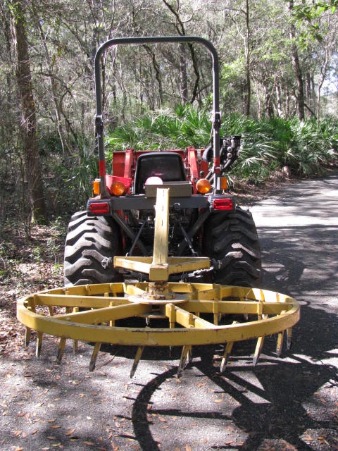

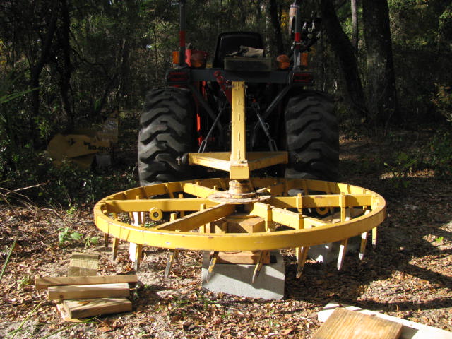

I have owned a King Kutter Rotary Harrow.
In my estimation a Landscape Rake would be superior for arena grooming because of its ability to sieve and collect detritus. Rotary Harrows do not collect, they only texture.
You need to purchase a Landscape Rake wide enough so when used on an angle it will still cover your tire tracks. Usually, this is a Landscape Rake around 12" wider than outside-to-outside tire width. If rake is wider than your tire width, used straight, you can rake near walls and rail fence. For this reason you may want a rake 18" to 24" wider than your tires.
I suggest you start a complementary thread in the ATTACHMENTS forum with a title such as MINIMUM IMPLEMENTS NECESSARY FOR HORSE ARENA MAINTENANCE. This thread is too narrowly focused for a newbie. Current title does not attract horse arena owners.

I have maintained an already established arena. Meaning the sand was there and just needed to be groomed. Have used rotary harrow and chain harrow for this purpose. Rotary harrow was much better at it. The chain harrow did not "dig" deep enough thus allowing too much compaction. The rotary harrow had deeper tines to break things up better.
Unlike the pics Jeff posted the one I have used in the past had three disks side by side. Easier to get into corners with.

The weight of a Landscape Rake will partially determine how deep the tines penetrate. If you want deeper penetration remove 1/2, 1/3, or 1/4 tines to reduce float on the remainder.
Lots of Landscape Rakes have been reviewed here. ETA produces one of the best.

I'd think an angled landscape rake with all the tines in and guide wheels to keep you out of the base would be a good solution.

I vote for the Landscape Rake with Guide Wheels!
The guide wheels are key to getting a nice uniform spread. I used the bucket to initially move and spread it out. Back dragging in float mode works good but the final grading is done with the rake. I initially made one to spread out 120 yards of loam and it did a great job. You'll get a lot of use out of it!!! Great implement to have around.
