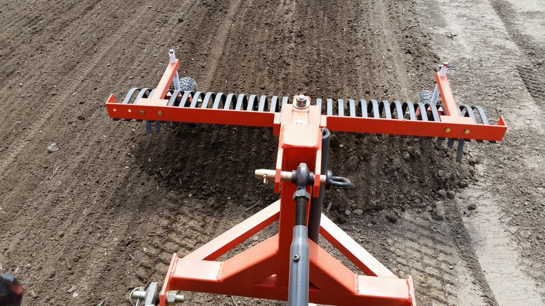

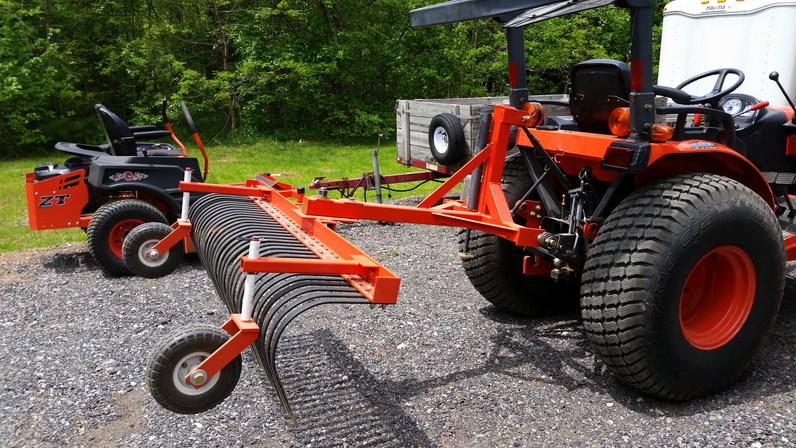

I vote for the Landscape Rake with Guide Wheels!
The guide wheels are key to getting a nice uniform spread. I used the bucket to initially move and spread it out. Back dragging in float mode works good but the final grading is done with the rake. I initially made one to spread out 120 yards of loam and it did a great job. You'll get a lot of use out of it!!! Great implement to have around.
You say you made this. What a fantastic job. It also looks like you can rotate it on an angle - correct? If I may ask, where did you find all the parts?

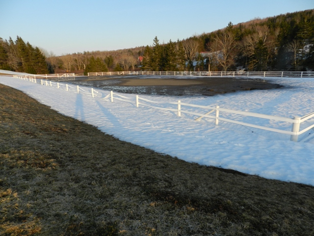

We cheated when we put in our 135' X 250' outdoor ring a few years ago...we had a contractor do it all. The base was leveled and prepared with loaders, dump trucks and a big, vibrating dozer. The footing is something like quarter-minus or coarse sand (with the fines washed out). After it was all spread, leveled and fenced in, I bought one of these to do periodic grooming: Track & Ring Conditioner - System Fencing
Mine is th 8' wide 3-PH one (without guide wheels) and it does a really good job as long as I don't snag a fence post or rip up a jump standard.
The surface has held up to use and winter really well. Sadly, winters here can be hard on the fence and repair has become a routine spring chore for me:
