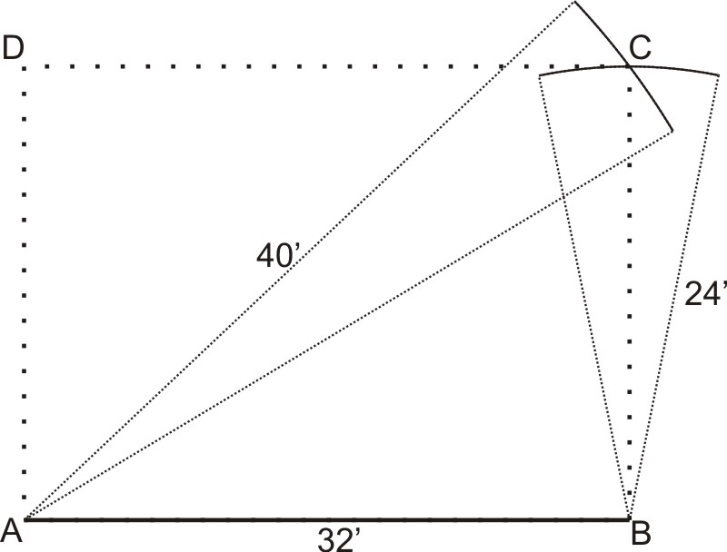

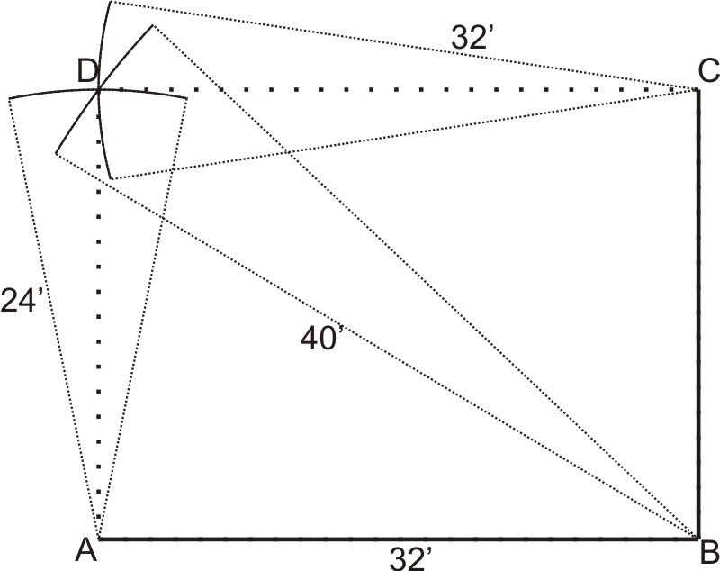

As you probably already know, the pythagorean theorem says the diagonal should be 40' exactly. When I do layouts, I first pick the location for one of the corners. Let's call this corner A. Then I pick the location of a second corner (let's call it B) along the long side (exactly 32' away in your case). That's the easy part. Now to find the exact location of corner C, I have my wife hold the end of the tape at corner B, and I walk out the right distance (24' in your case) to the approximate location of corner C. I stretch the tape tight and use my finger or a stick or some other pointy object and draw an arc in the dirt exactly 24' from corner B, using the tape like a compass (my wife being the point at the center of the circle and me being the pencil). You now know that corner C lies somewhere on that arc (since all points on the arc are exactly 24' from corner B) Then I have my wife walk back over to corner A and hold the end of the tape there in similar fashion. Since I know the diagonal is exactly 40', I now put my finger/stick/pointy object at the 40' mark and trace out an arc in the dirt with that radius. The point where the two arcs intersect is the exact location of corner C. Corner D is done pretty much the same way, but now you can check your work by drawing three arcs: a 24' arc from corner A, a 40' arc from corner B, and a 32' arc from corner C. If you've done everything correctly, all three arcs should intersect at the exact same point.
I used this technique to lay out my dressage arena (which is approximately 70' x 200') and all three arcs intersected within about 1/2".
Good luck!!
Josh

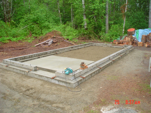

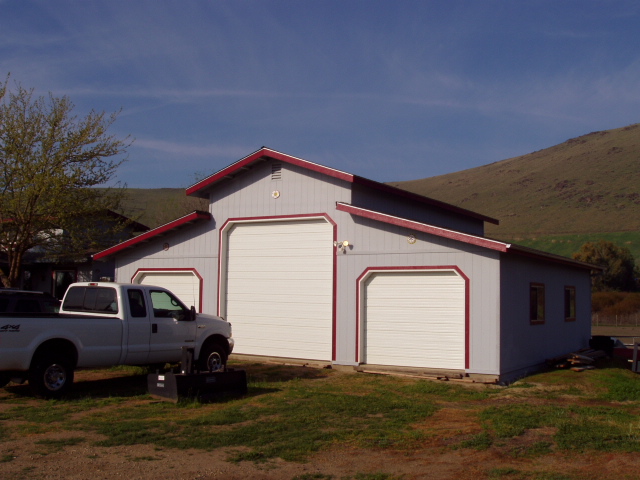

I think we are all giving the poster some very helpful information but some of these replys completely make my head spin. You are building a BUILDING, not a space station. Set it up and frame it using what working methods you are comfortable with. You say you have the given diagonal measurement so work with that, a framing square and the 3-4-5 (3' on one wall line, 4' on the other wall line = 5' diagonal between those two points) corner squaring method, all of which will get you four 90 degree corners with four properly dimensioned wall lengths. If you want more accuracy (as you should) kick up the 3-4-5- to 6-8-10 or even 12-16-20. When you hook your steel tape while checking the four corner diagonals, hook it as close to one of the tape's two tip edges as possible and then read the tape on that same edge plane for accuracy. You will probably wind up doing several sets of walk around adjustments until you finally get it right but that's o.k. it's your accomplishment to a complex problem using rudimentary building practices. Rember to do the exact same thing over again during the form board and stake setting phase. It's your last look before the pour.
Down the road a bit: After the slab is done, frame all of the exterior walls on the floor then invite your friends over for a wall raising and barbeque. Even the folks that have no experience in building leave with a good feeling and some new learned skills. My 32'x40' shop took about two hours to stand, brace and plumb. Good luck and keep us posted with photos.

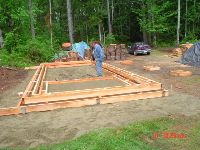

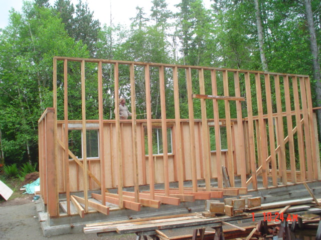

This is what I did for the chicken palace a few weeks ago. It is 12ft X 28ft. I laid out the corners, managed to get them fairly close to the right dimension. In pic #1 you can see I just laid out some board to get close to what I wanted. Then the cement guy and I put a steel tape to each corner diagonally, after about 15 minutes of adjusting we were happy with the result. We did have to measure a few times to get it just right.
Square foundation makes a square building most of the time. :laughing:
