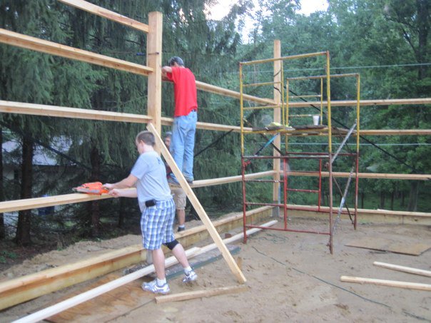

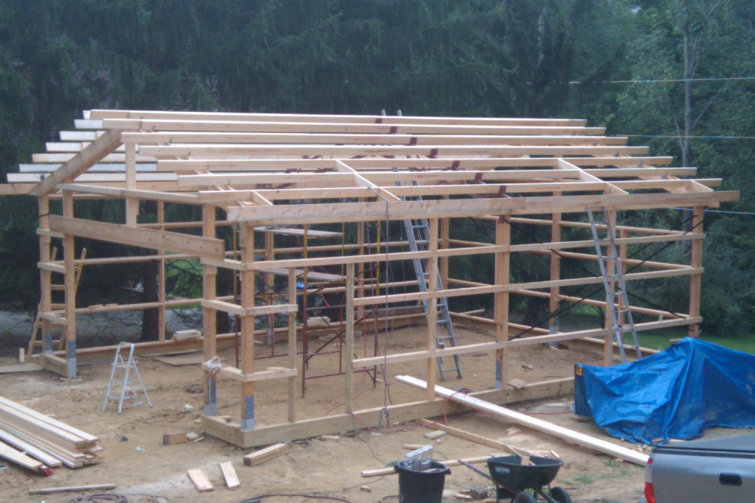

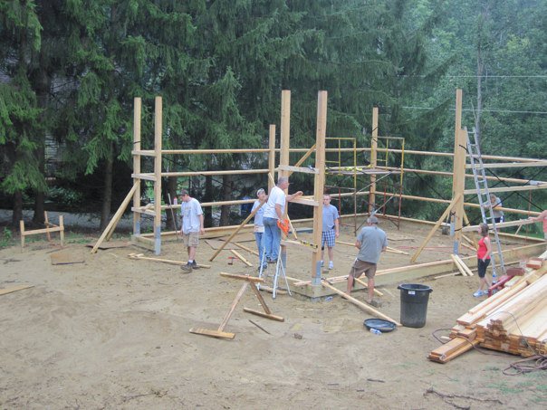

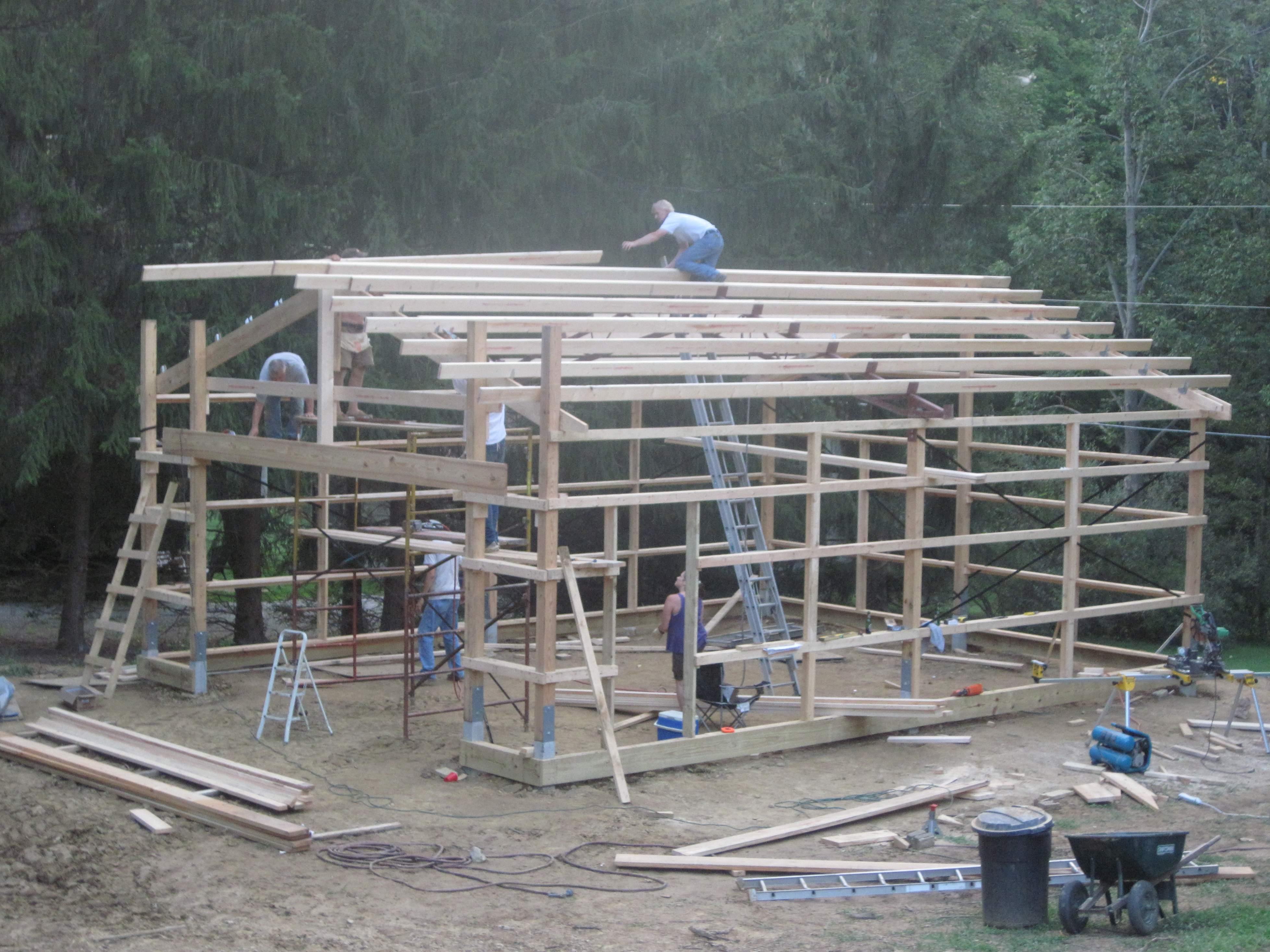

Well ... had some family and friends come in this weekend to do some building. Started Saturday morning and did as much as we could through yesterday afternoon.
I think we made pretty good progress for a bunch of amateurs in 4 days. Pictures attached!

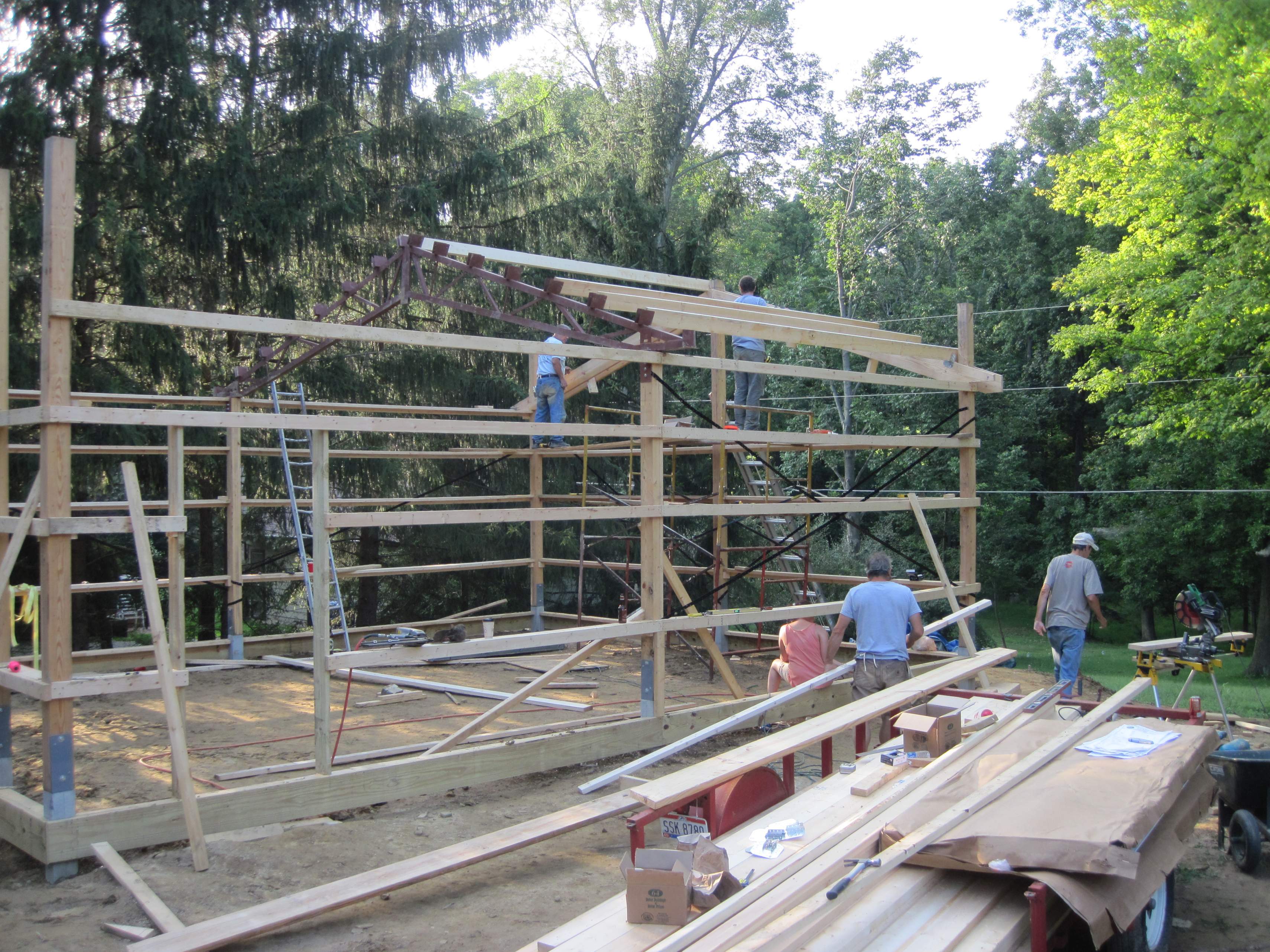

Looking good! Can I ask roughly how much you had to pay for that truss that holds up the center section? Were you guys able to man-handle it up there without any special equipment?
Also, it's hard to tell from the pictures, but are your purlins 2x8? 2x6 seems like it would be awfully small to span 16' at ~24" o.c.

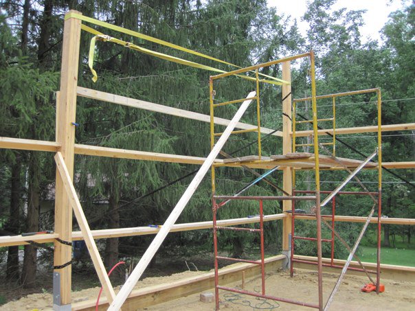

I'm also interested in that center truss. We are looking at building a 24x3?(30,32,33:D) barn for a horse and ???? So If I could get by with just one of those at a reasonable cost, tha would be great.
Also would be interested in how you connected your posts to the concrete "posts."

The truss came as part of the kit, I have no idea how much it would cost individually. Getting the truss up there was a bit of an ordeal. My neighbor has a big Case tractor with a FEL that wouldn't go quite high enough. It required some luck to get it up there. Along with a whole lot of nervous moments. That thing is extremely heavy.
The purlins are 2x6. From the peak down, the top 4 are 2-2x6's nailed together. We decided to put those spacers in the first three at the bottom to help hold them in place. The purlins are a little small, but up to code for our very stringent building code department.

Like I said in the previous post, I don't know how much those trusses would cost individually. I purchased my building from 64 Metals in St. Louisville (near Newark), I am sure they could provide you with a quote. They also offer free delivery in all of Ohio.
The posts came pre-made. They are call perma columns, there is a u-bracket at the top of the concrete that has two or three bolts that attach to the wooden part of the post. Prevents wood from rotting in the ground. On my building, it was around $500 to get perma columns versus a pressure treated post. I just did it for peace of mind ...
Perma-Column | What are Perma-Columns
The only thing I didn't like about the concrete is that they recommend you attach your grade board with a split drive anchor. I would recommend using a tap con. The split drive anchors took whole chunks out of the posts ...

I can appreciate the nervousness getting it up there. It definitely looks heavy from the pictures. When I erected a big homemade truss onto one of my barns I ended up strapping a 6x6 post to my tractor bucket, which I used as a "crane boom" to get the truss up higher than my loader's 11' reach.
As far as the purlins go, if they meet code, I'm sure they're more than sufficient.
I definitely like those perma-columns. Hopefully I won't ever regret the direct ground contact with the posts in my barn.
