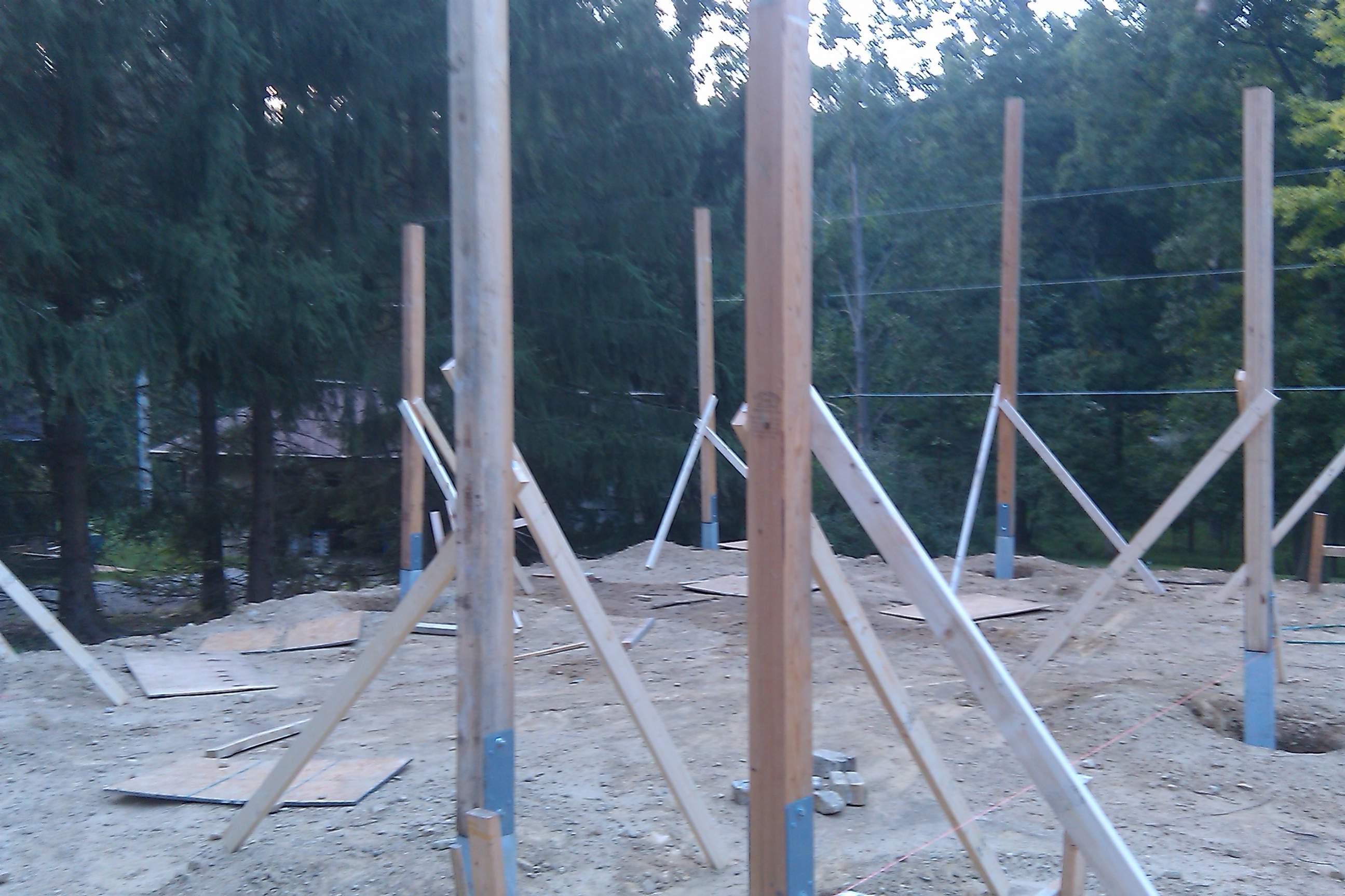

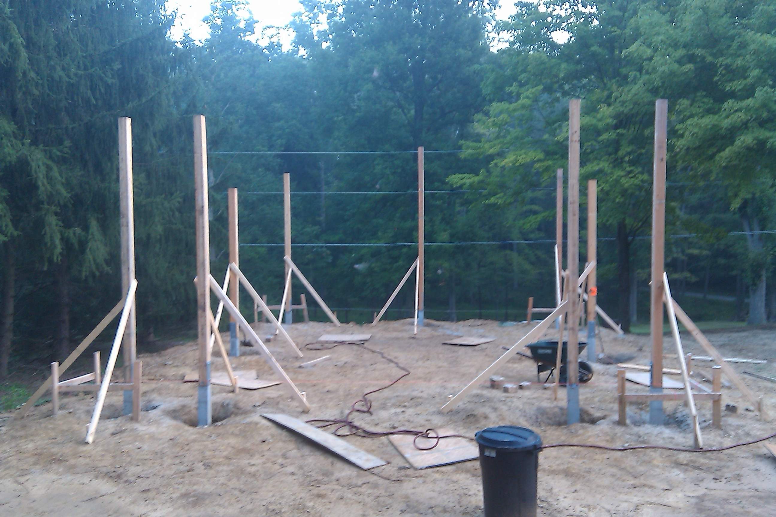

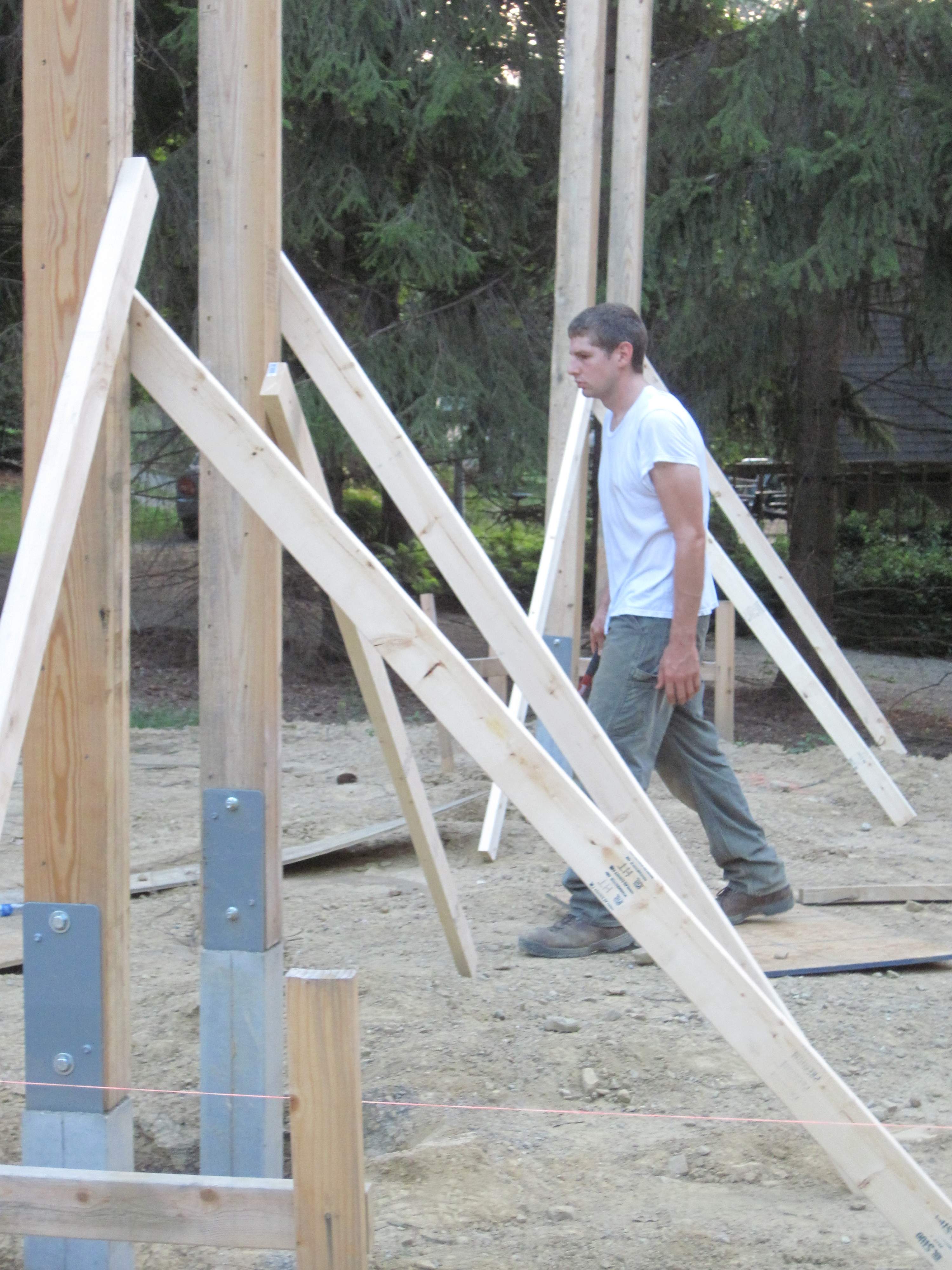

So here is a little update on my story ... since I know you all have been worried about why I haven't posted any progress ... :)
When I started this topic, I had the bob cat rented and eventually got string lines set and where I wanted the holes dug. We got all the holes dug and ready to go and somewhere during that process I hurt my back. I needed to have surgery. Had the surgery on the 2nd of July ... supervised the pouring of the footers around the 15th and I am finally recovered enough to start working again on this building.
Last night i got all the poles upright and the string along the east side of the building parallel with the house, I will then square the rest of the building from that string, get lines laid and then square up the poles... I am just very excited to have some materials off the ground! Anyhow ... pictures are included, I don't have any good pictures of the entire site, but I do have a good picture of my Aussie helper!
1st pic: from the south looking north. This is the front corner looking to the back corner
2nd pic:this is from the east side.
3rd pic:looking directly across the front of the building east to west
4th pic: Me walking back to the truck through what will be the garage door
5th pic: Aussie helper Kiah. 1 year old Australian shepherd.

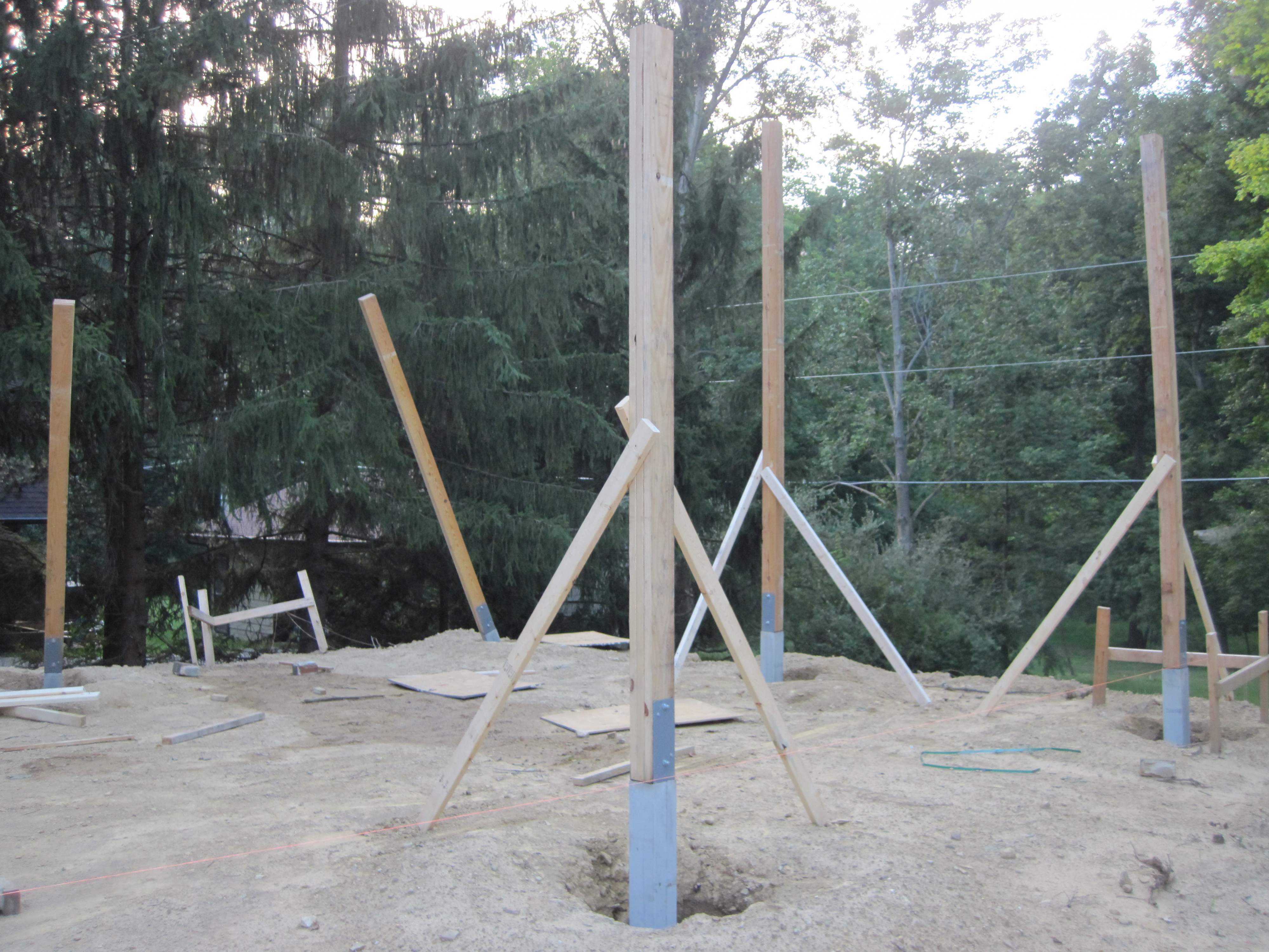

Last night with some help from my Dad and a friend, we got the posts set for the building. We used the advice from this thread to get things quare and got them cemented in! Thank you guys! Hopefully they are right :laughing:
Picture of the messy site is attached ... We finished after dark and were all tired and couldn't see to clean up really well.
