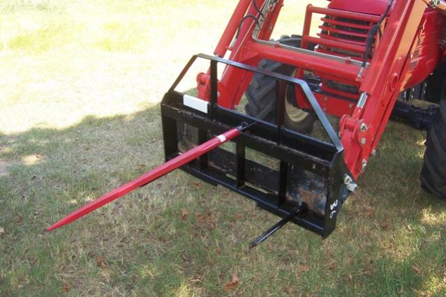

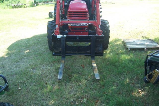

I bought the combo hay spear/pallet forks from them and they are very nice and do a great job. When I got them they were $595 with the free shipping.
Takes only a couple minutes to change out ... course if ya don't need the hay spear I think you save a 100 bucks.

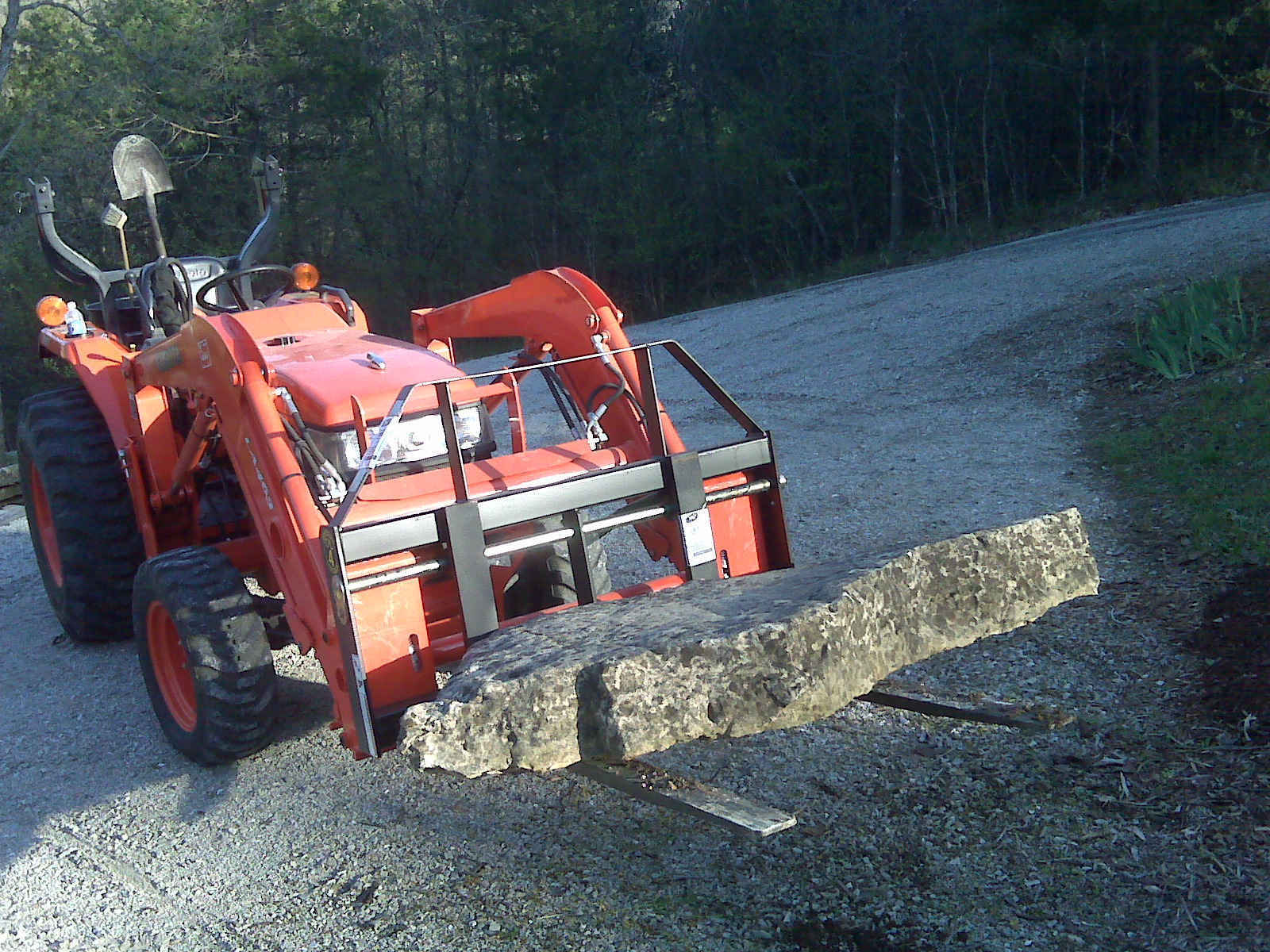

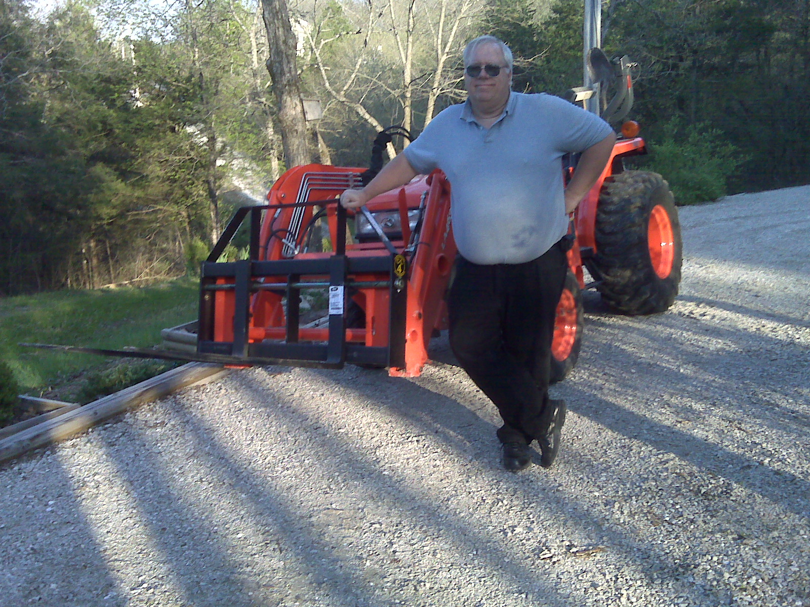

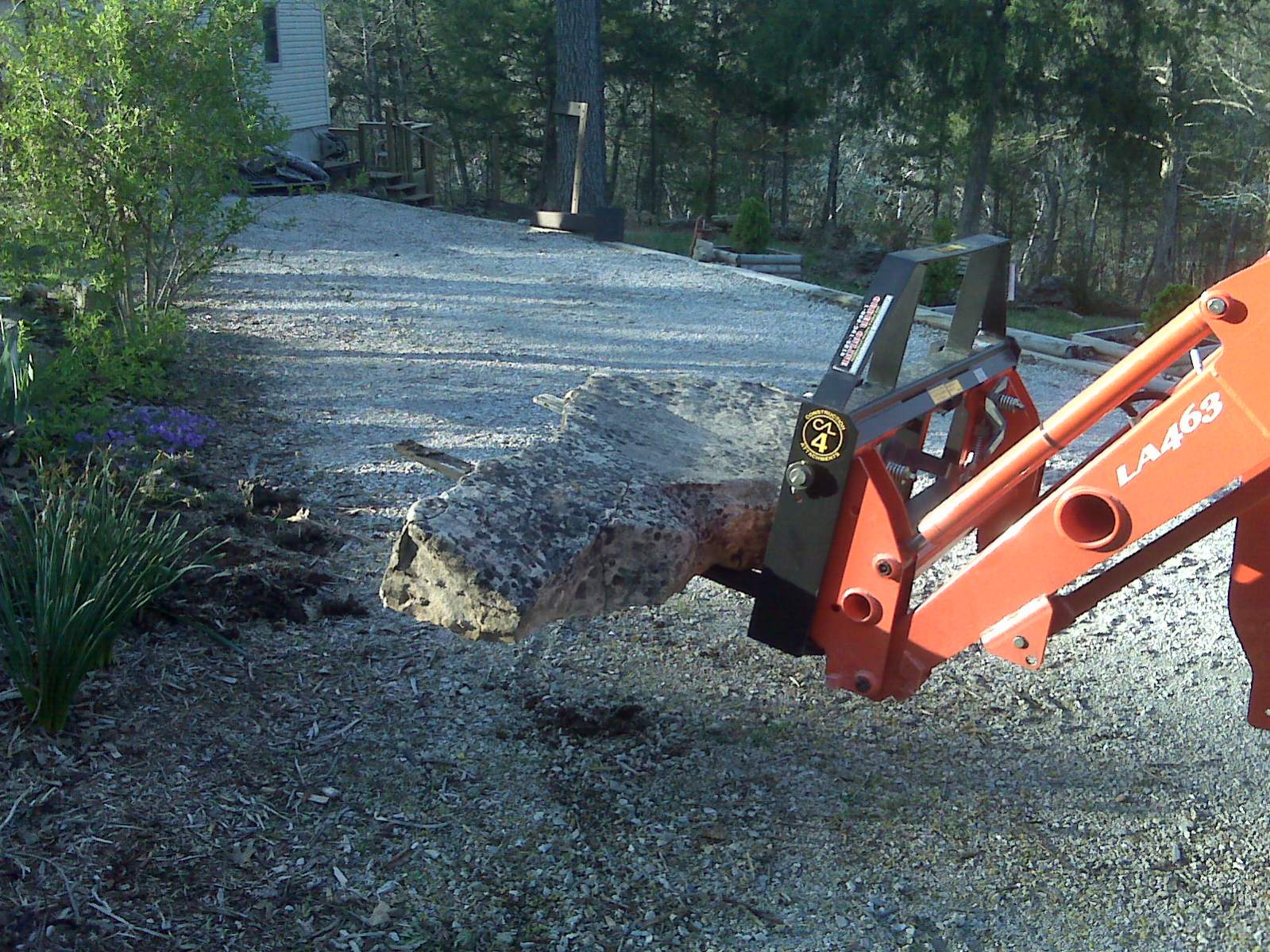

Only downsides I have found are when there is nothing on the forks (no weight) they will "migrate on the slide bar" as you travel on a sidehill and go over bumps. they never move when you have any weight on them but when empty they will slide some if you are sideways on a hill. They are not like those others above where you can put a hay spear on either, they do not remove easily from the frame, they are on a big slidebar that is greased. They are really easy to adjust by pressing with one hand on the upper portion and picking up a little of the weight with the other and sliding them one way or another. A child could do it.. Max weight is 1800 lbs. which is way more than my loader will lift, so no problem there. They are well constructed, and fit well, no slop with the kubota SSQA.

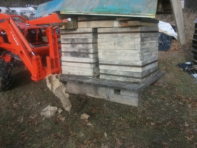

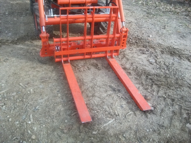

Here are some pics of a Q/A and forks I built for my LA402 loader which is very similar in capacity to the LA403 if not the same. The Q/A + the fork weight is less than 200#. The weight of the fire bricks on the skid is 800#. I weighed each size individually and did the math. You can see it is quite a long skid and the Q/A extends the forks about 3.75". Adding in the weight of the skid and misc lumber, I would guess you are close to 900#. I am pleased even though this was as high as I could lift it.
