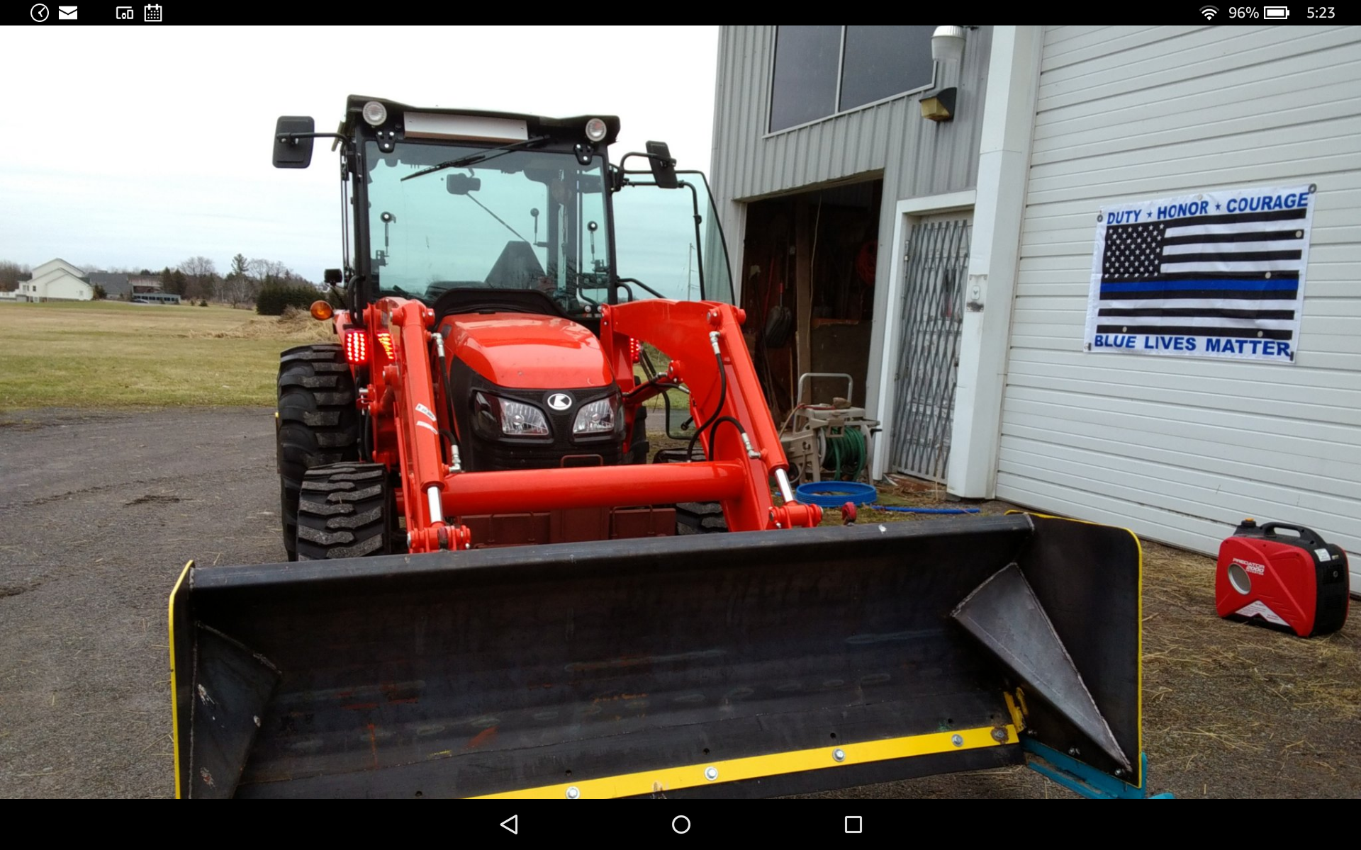

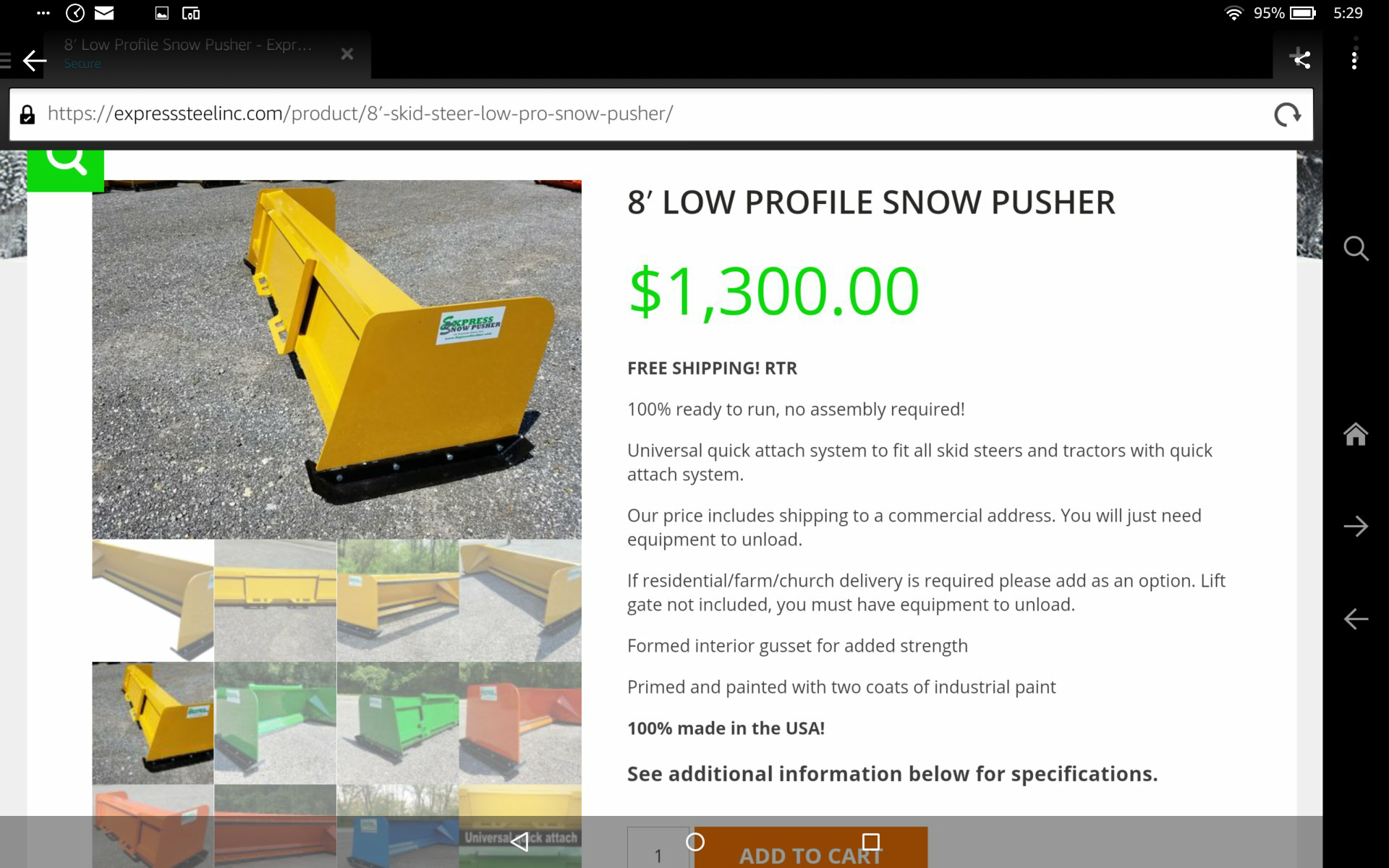

A snow pusher less expensive, no need for hydraulics. Also I have a Agrital aftermarket all glass cab. A nice feature for the MX.

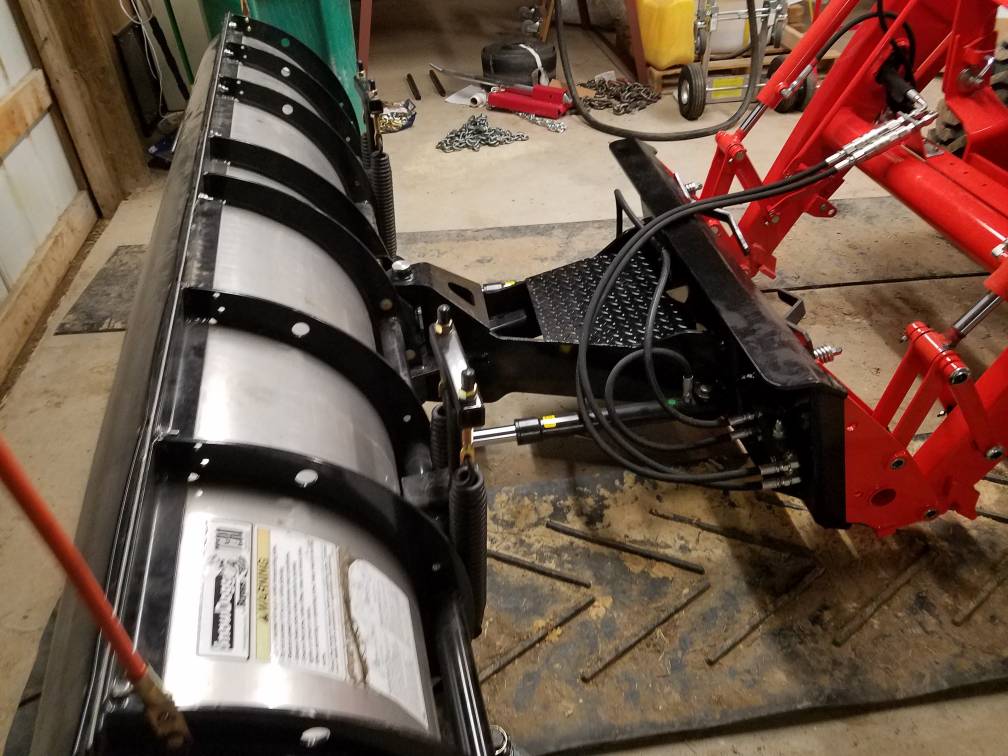

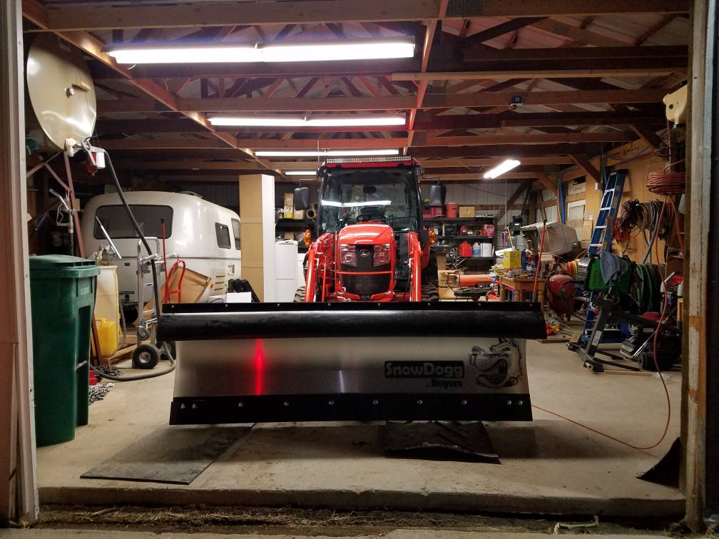

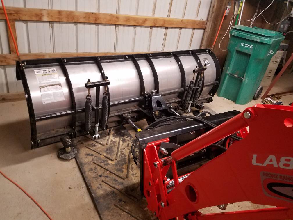

I got my 8' Snow Dawg in Denver, some place off Santa Fe. Pretty decent price, I want to say $3k or so. It is a typical SSQA blade, so doesnt have float. I was planning on using it & seeing if I'd need to reengineer float into the SSQA frame & the blade frame. It's been 2 winters now & I havent been motivated enough to try & figure out how I'd do it, much less do it. The past 2 winters have been pretty dry though. The small truck plow I built for my old L3200 had vertical float & 15-20 degrees of rotational float. So I know the value of having or not having it. All things considered I prefer float, but not enough to rebuild for it... yet.
I got it for the 2' forecast around Thanksgiving 2 years ago. Spent a good evening assembling it in 5-10 degree weather (need a torpedo heater to get the plastic bit ontop to expand so the holes line up). They only had a 8' in stock instead of the 7 I wanted. Again, I was figuring I could cut 6" off either side if needed. It might be a bit much for my L4060 in heavy snow, but hasn't been a problem yet. Oh, and after freezing my *** off getting it assembled, we only got 3".
All things considered, get one that's more compact. The farther out the plow is in front, the worse steering & stuff is.
Just a few opinions & experiences from down here in Parker.20170110_213656-1.jpeg20170109_181006.jpeg20170110_213650.jpegIMG_20150117_153817.jpeg

It was a better price than other new ones I could find & I like the idea of the stainless not rusting. It was actually competitive with finding a nicer used truck plow in good shape. Used plows around here seem to be nearly new pricing (often unrelated to condition), and/or the plow is beat to heck.
There are some cheap import blades around that are really compact. They have 1 double acting cylinder for single instead of 2 single acting. It would be harder to retrofit blade float into that style & they are built a lot lighter. So I stuck with a truck style blade & frame with a SSQA mount.

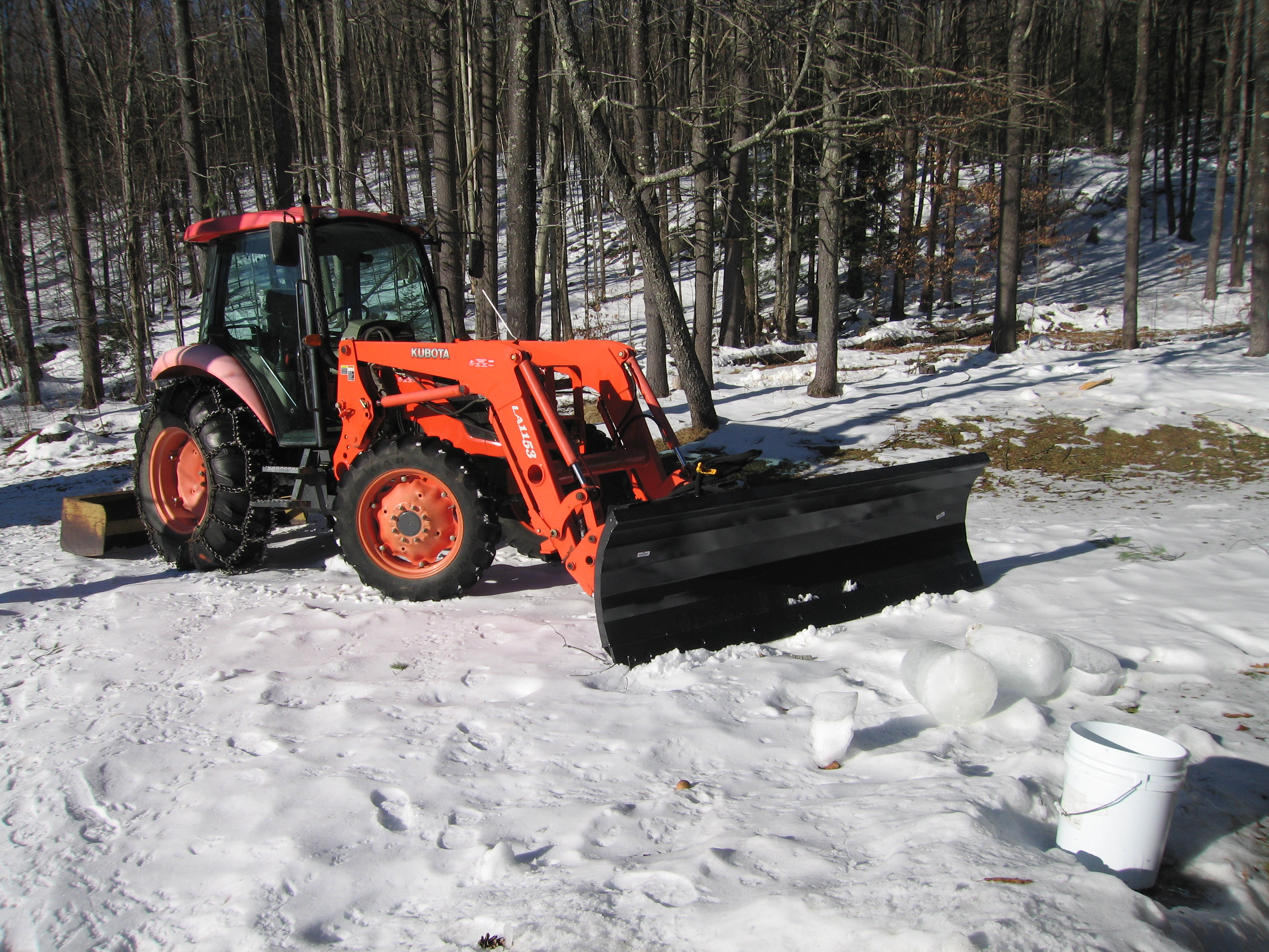

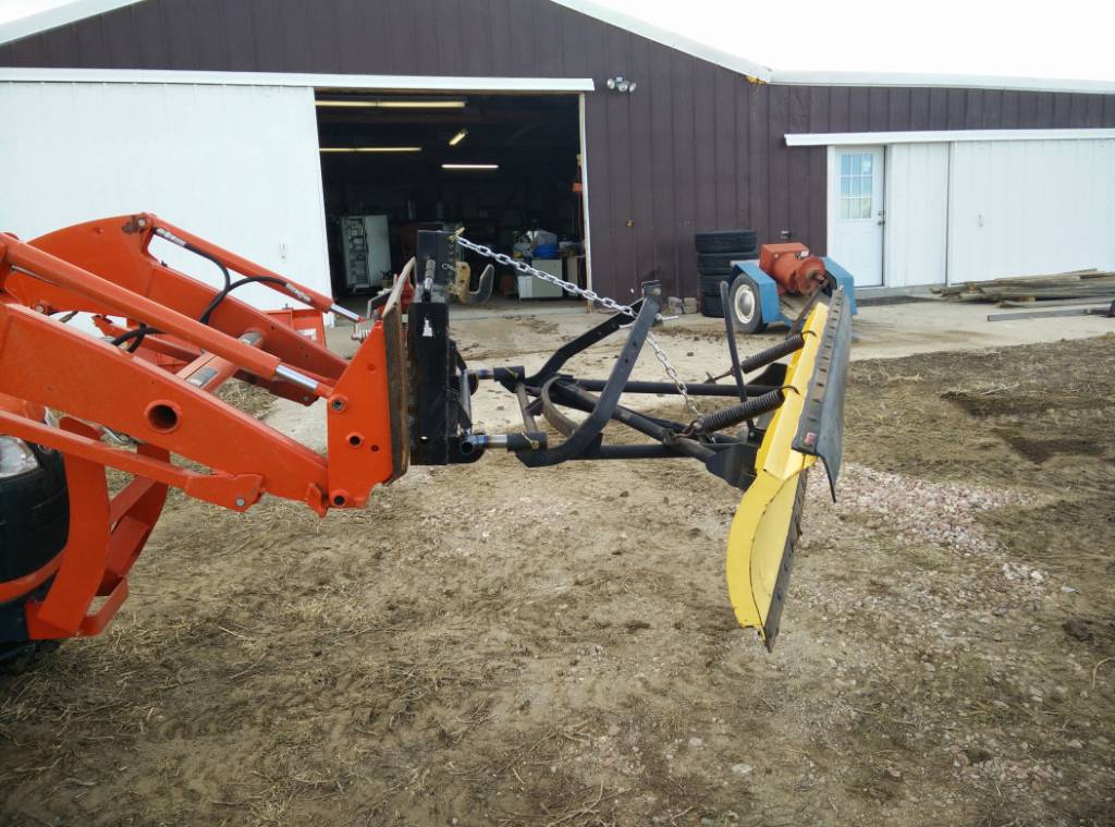

I converted a meyer truck front blade to fit SSQA. As mentioned earlier, the float function bears a lot of weight on the blade. Need large shoes.
I later added 3pt brackets and now use it on the rear of my 3o10. Floats a lot better but is a pain having to push backwards.
I think the answer is to build the float function into the mount as a Meyer blade is originally.
