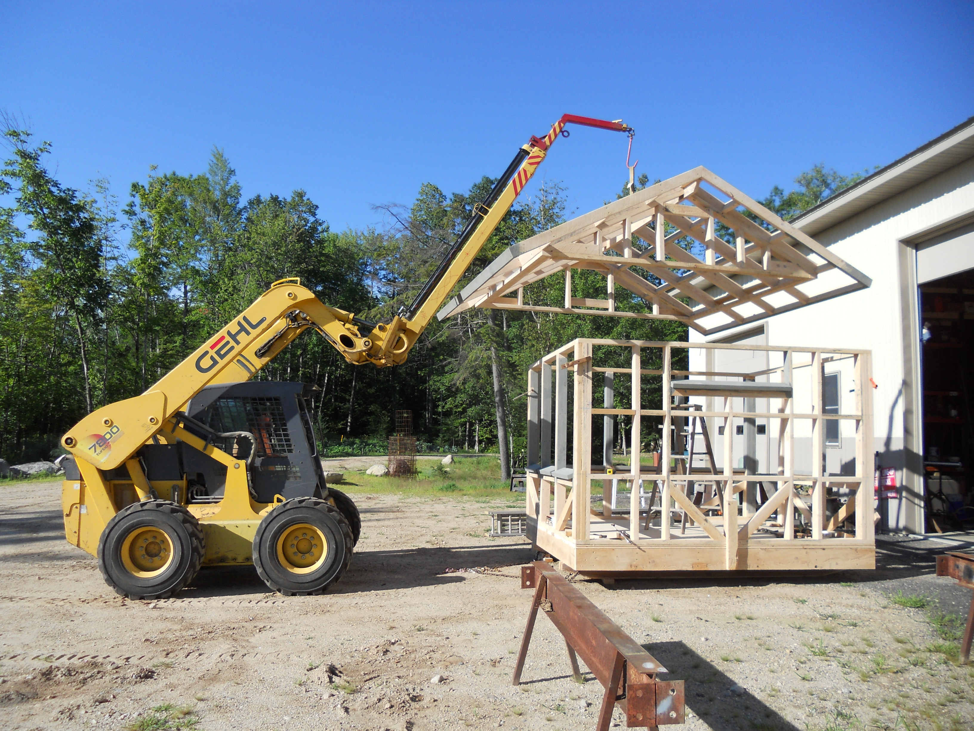

Thank you. I modeled it after a couple of commercially available ones. With the exception of my movable hook instead of one permanently welded to the end. I think the tractor will give up before the boom pole does.

You could set a few trusses with that setup.

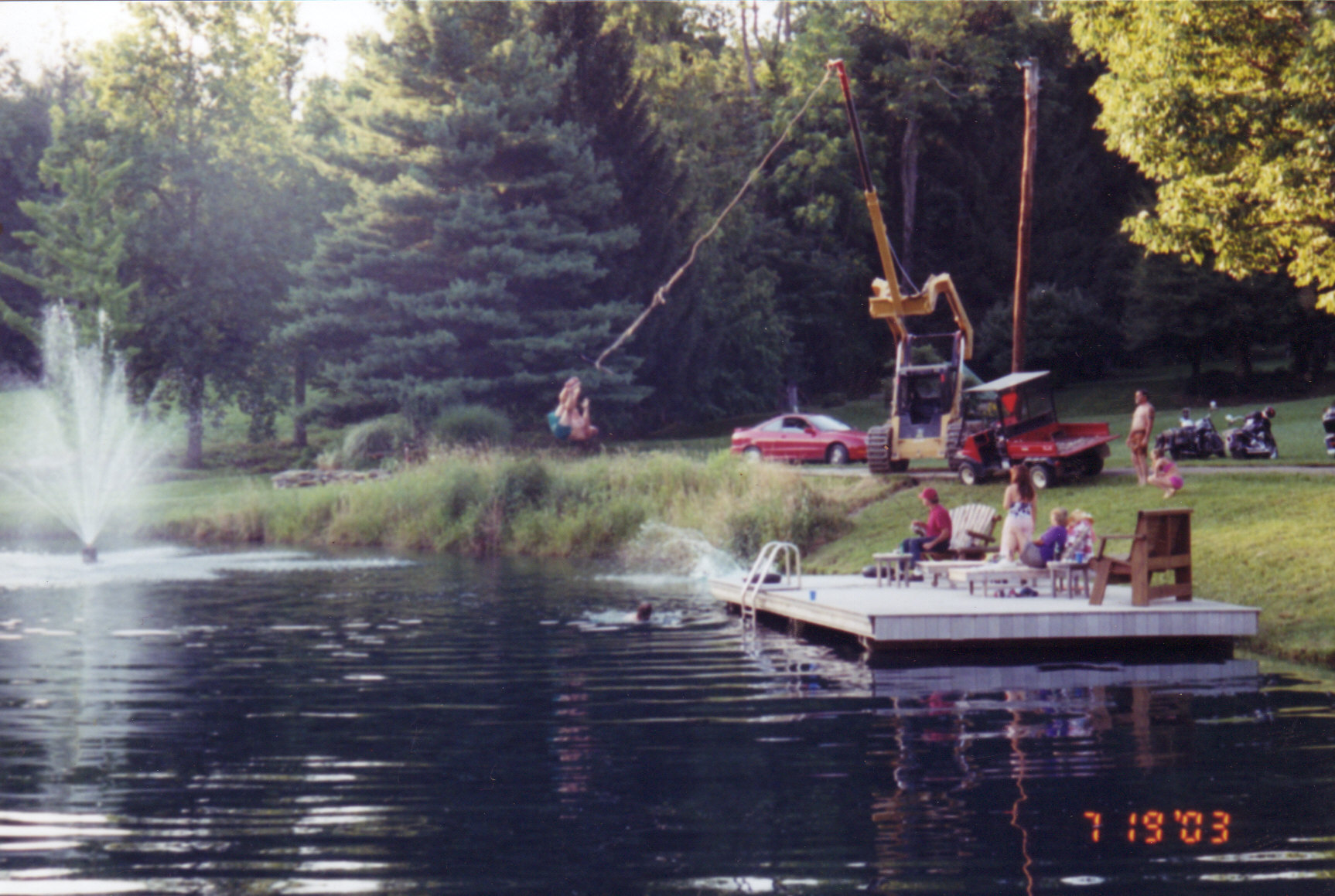

Just for ideas, here's one I built about 12 years ago, only because I found a looong cyl. for cheap and had to find a home for it.:D
Makes a good artificial tree for a rope swing also. :laughing:
