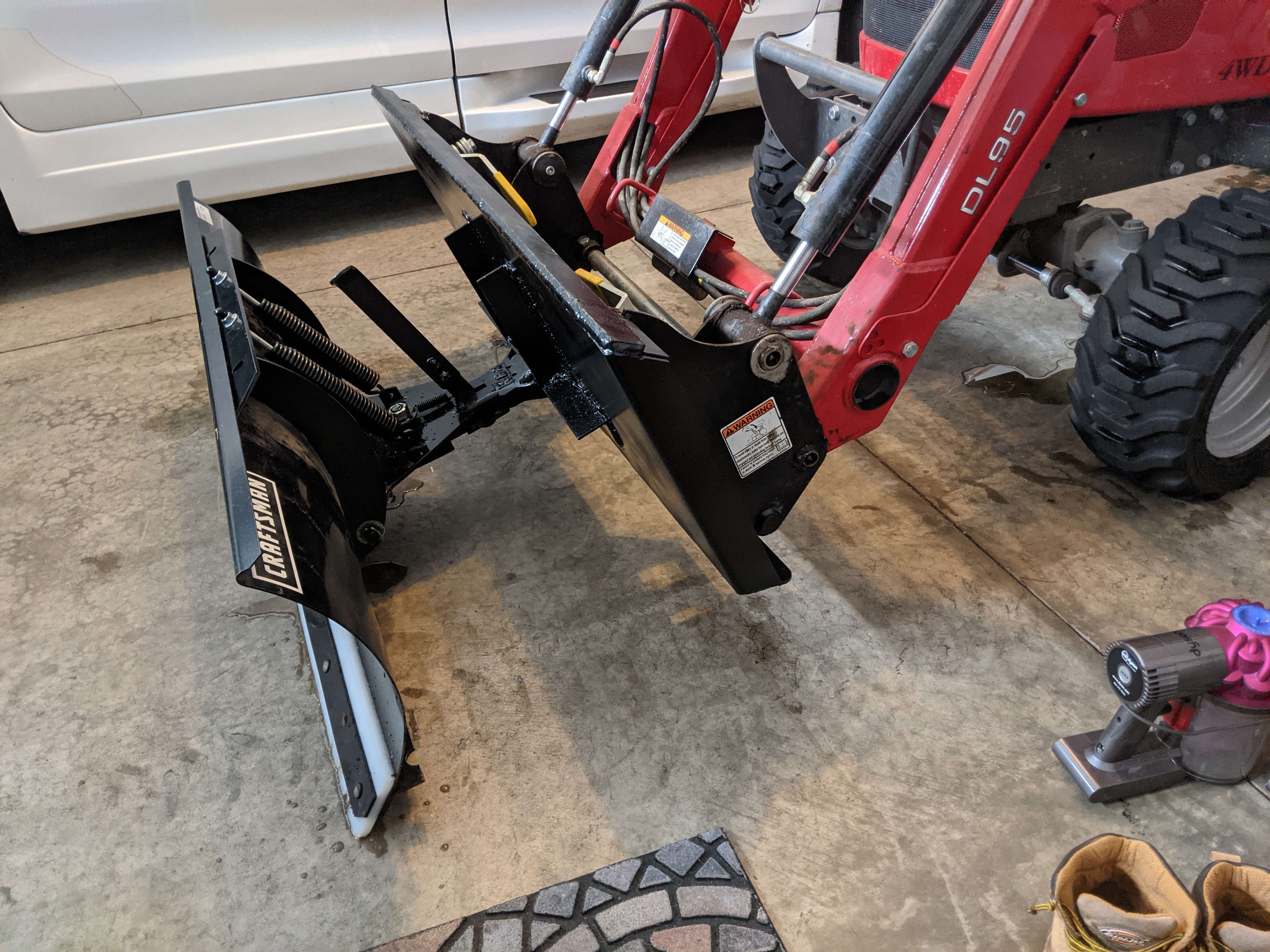

Well guys, I finally got a chance to try it out today. Only a few inches of snow, but it got soaked with rain overnight, so kind of heavy. Well sorry to bust some bubbles here lol, but the plow did not turn into a pretzel. :dance1:
I was a little worried before that the blade wouldn't sit flush with the ground when angled. What I did was loosen the screw at the pivot point where it angles, and then yanked the plow up and down a bunch of times on each side to loosen the bracket at the pivot point, allowing for more play (up/down and side). This allowed the blade to float even more, so that's a win overall. Plow did great.
View attachment 681517 View attachment 681516
Gene, Glad to here your SSQA plow system finally got some plowing action, good job !
For those that see the water glass "half empty", please give it a rest because you are not helping Gene.
And some are saying your plow blade does not have a trip system, I have a difficult time seeing now a days and I can even see the 2 large "Trip Springs" and the round pivot rod...
KC

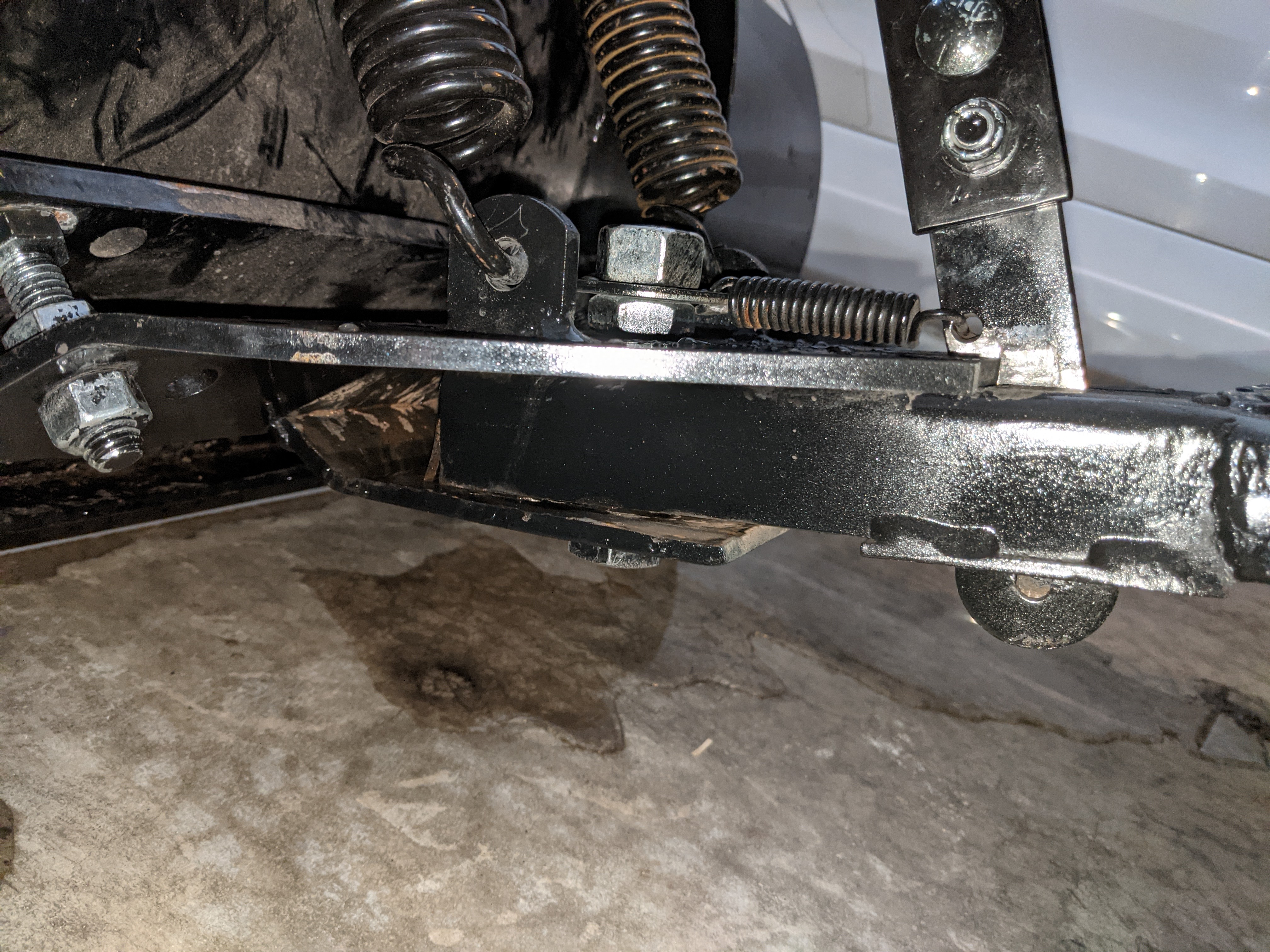

Thanks KC. No worries about the naysayers, it's just background noise.
And....
**TRIP SPRINGS**

I've used it 3 times now actually, twice on mine and also did my neighbor's paver brick drive. I have the blade float, not the loader, it's been out working great.

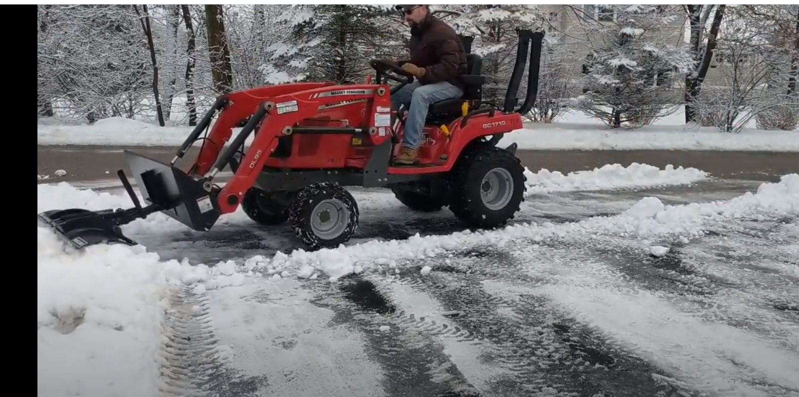

This was the first big snow, cleared my and neighbor's driveway.

Good video Gene. My turn Tuesday, got my min mount plow on this afternoon.
