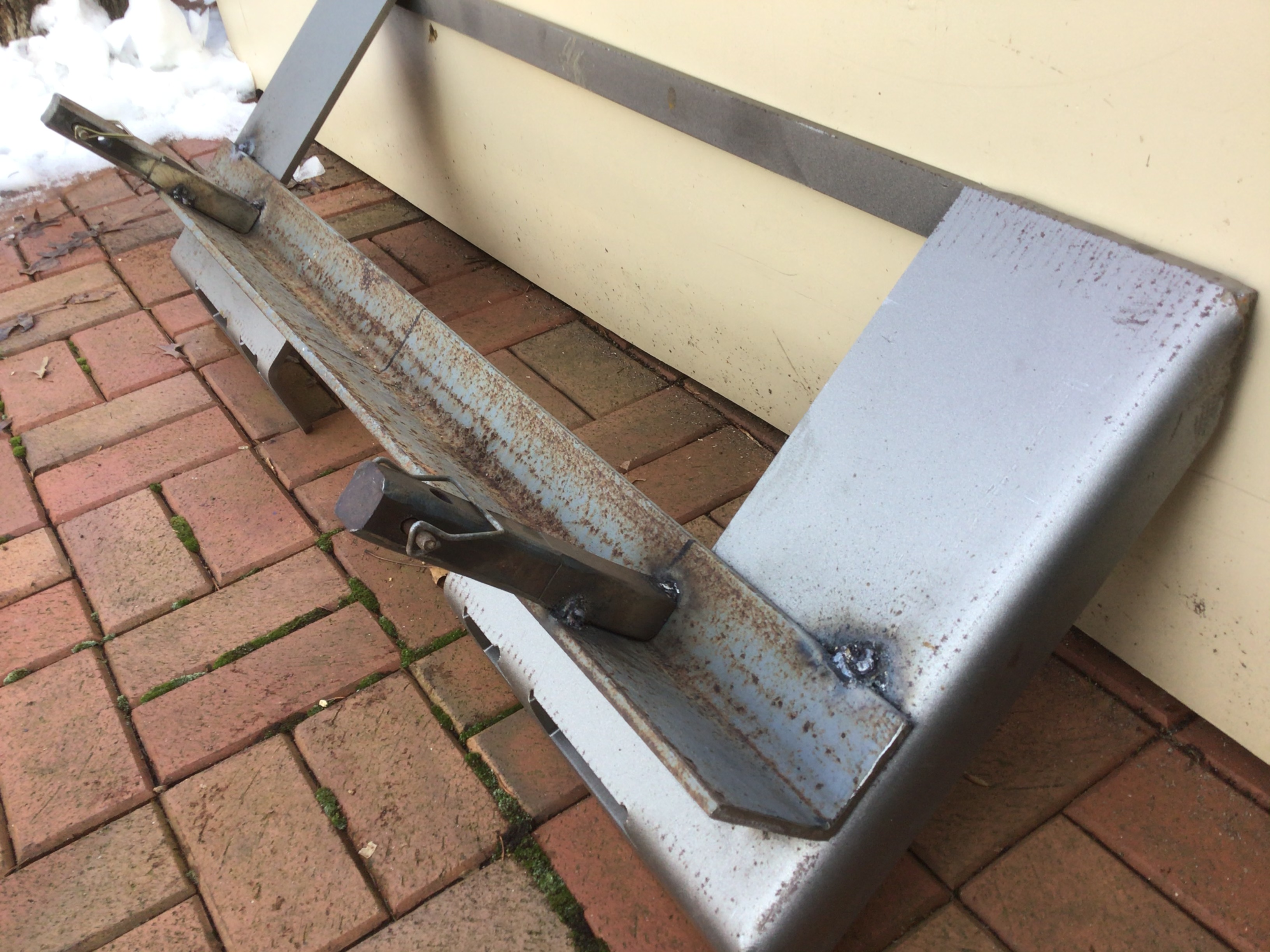

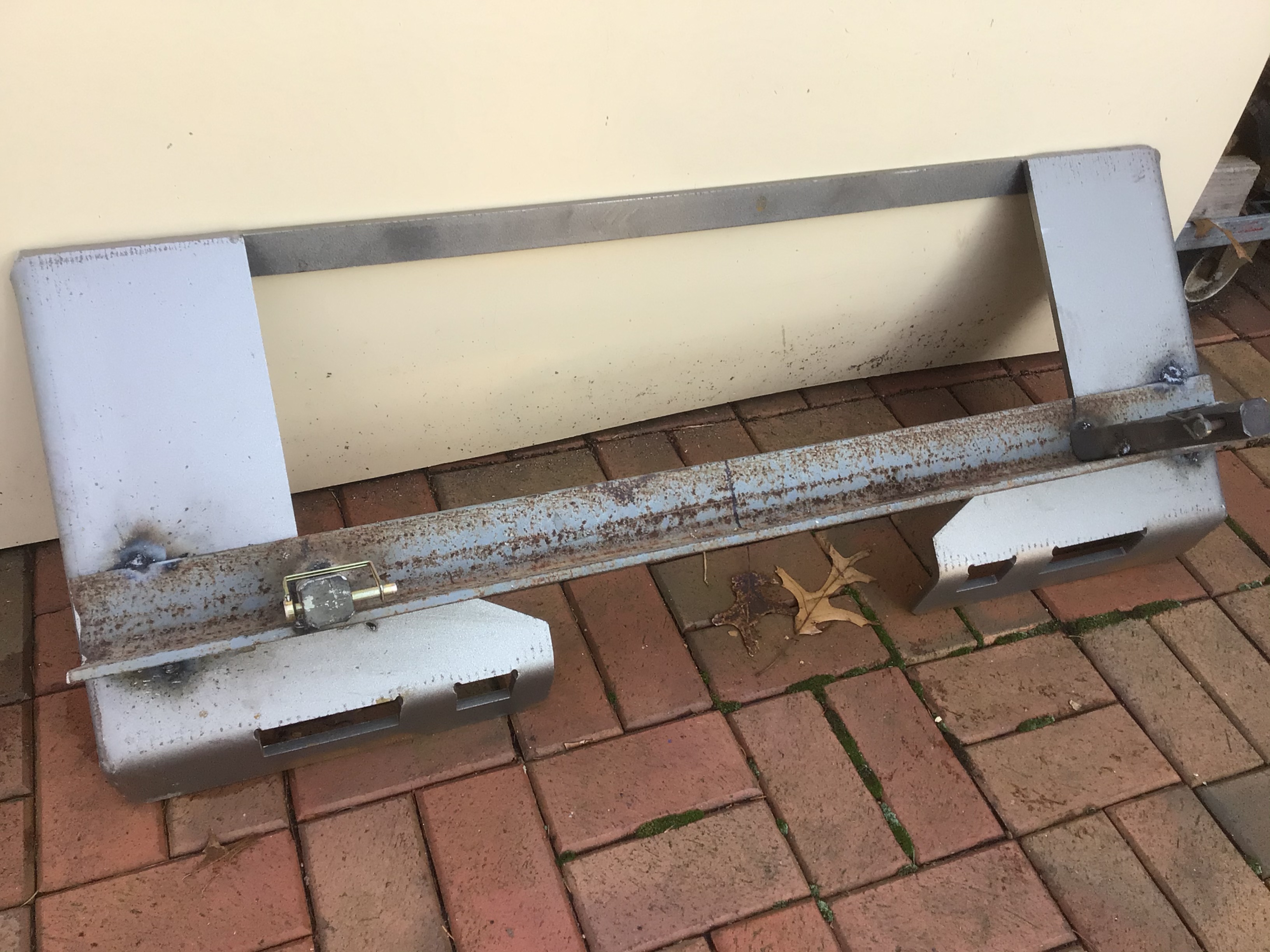

I'm in Erie Pa. I was looking at the titan plates for sure. You can't beat the price. I am thinking probably the 5/16" plate or possibly the 1/4". I am going to fab it up so the plow is held on by a large set of pins and will be removable from the plate. I've got the idea worked through in my head, now I just need to get it started. I really am impressed with the flexibility of the ssqa mounting system.

Unless you already have multiple attachments that can be modified to fit your tabbed plate, you'll probably never remove the blade. But I like the tab idea in case you get a different blade.
Yep, SSQA is a brilliant idea.
As the OP is already mentioning, you need flexibility in the mount system to allow the blade to follow contours. When the blade is sitting on the ground the attaching beam needs to be horizontal. If not, when you angle the blade, one end will go up, one end will go down. Very, very important.
To best manage that, I suggest you design the bracketry so the blade sits flat when your bucket level indicator says it's flat. Makes it much easier to return the curl function to the correct position each time it's moved.

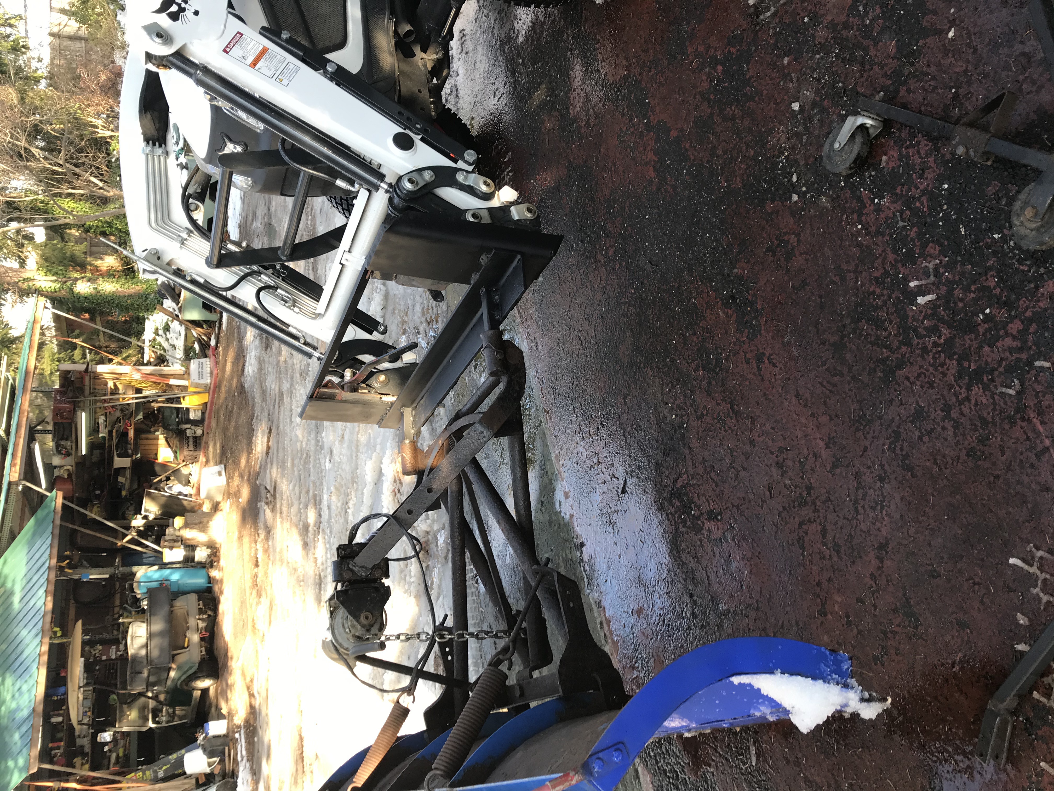

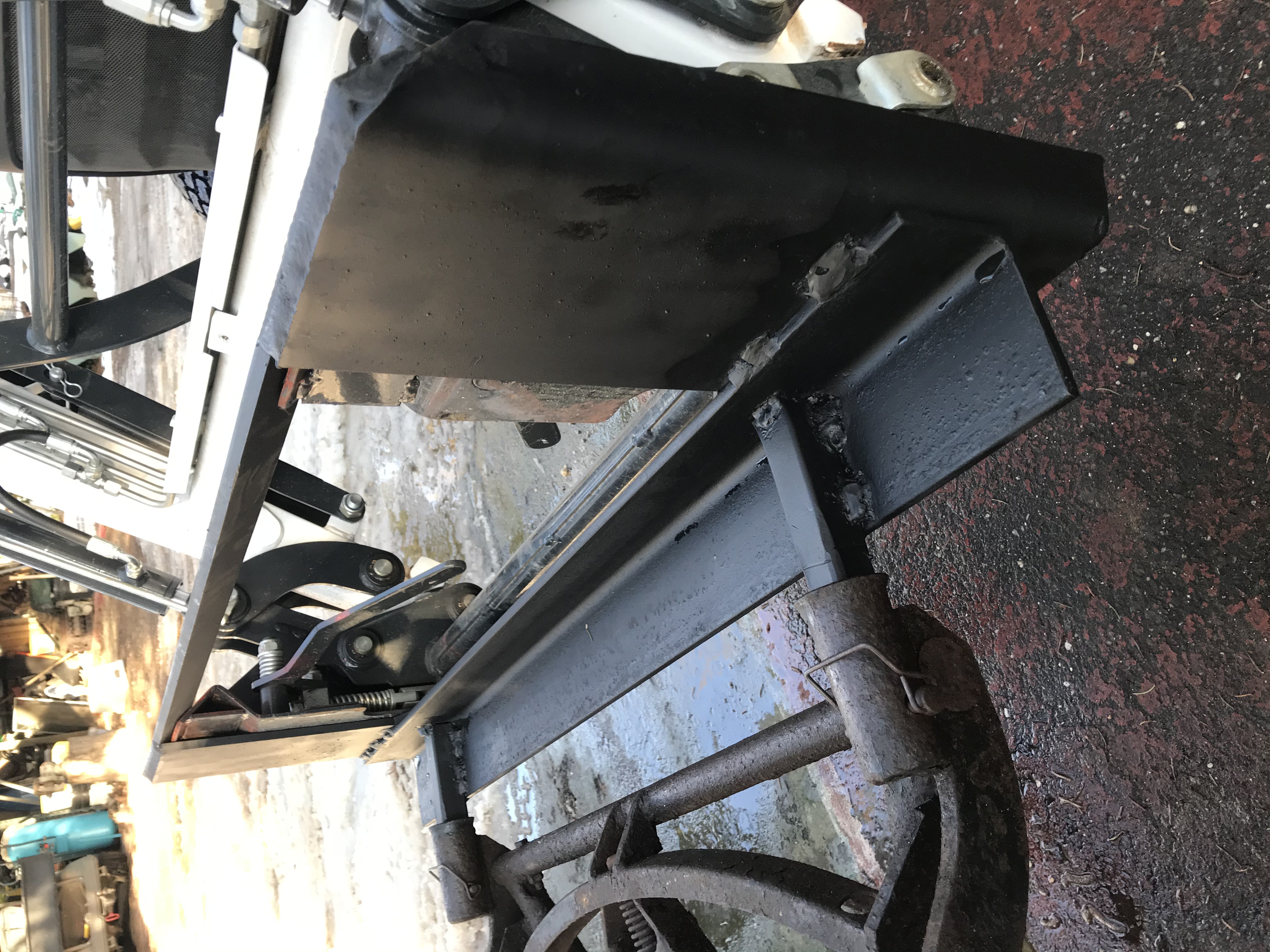

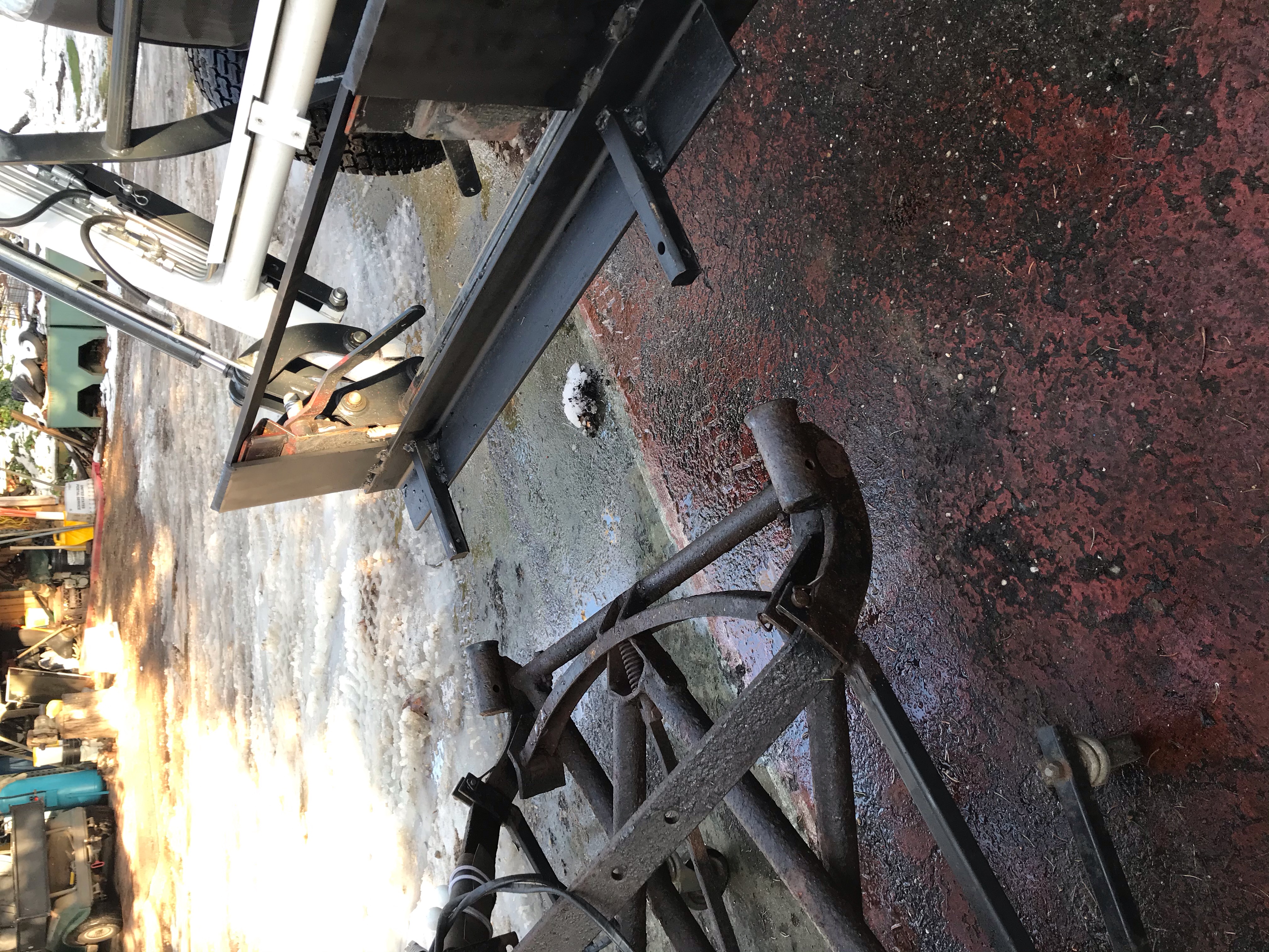

Well guys, I finally got a chance to try it out today. Only a few inches of snow, but it got soaked with rain overnight, so kind of heavy. Well sorry to bust some bubbles here lol, but the plow did not turn into a pretzel. :dance1:
I was a little worried before that the blade wouldn't sit flush with the ground when angled. What I did was loosen the screw at the pivot point where it angles, and then yanked the plow up and down a bunch of times on each side to loosen the bracket at the pivot point, allowing for more play (up/down and side). This allowed the blade to float even more, so that's a win overall. Plow did great.

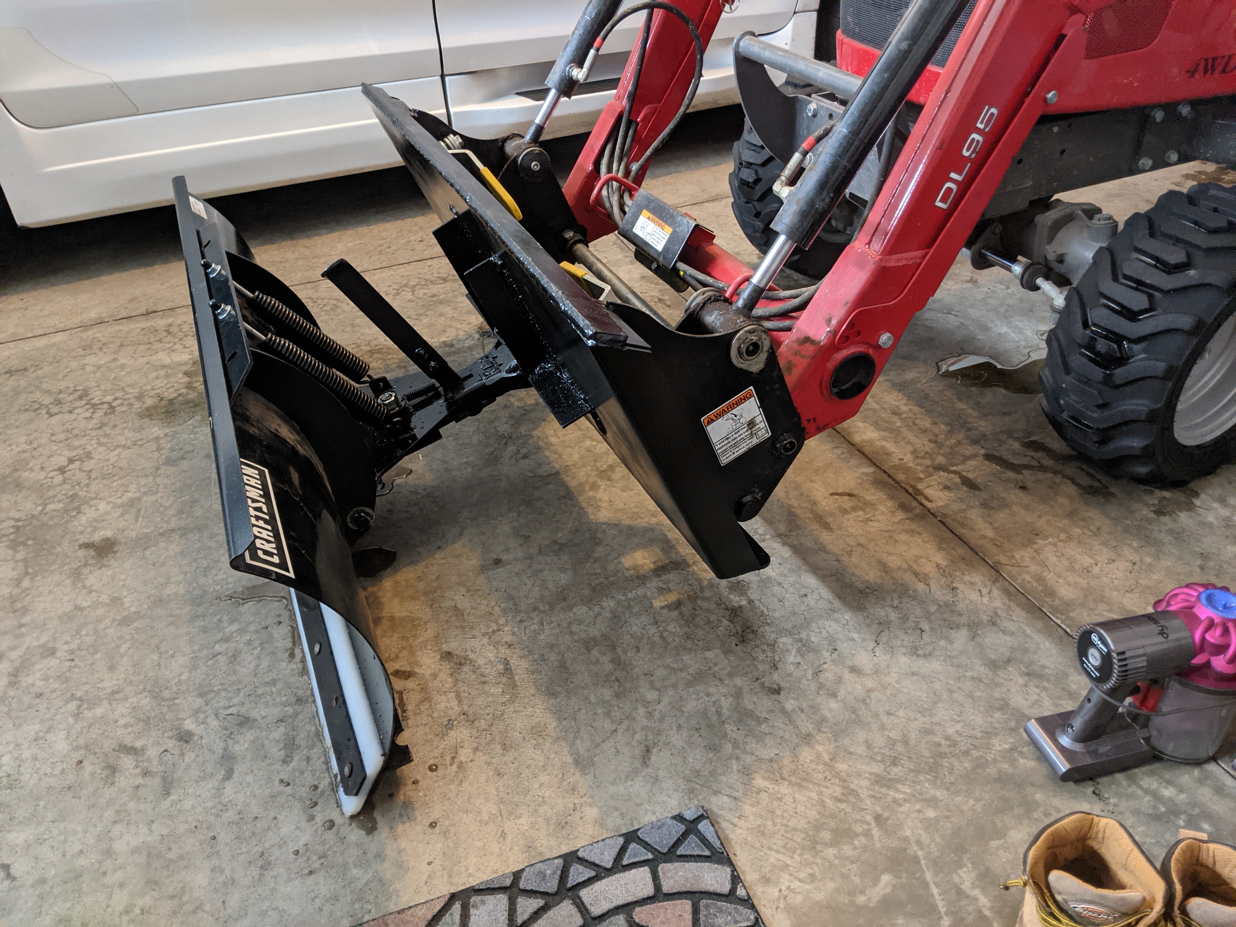

Well Thanks guys
You all inspired to set up a plow for my tractor.
Tac welded for fitment then welded it up. Worked good

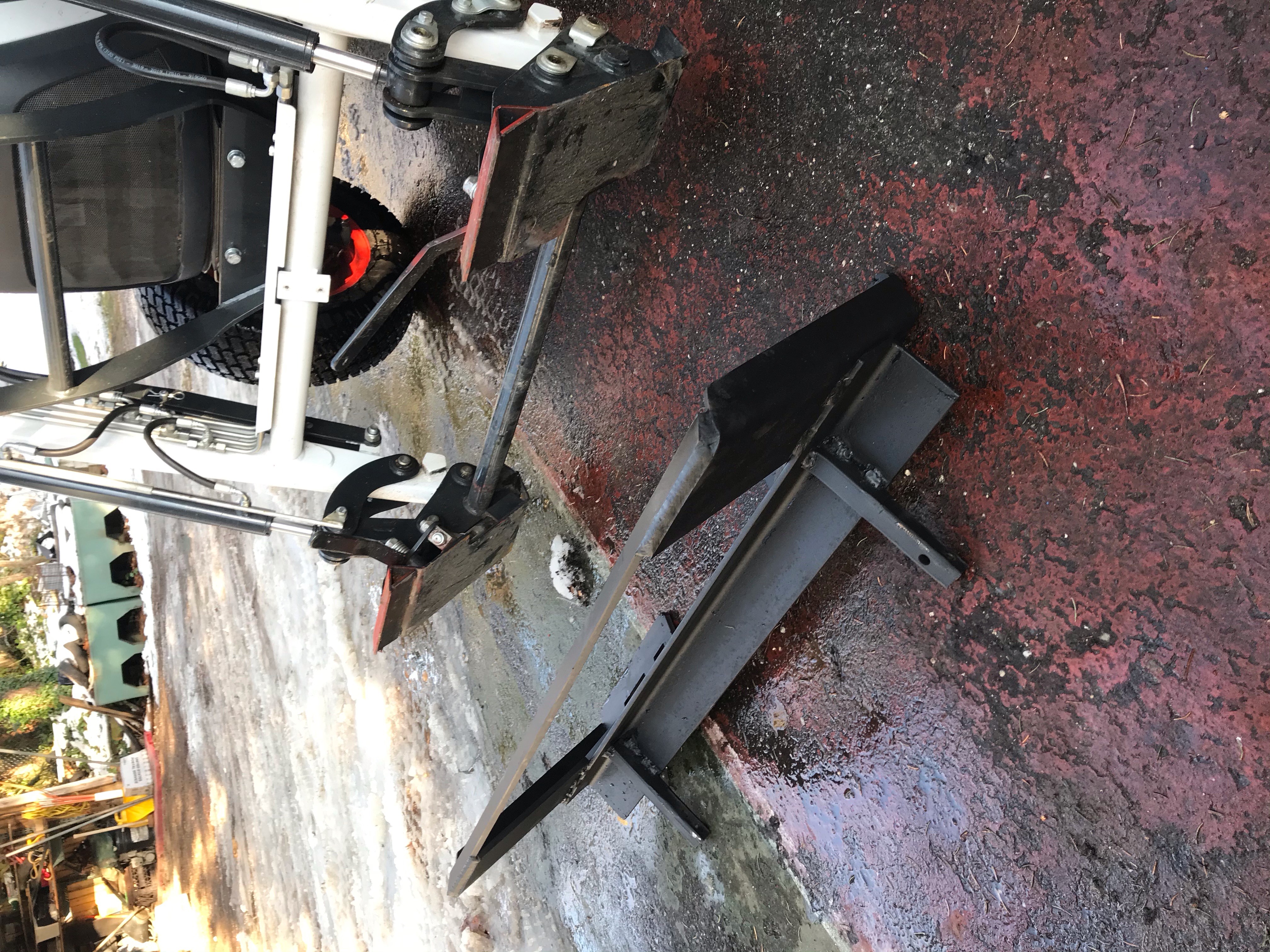

I am in the midst of building the “underslung” version using a Titan plate. Im trying not to spoil the story because I intend to post a storyboard when complete. More or less a hybrid version of a few others builds on here. It’s mocked up and tack welded together, so it’ll be functional very soon! My criteria went something like this...
- I used a 1/4” plate because Titan was out of the 5/16”
- I live in Western mass and see roughly 60ish inches of annual snowfall
- I intend to plow a 100’ stone driveway and a 40’ paved driveway.
- My tractor is smaller than most on here so weight was a concern (L3200).
- I’ll be carefully pushing a 7.5’ Fisher plow.
Best of luck with your build! Be sure to take many photos!
