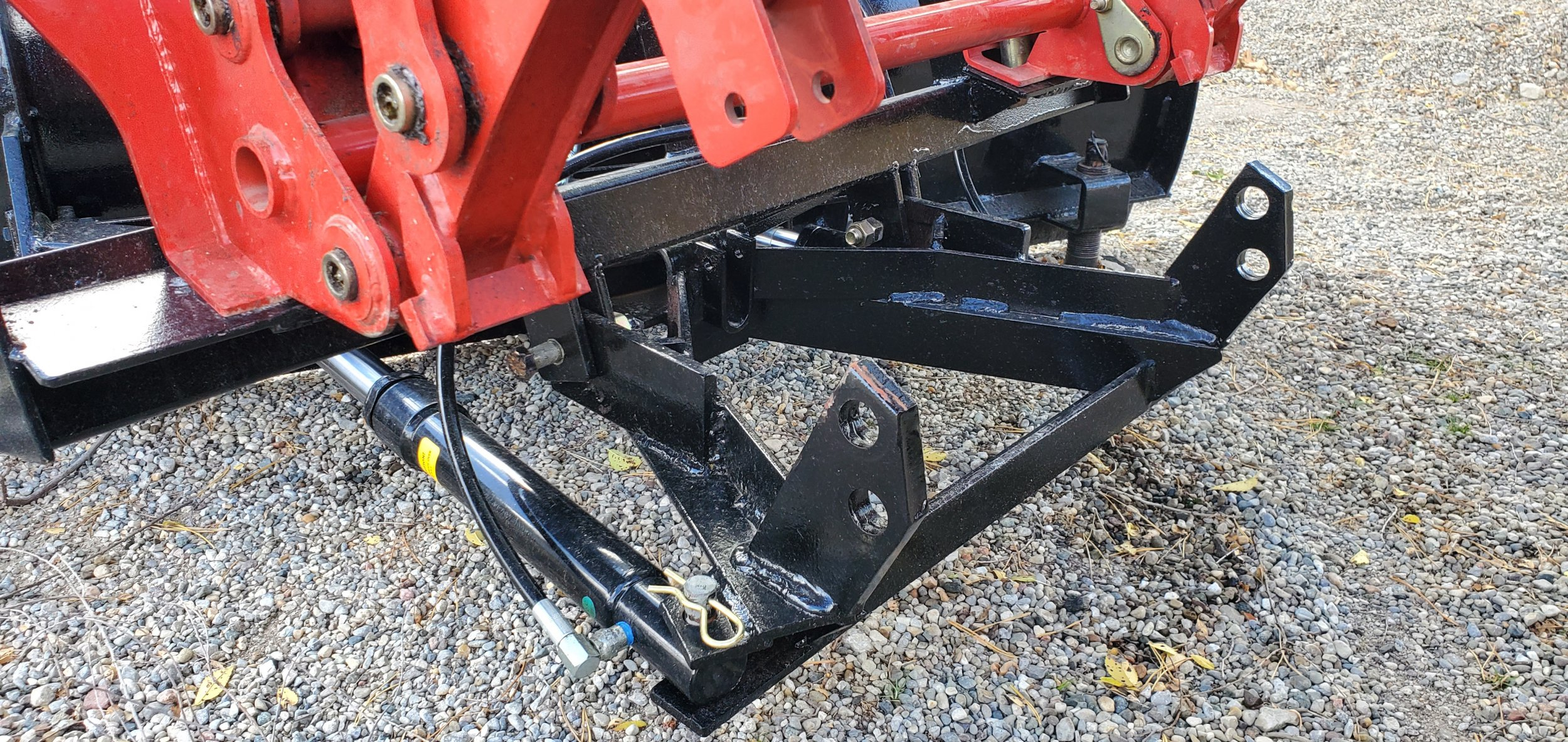

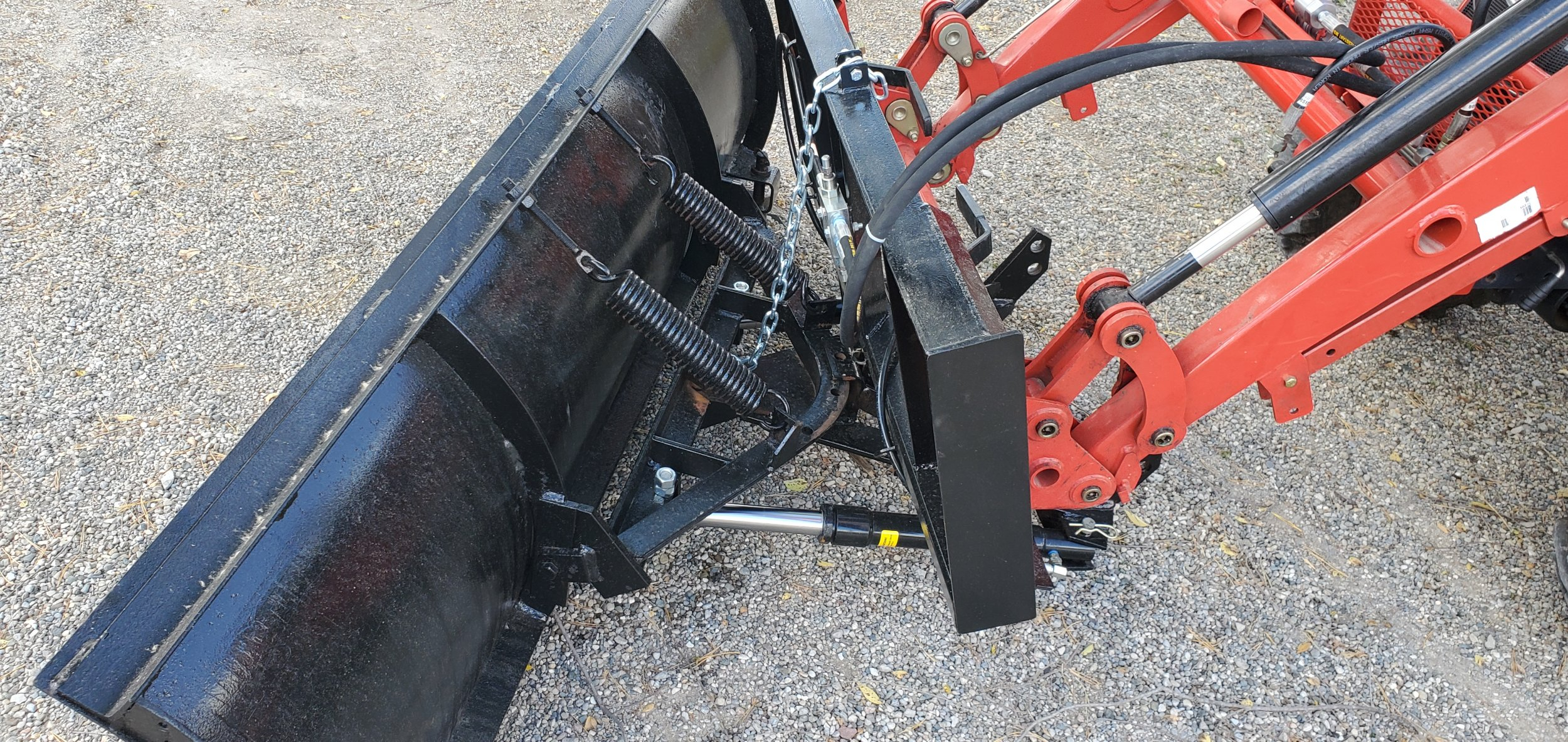

amhicks21 is right. If you have electric 3rd function valves (full on/off) you will want restrictors or your plow will really slam on angling. I used 0 to 5 gpm needle valves from Surplus Center. They work well on my M5640 tractor. I also used a cross over relief valve for SC. Plow cylinders had a warning not to exceed 2500 psi all over them. My tractor runs at 2800 plus when you push into a solid bank or hit something you will want hydraulic relief to protect the cylinders.

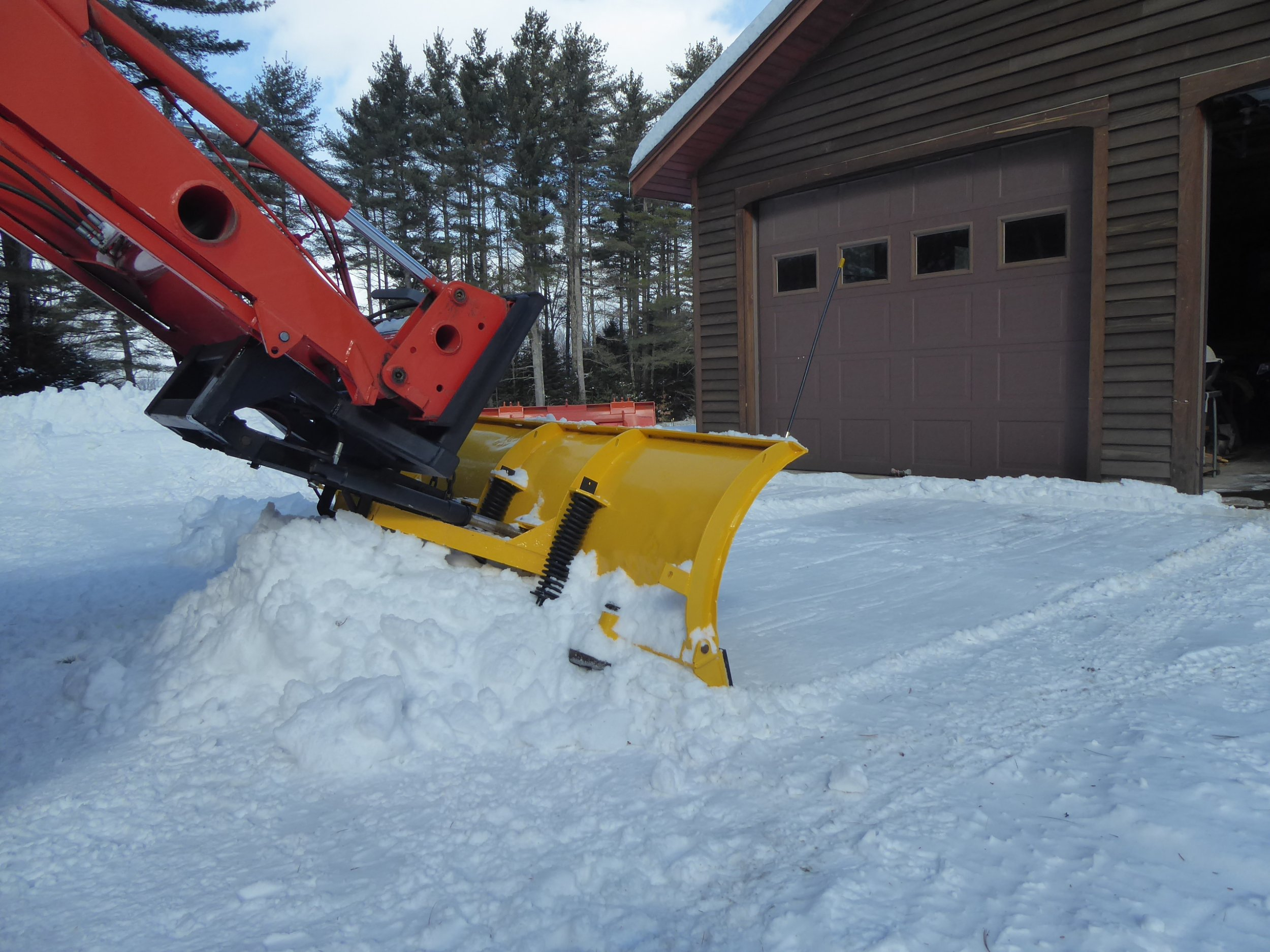

Gordon,
Very thoughtful mounting configuration that reduces the plow's leverage on the tractors loader arms.
Well done.

Gordon,
Well done.
Thank you - but I can't take credit for the idea, I stole it from TractorNH. He posted this thread
I works very well though. The plow floats the same as a truck plow but I can also get hydraulic down pressure for back dragging.

Occasionally I run across some good well thought out work on TBN while trying to be helpful to others. I see you improved on TractorNH's design by adding gusseting at an obvious weak point.
We all get better by standing on the shoulders of the ones who go before us so long as we are willing to listen.

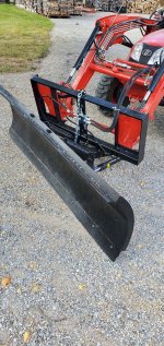

Finally got the snowplow all finished. It turned out really nice, but over budget naturally.

I had earlier estimated $600. Then i decided to add the crossover relief valve. I've got approximately $600 in it at this point, but still need to pay my dad for the plow itself and use of his welder.
PreacherM,
Nice looking finished snow plow adaption. Interesting how each you, PreacherM and Gordon Gould, each produced essentially the same outcome but by different designs.
