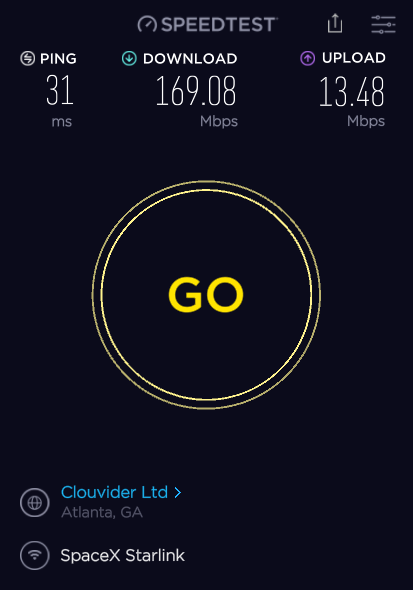

I think this may be the highest that I have seen with my "best effort".
/ Starlink #3,606
Received our Residential? kit and we have been getting between 130-168 on the download when run on a 5G phone.
It drops into the 30-40s when run back to back on my old laptop.
So I guess wlan in my laptop is old and slow and just limits speeds.
How old of laptop? Is laptop connected via wifi or ethernet? Wifi standards could have been less capable if it is quite old.
It is at least 11 years old low end 15" HP
yes just wireless connection
I should replace this thing.
The phone is one of the more recent 5G models Pixel 5a
Makes sense. The good news is that even 35Mb/s will allow you to do pretty much anything you need, so it isn't like the laptop is useless.
