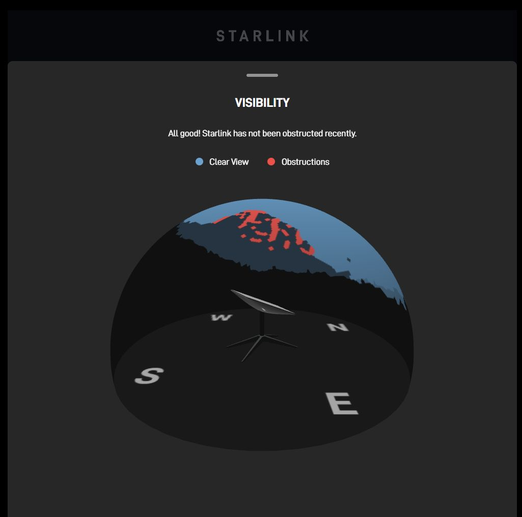

fyi I know SL at my property is partially obstructed by a large cedar tree. Surprisingly, even with obstruction, SL reports no problem with communication.

When my SL was reporting minor obstructions I had many short drops of service and or degraded speed.
Of course mine has never been the great numbers you always hear about today it's 174 Mbps down and 27 Mbps up,
often it is 60-80 down and 10-18 up, which is still much better then any of my other options.
I relocated mine about 10 ft further North and have no obstructions now the app was very close to what I actually saw.
