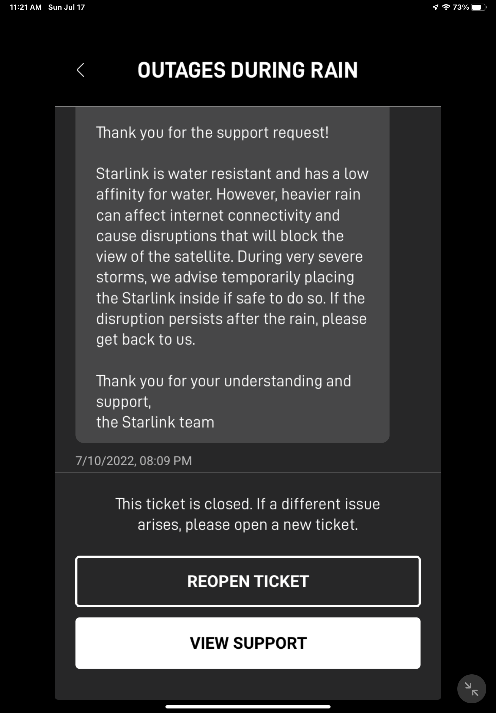

I sent an email to StarLink concerning my consistent outages during even modest rain showers. Here is their reply received about 5 days later. Still beats the DSL alternative. I hope the outages will decrease as more birds go up. I am on the very fringe of the Availability area.

@JethroB Can you clarify what you mean by being "on the very fringe of the Availability area."?

A few months ago I remember seeing a coverage map that I ‘thought’ showed all cells with active ‘live’ coverage, not just availability or waitlist. That map showed me being south of a active/covered/live cell by 10-12 miles. If true then maybe that’s why I lose service during even modest rain showers. Just guessing.

Thanks for clarifying. That alone would explain your coverage issues, though in the past Starlink wouldn't ship equipment to areas not yet "live". I don't understand the pattern to cells not yet "live", but they seem to exist. Does Starlink know that your antenna is where it is?
I asked originally because it should take a lot more than modest rain to cause interference at the 12GHz band Starlink is using.
I hope that your service improves.

Yes they know my location. See my post 2696 above for Starlinks reply to my rain issue.
