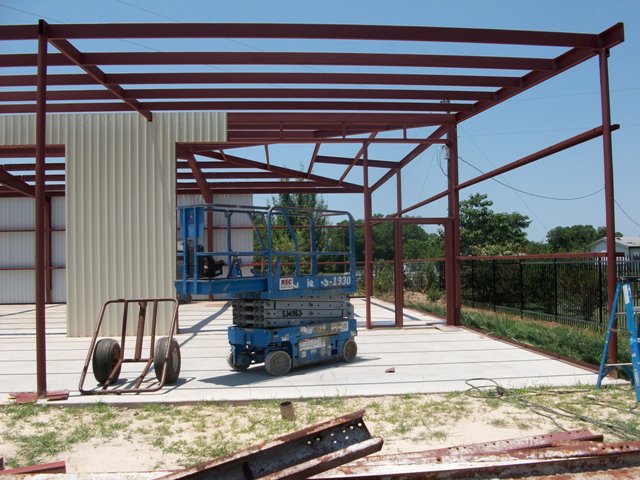

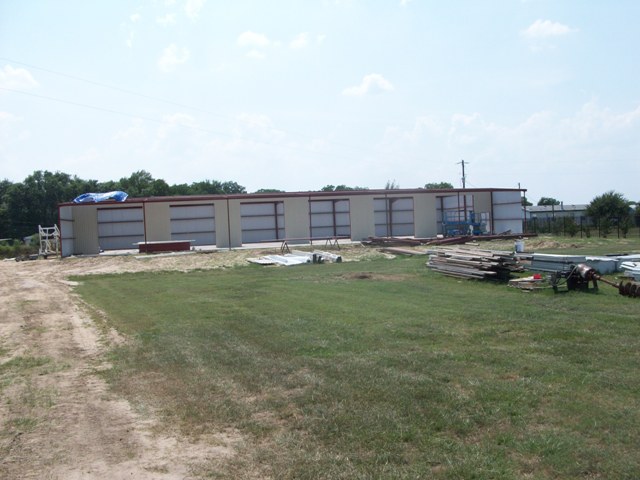

This week was a tad toasty in North Texas. There's a freezer in one of the barns. I've been putting six packs of water in it to freeze over night. Then we set them in the shade at the barn to defreeze. Gives us cold water and when we're down to a chunk of ice in the bottle we fill it with a sport drink and that isn't bad either.
I was given two helpers. One was good help and the other one I gave back within an hour.
It's funny about work. Either you have it in you, or you don't. He's only eighteen but he works good.

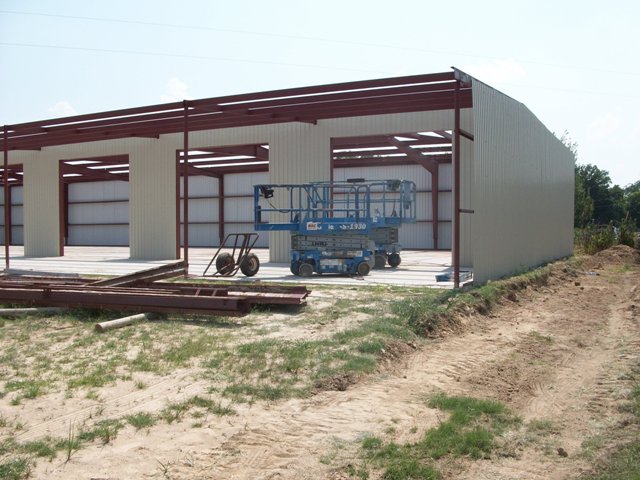

Here's some shots I took quitting time yesterday.

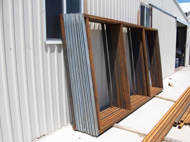

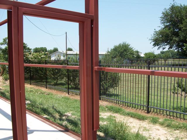

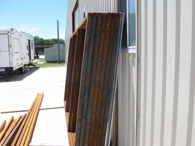

This barn is to hold equipment and whatever. So one of the challenges was to have as many doors as possible.
What I came up with was six twelve by twelve foot openings with double sliding doors. Sliding doors cost a lot less than roll ups. They're a lot more trouble free and easier to work on when there is a problem. And they take up less space.
Twelve doors seventy five inches wide and a hundred and forty six inches tall.
I put barn door track on the bottoms of the doors. This keeps the doors aligned and not touching as they slide by each other. That's because there will be steel pins inserted in the concrete for the track. The ends of the bottom barn door track will be closed off with a bolt or pin. This limits the travel of the door side to side and also prevents pulling the door out from the bottom to get access.

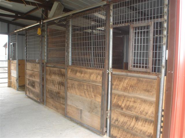

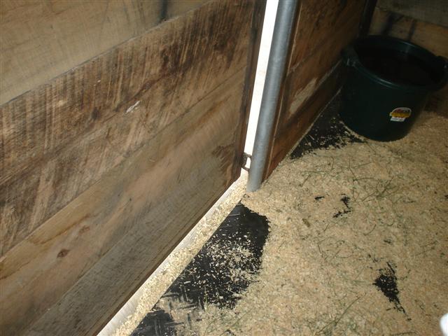

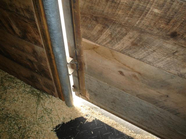

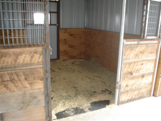

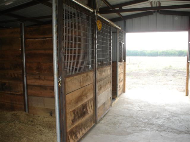

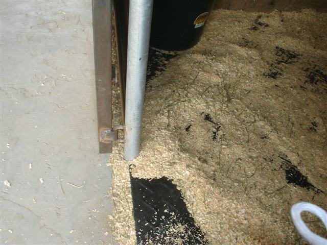

The principles are the same that we have with horse stall doors. We don't want anything in the way of the doorway. And we sure as heck don't want anything used to secure the door providing a hazard to anything else, horse stalls especially.
These horse stall doors are secured where they can't move by out of the way catches when the door is fully open or closed. There is nothing protruding or sticking up to frog a horse or provide a tripping hazard to the help or owner.

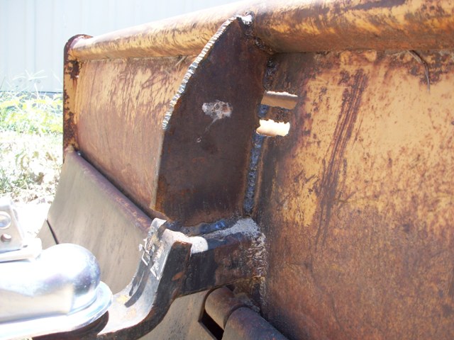

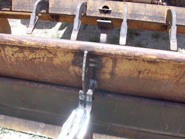

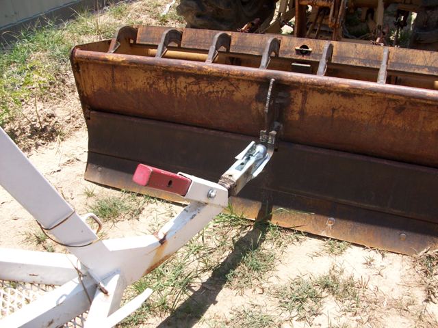

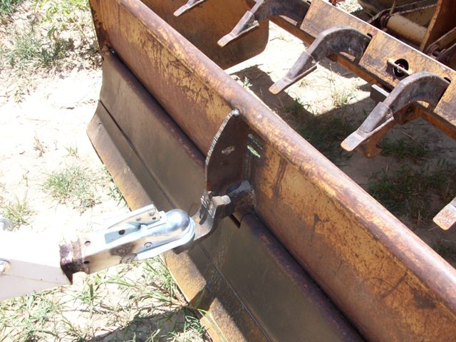

One of the bargains the client found was a manlift. It's trailer mounted and lifts twelve feet. It's one of those things where the fabricator was a much better designer than a weldor and that's okay. Welds can be fixed.
I wasn't about to set it up with the jack stands in place etc and so on every six feet or so on uneven ground so I could install the upper two lines of screws on the fourteen foot sidewalls. After I replaced the coupler and ignored the bent tongue I modified the box blade on the old Ford 340.
A couple of tries to hook up a trailer blind encouraged me to modify the box blade some more. It's now where you can back up to a trailer and see the coupler and ball well enough to not need help lining things up.
