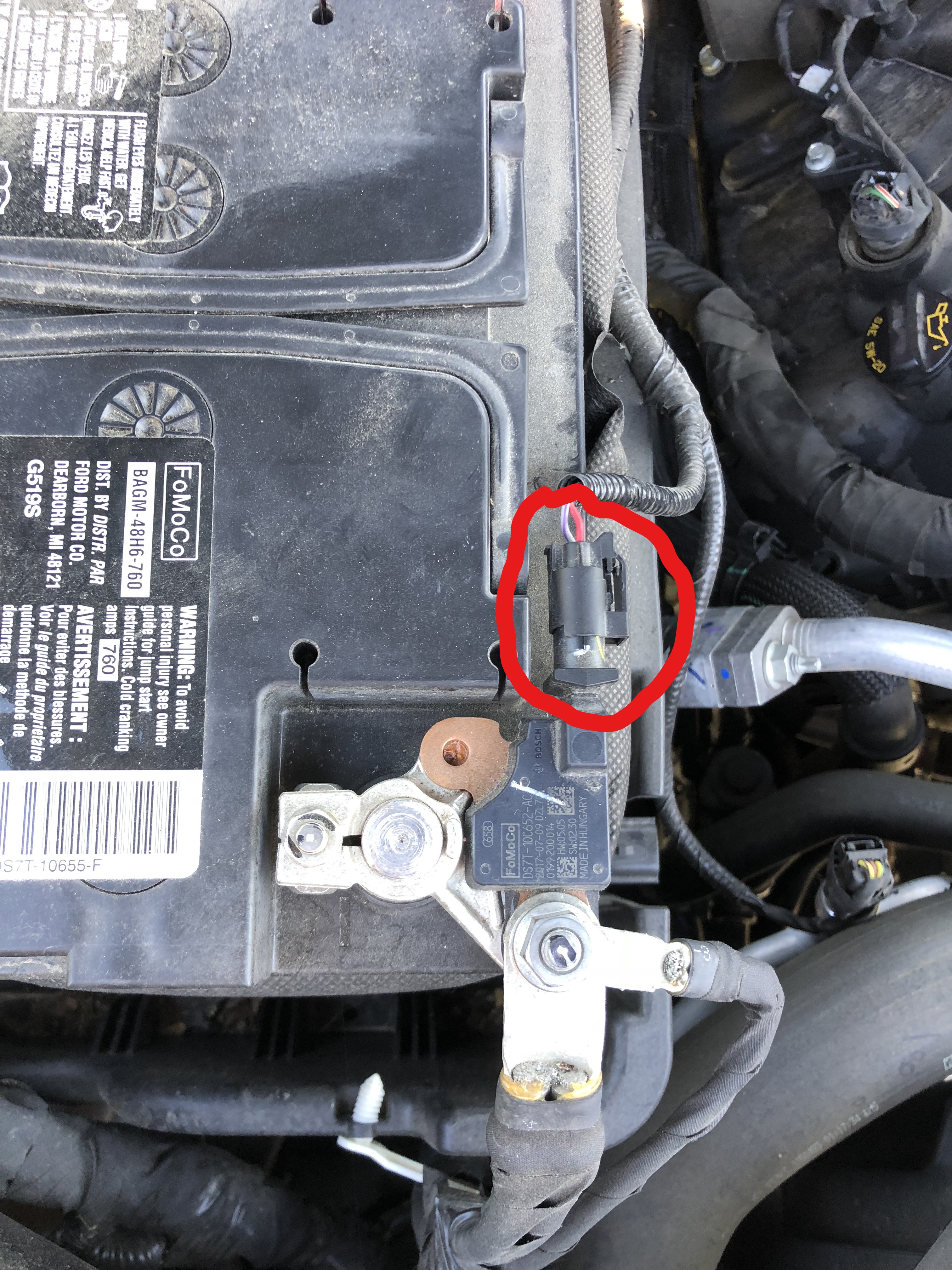

I tried to live with the start/stop on my '18 F150. I finally decided it had to go. I found a way to permantly disable it by unplugging the current sensor on the battery. The current sensor tells the Battery Management System if the battery has enough strength to restart the truck after auto-stop. I have been running it for about 8 months now with no adverse effects. There may be a similar sensor on your car.

The computer uses this sensor to tell the alternator how much to charge the battery. You probably shouldn't be disconnecting it.

Maybe I should not have but I did and also a friend's truck and 4 company trucks including the owner's personal F150. We have not seen any problems with any of them so far. The only visible change is they don't auto-stop any more. I don't mind them including this feature in the truck. They should provide a way for the customer to permanently disable it if desired.

Most alternators have an internal regulator that sense the system voltage by the wire at the alternator. I have to believe that this second sensor is more to measure the voltage fluctuations and health of the battery. If draw on the battery like A/C, lights, trailer brakes, accessories, are taxing it too much, then it will read it and limit S/S.
