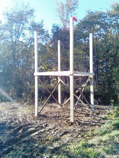

Well, I finally had a chance to start the tower stand today. The poles have been sitting there for a week but between rain, a major wind storm that tore our service off the house and more rain I had not had a chance to drill any holes. So today I set the 4- 18' 4x6's by myself and set the joist skirt boards myself as well before my dad finally was able to come help me. So he helped set the 5 inside 2x6 joists then took off as all I was going to do was set the bottom cross bracing then call it a day.
The floor is 7.5' off the ground and the blind will have an inside height of 7' 2". They are calling for high winds tomorrow so I doubt I will get to work on it again but hopefully it will hold off as I want to start framing up the walls after I find what windows I want to use.
I am leaving one side of the bottom open to park the atv under the blind. Eventually I will close it in and will set up a simple door so I can hide the ATV as well.

Can I come hunt in it when your done? I don't want to help build it, but am willing to help where it out when you get it built...
Just kidding, but that is pretty much the attitude we got when we built the last stand like that, from a neighbor who didn't own a big enough piece of property to hunt on. He came over and talked for an hour, holding us up, but when we suggested he grab a piece of lumber and hand it up, he suddenly "had to go". He didn't come back till we were cleaning up, and asked if he could hunt out of it when we weren't using it. I suggested to the guys that DID HELP, that we padlock the door, so a lock was added.
David from jax
Nice start, hope for soft winds till your done.

If your up this way your always welcome to stop in and hunt. I went to look for windows tonight but didn't find what I wanted so tomorrow I am going to Mr 2nds and see what they have. I did get a nice exterior door at the Home Depot for $99. No window but I don't need a window in it, just a six panel steel entry door and it is drilled for a dead bolt already so I can really lock it up tight during the non hunting months and protect all my valuable items in it :rolleyes::D

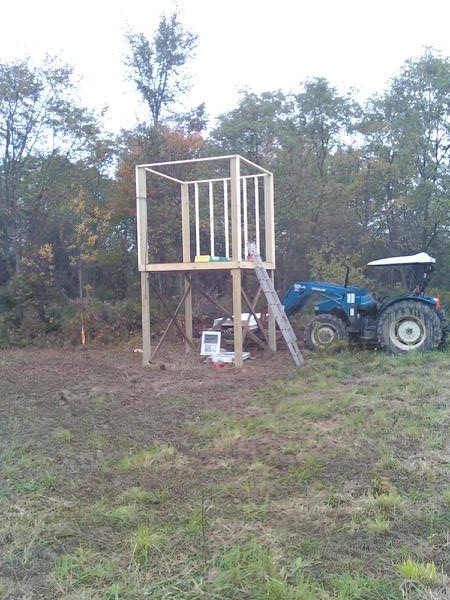

started on the walls today as I located 3 windows. I still need to get a window for the wall facing the field:rolleyes:

You'll have to put a little potbelly stove in there with some running water a couch TV bar.......... :D
   / Started my tower stand today #9
That's one beefy looking blind,also high enough so snakes won't visit ;)..looking forward to pictures of wildlife from mini camp.
It is going to have a small propane heater in there. I have a recliner I can take out there too and will have a shelf at 3' high all around it to set my laptop if I decide to really stay out there for a while. All I need to do is figure out if I can tether my laptop to my phone for internet access without costing me a fortune. If not I can watch movies in between watching for critters:D
Ever since I got hurt I no longer enjoy being uncomfortable. Sitting on hard buckets or trees and freezing are not fun and I can't sit that way anymore because of my back so I want to set this stand up nice and eventually I will build a couple more in other sections of this property and maybe a couple more at our other pieces of land as time and money permits.
I may look into solar collectors for this stand though so I can have a simple power source if I take my daughter out so she can watch DVD's while we wait for something to show itself.

I am over building it by a large margin because this will catch a lot of wind. I don't want to build it light and have the winds push it around.
