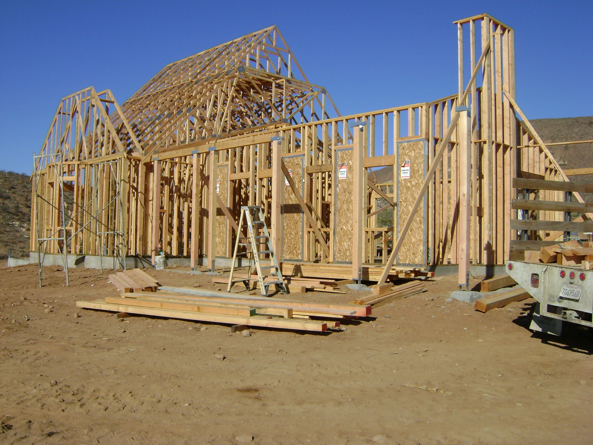

Electrician was there today and will be done on Monday. HVAC guys also on site today and will finish Monday. Plumbers are a no show, they did the vent lines and drilled all the holes in the studs but that was it.
I am ordering cabinets tomorrow and picking up my shower pan. Using Marblestone in both bathrooms on the walls around the tub and shower.
Here is another photo, not much has changed on the outside other than I primed the fascia last weekend.
Recieved all my solar except the batteries so I'll be putting that in the next few weeks.

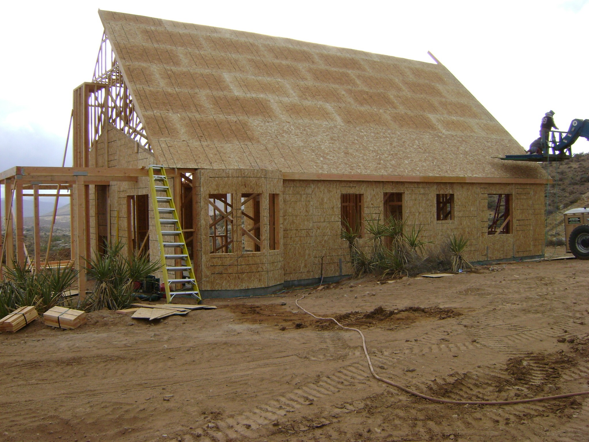

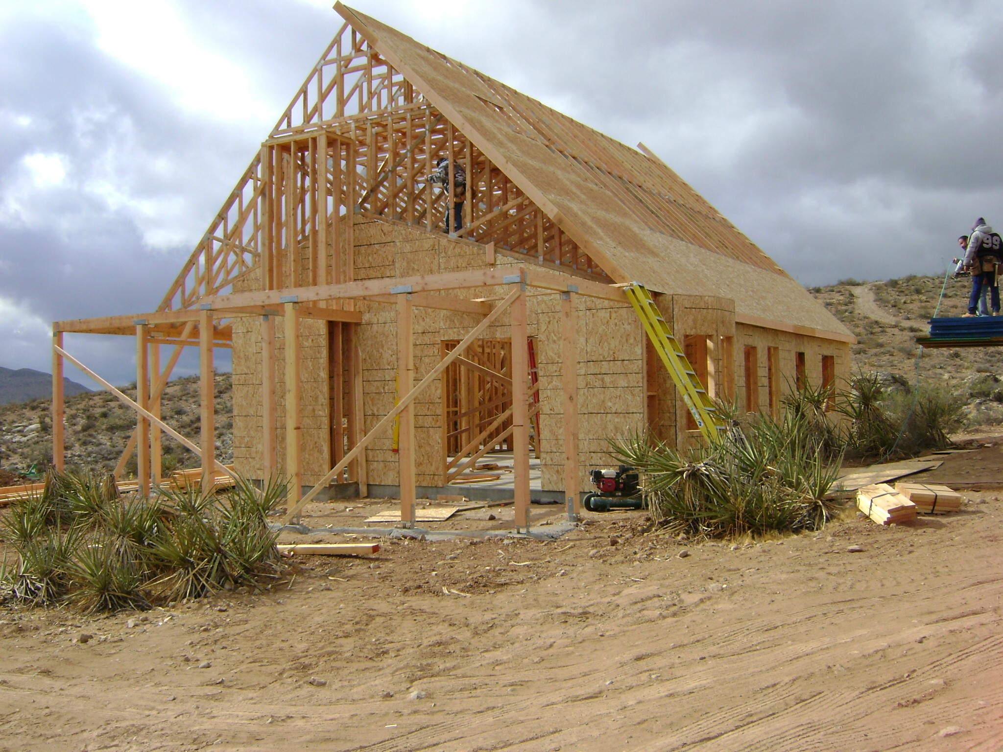

Well a lot has happened since my last post. Everything went pretty good until the roofer went out of business, this was a delay since nothing on the inside can be done until the roof is on. Meanwhile, the place is "weather tight" with tar paper and caulked penetrations, it survived the last storm pretty well.
They are putting the siding on tomorrow, did the window trim last week, had the rough plumbing and rough electrical done for weeks now, I had my "solar inspection" and go the ok to fill the 7 foot footing with concrete, and I put my 12 foot schedule 80 steel pole in place and plan on pouring the footing/ hole this coming weekend. I had the Propane guy come out and make me a 57 foot line, had some backhoe work done and just unrolled the propane line, done in about 5- min. then back filled.
So the plan now is roofing to start this weekend, roofing was ordered prior to the guy going out of business, the general is paying for it and we found another co. to do the metal roofing. Once the roof is on, they will start insulation and drywall.
Here are a few photos.
