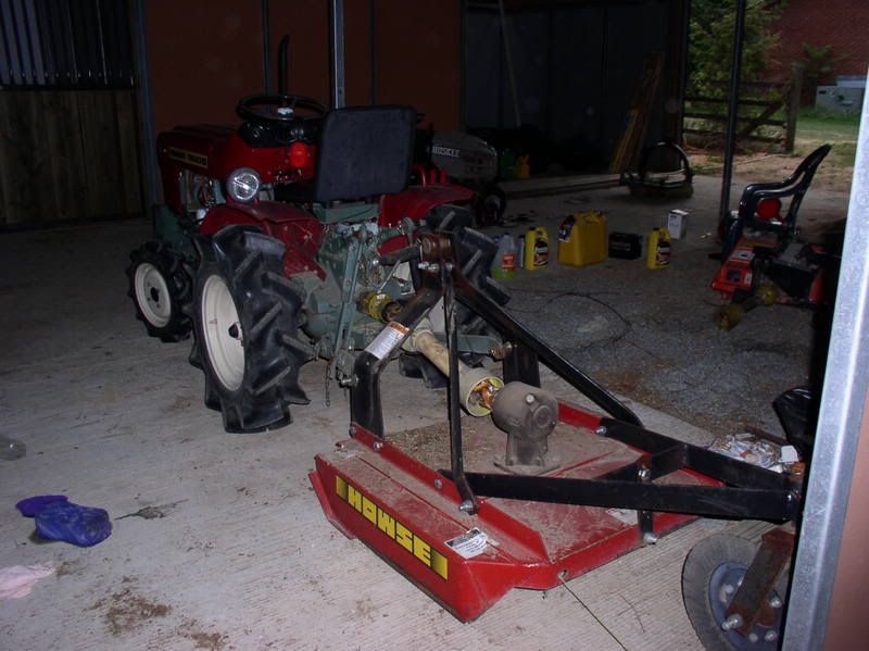

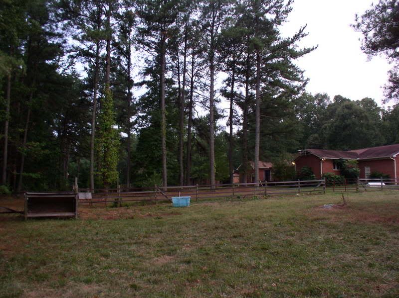

In keeping with my "tradition" of learning to use one implement per day, today was time for the bush hog. I had previously removed the bush hog when I was working on the tractor and so that I could drive it around easier. I had tried to put it on earlier, but the PTO shaft had pulled too far apart and I was having a hard time getting it on. A couple days ago I had managed to get it somewhat on the shaft, but it binded up and would go no further, and I could not pull it off by hand. So today, I wanted to try out the bush hog. I figured that I would have to first pull the shaft back apart because as far as I could tell it was NOT going to go on that way, even though it appears that as long as the 3 channels on the shaft line up it should slip on anyway. But apparently that was not the case. Very awkwardly I managed to get the shaft on the PTO on the tractor. After another starter grinding adventure I got it started just fine. Started out in first gear low range and drove forward. Shaft didn't want to come apart and it drug the bush hog a little bit. Then I put it in first gear high range and got a little more aggressive on the clutch and it pulled right off. Then I tried putting the shaft back together by trying each channel on one half in each channel on the other half. Apparently it worked because I must have lined it up right because it slid on there perfectly. After a little bit of trouble hooking the bush hog up, I got it all hooked up and drove out to the area where the horses get ridden (thankfully not by me, I am not too fond on getting on one of those animals, though I really enjoy having them around) and decided to clean that area up so that the whole area could be ridden in instead of just the small path that I cut with the riding mower before I bought the tractor at a PAINFULLY slow pace.
Anyway, I got right to work. Had a little trouble deciding whether to use low range 3rd gear or high range first gear. After a few "laps" in LR 3rd, I noticed that the little 3cyl diesel was chugging along happily without bogging the least, so I tried out HR 1st and it worked great. I didn't want to go any faster in the riding area faster because the grass was pretty tall (well, by my standards, not unlike some of you guys who mow stuff and the only thing you can see is the front of your tractors hood) and I didn't know what was under there. Thankfully I could see pretty well and the most solid object I hit was some extremely dry piece of wood that chipped off a log that made a nice little CRACK as it was blown into 10000 pieces by the bush hog blades.
The thing that is going to take some getting used to for me is how the bush hog swings in the turns, unlike how the mower on the riding mower follows in the middle. Took a little getting used to. The bush hog is a tiny bit wider than the rear tires, I think it is a great fit for the tractor. Otherwise I had no problems except for what you will see in the following picture, where the bush hog would drag on the ground in some areas (mainly when turning) and would tear it up pretty good. I wasn't sure how to adjust the lift just right, I'm sure that some manual adjustment on the lift is what I need, so maybe one of you guys can help me out. If I had the lift up too far, the wheel on the bush hog would come off the ground quite a bit, and if it was too low I would start dragging the front on the ground. Do I need to let the top center arm on the lift extend some more so that the bush hog sits a little differently?
On to the rest of the pictures, sorry I got a little "trigger happy" with the camera today.

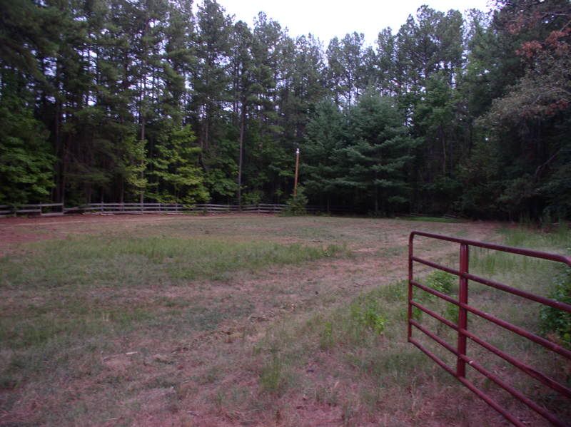

Didn't mow the whole area, just the main part. Will finish it up when I have time, it was getting a little dark and I was worn out so I decided that it was in my (and safety's) best interest to call it a day.
This area will most likely still be mowed with the riding mower. You can see my "sandbox" by the deck.

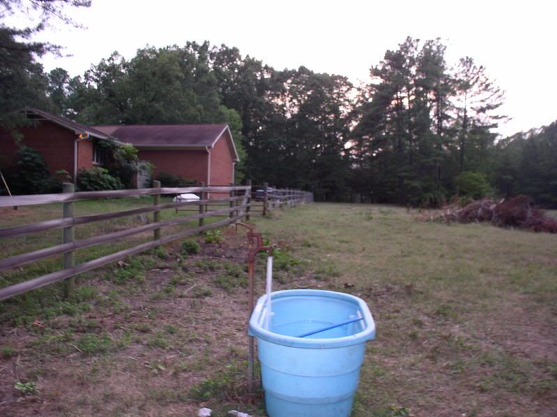

The following pictures are from the pasture where the horses graze the majority of the day. Since it has been so dry lately and the horses chomp chomp chomp all day long I really don't think I need to mow much of this right now.
And finally, just one last picture. Thought it was kind of pretty.

One thing I found extremely helpful with hooking up 3pt implements is to get a set of Pat's easy change. I would have to bang, kick and make about 10 trips to the tractor to get it hooked up. With the Pat's I can disconnect and re-connect to a different implement in about 3 minutes. Oh and congrats on the new toy (I mean tool).

There are good suggestions above. My technique for putting on implements is to back up close and just move the implement around with a digging bar (sometimes called a spud bar). The bar is so useful that I keep it on the tractor.

You will also soon be hooking up the RC quickly. When I am trying to get big implements on tractors that I can't possibly push around I try to back up completely sqare to the implent and then bring the lower link down to rest on the pins. Then, get out of the tractor and use the link extensions to get the pins on. Then I put the PTO shaft on and finaly the top link.

I used Grrr's method for many years. loosen the rear links, raise them, back-up to the implement, lower the links and try to get them to fall down onto the pins. if they are loose enough, you can then dismount, and wrestle the last inch or two.
