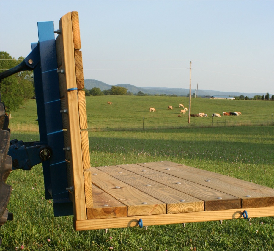

Not sure if this will help or not, but here's what I did to my carry all. I used pressure treated lumber to create the deck, used a 2X4 to shore up the edges on the deck and the back, then put eye bolts in the 2X4 for that exact purpose - useing tie down straps on stuff.
