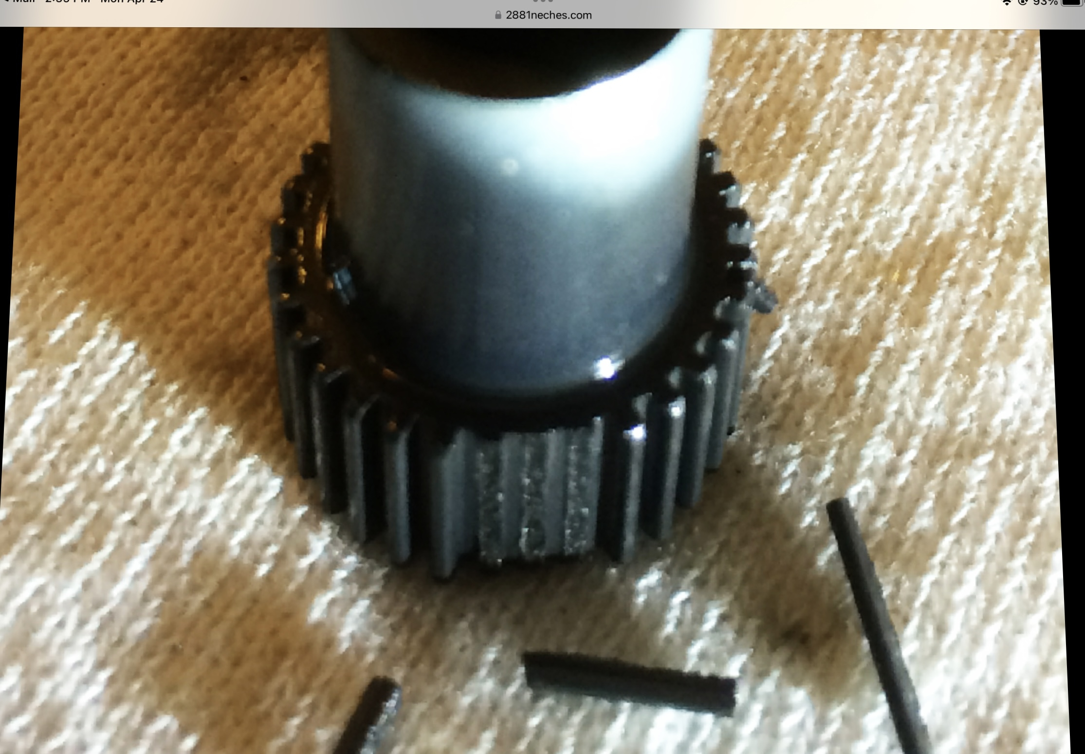

IP is not available anymore. But gears are.
I have a very experienced mobile heavy equipment guy coming hopefully tomorrow to give me a hand ( or should I say give him a hand ) 6EC7FD60-2B5B-4E69-A7C2-D589F8EAF8F3.jpeg
This is what I’m dealing with!

Well the glow plugs are getting power 9 + volts. I’m going to call a couple of dealers tomorrow, I’ve had the best luck with a Kioti dealer in Washington about an hour away

Are the glow plugs drawing current? Voltage at the glow plug can be present with the plugs not working because they are open circuited.

My diesel guy couldn’t make it yesterday, he will be here tomorrow, will post when I found out what the hell is wrong! It’s looking more like the IP ( broken gear teeth) does anyone know where to get new gears? The injector pump is not available from Kioti anymore.😬
