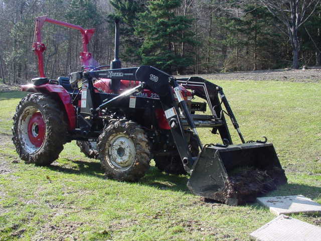

It's the price of a medium sized Quad but does 10X the work. I bought a Noma 10 HP snowblower 2 years ago and it rusted up so tight I had to sawzall the axle and put all new bearings and stuff in it. For the price the Jinma is a great machine and should last for years to come. Just my opinion.
